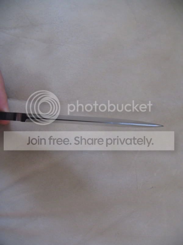

I've finished filing in the bevels (at least all that I can handle) and have started to sand in preparation for heat treat, etc. The problem I have is that as I sand, the edge is getting thinner and thinner, but not uniformly. I think the relative thickness along the length of the edge hasn't changed, and that it's thinning everywhere...but I'm not 100% certain about that.
I really thought the sanding would take care of any unevenness but it's not happening yet and the blade is getting quite thin in the center, while it's thicker near the plunge and tip. Should I be overly concerned about this, or can I expect to be able to sharpen it out? If so, what can I do about it? Again, sanding it doesn't seem to be taking care of it at the moment, and it's really getting thinner than I think it should be in the belly area.
You are not going to sharpen that out. You are spending too much time working the center. You may need to go back to a file and even things out. This is why I like working with files. You can watch what is happening and keep the edge even. Can be done with a grinder too but I like the control I have with the file.
Sanding it and sanding it evenly with hindsight are not the same thing, you might be able to even things out by some draw fieling, with some care to work on the thicker parts. Cheers Ron.
I'm using a block of wood behind the sandpaper that is as long as the blade, so I'm confused as to why it wouldn't bring the high spots down and leave the middle where it's thinner alone???
Thanks for the input, guys. I must have over 50 hours into this thing already and I think it's starting to win...

I spent a couple of hours this morning draw filing that area out just behind the tip, and it's better now. It's still a bit thicker there, but actually now thinner than a dime which is what I've read to be the recommended thickness prior to heat treat. (Besides, if I go any further I might just throw it against the wall and never finish it!) The belly is significantly thinner than a dime, and I'm wondering if that is going to be ok to HT??
I'll get a new pic and maybe a measurement later up later. Thanks again!
To clarify, I am clamping the blade to a board but of course the bevels and tip do not sit flush, so there is some springboard effect. The jig I saw, as I remember it, used threaded rod that was screwed up against the blade. This compensated for the bevels and tip being thinner and supported it fully.

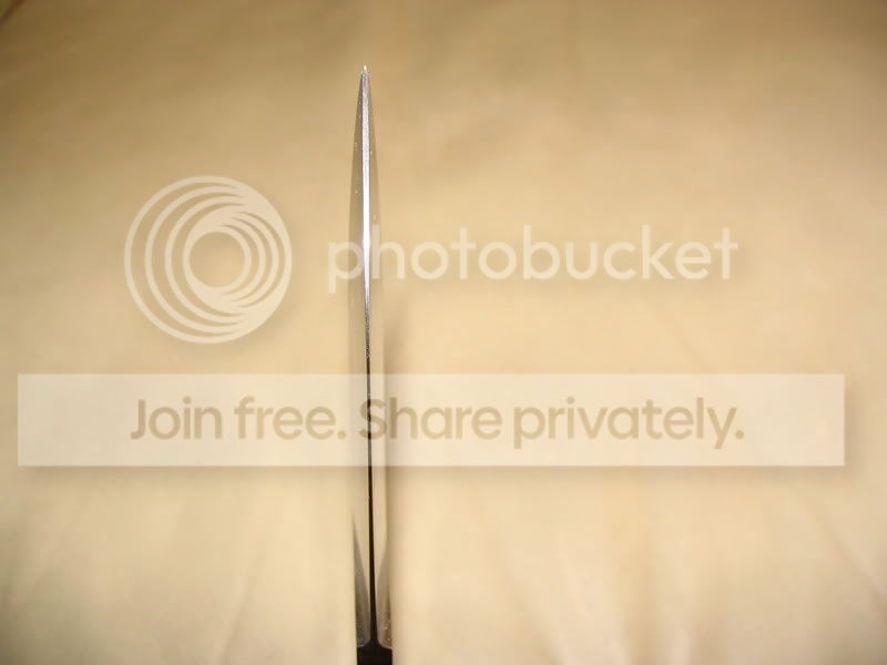

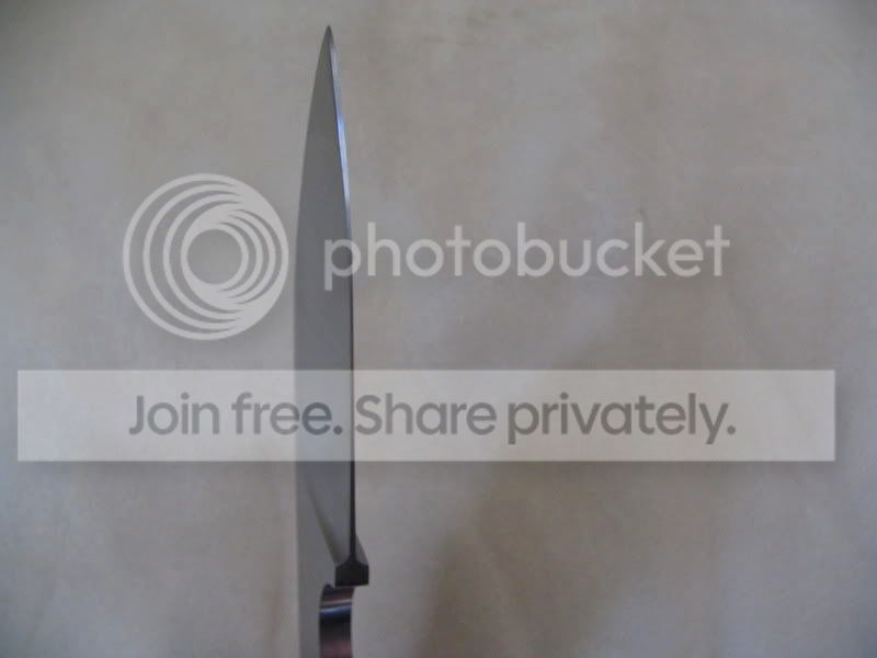

I'll have a new progress pic up in a moment...
Huh, after about 4 hours of work it sure seemed better in the hand, but now after looking on the screen I'm not sure how much of an improvement there really is. Anyway, I think that's about as good as it is going to get at the moment because I'm sick of looking at.
It is pretty thin there in the middle (this is 1/4" 5160), will this likely be a problem during heat treat?

Thanks again to everyone for their input. I just got out my dial calipers, and I'm at about .025 at the belly, about .035 out at the tip, and about the same near the plunge. I'm still concerned about the unevenness but also about the thickness everywhere now.
Would it be best to:
-leave it as is and heat treat and finish it? If so, what will the impact be on the finished blade?
-keep working it down trying to get it more even everywhere?
-worry more about working down the tip only (or plunge only)?
-try to file the edge a bit, hopefully without substantially changing the overall blade shape, back into thicker material?
-something else???
