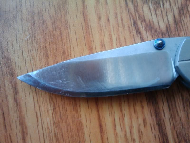

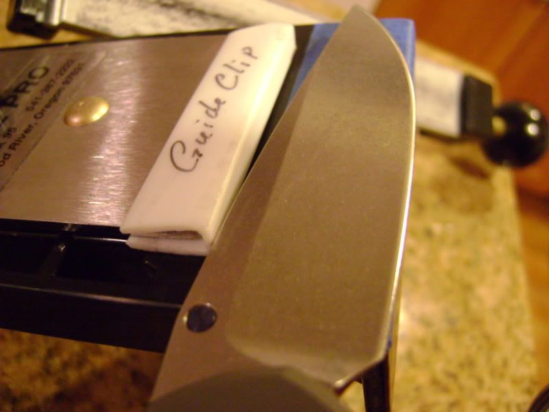

Can anyone post pictures of their Sebenzas with Edge Pro Edges and what settings you guys used?
The Small Regular in the picture was done at the red setting (15) and I put it flat against the edge. You could say that the spine was raised a bit.
I forget what i set this as, I think 20 degrees. Then I stropped to a mirror finish.

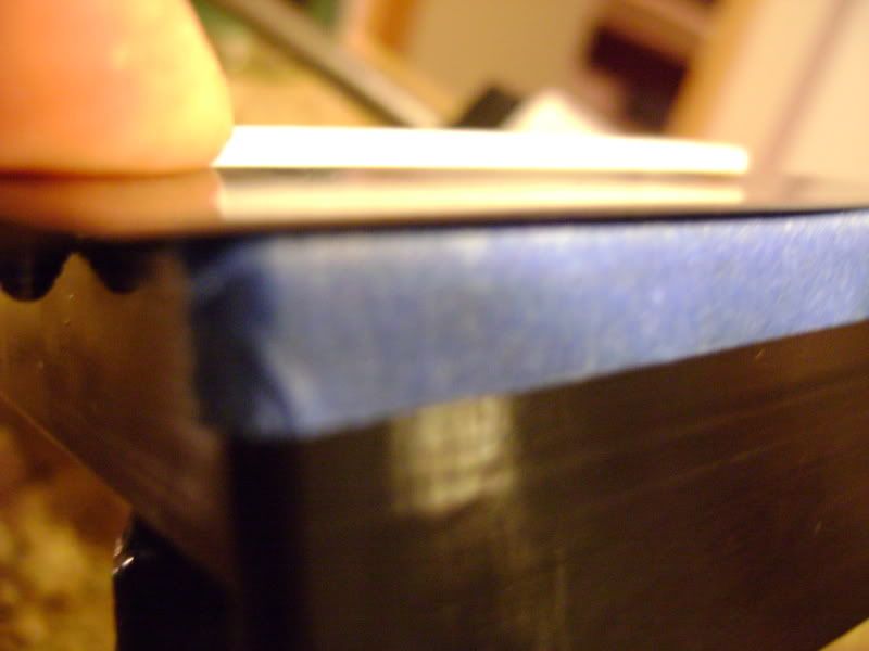

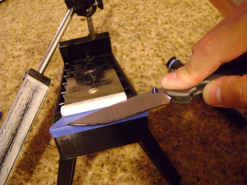

I'm guessing you set it a the 21 setting? I think its the yellow mark? How did you set the knife flat on the surface? I had problems with the knife wobbling around...
BTW that edge looks great! !!!:thumbup:
How did you use duct tape? Could you please describe your process a bit more or maybe take a few pics? I would love to put your edge on my 21...

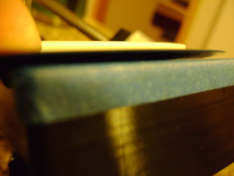

As of right now I am having my benza sit on the "flat of the spine."
However, when I do that, the actual edge is sitting above the table.
Thus, I must actually set the edge on the table, but this raises the spine from being flat with the guide, and now it wobbles around.

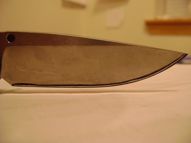

In this picture, it is set at the 21 setting or the yellow mark. We can see that it is not even close to hitting the edge. So I can either keep it at the current setting and remove more additional metal, or go to the 24 setting and remove less metal....however at that setting I don't think I'll beable to actually maintain the edge on my sharpmaker (30/40) settings.
My main concern is I don't want to remove too much metal from the tip as my previous sebenza.

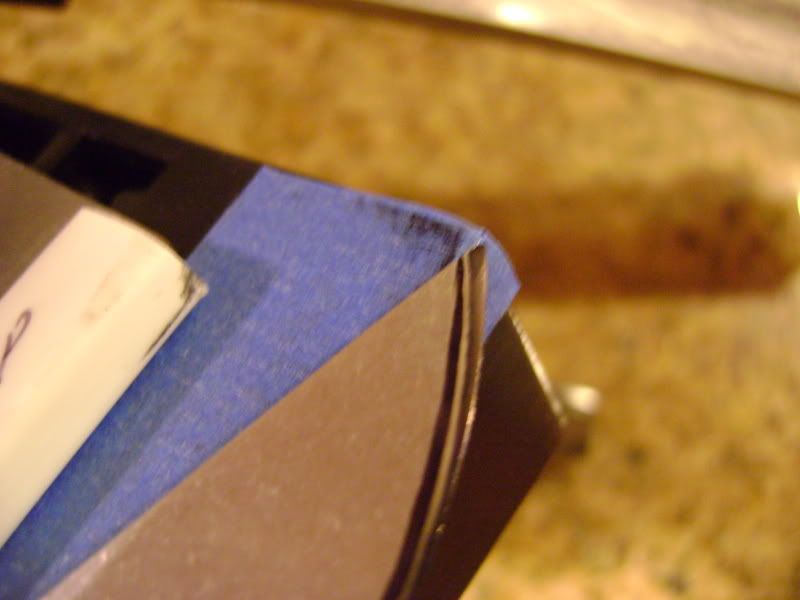

This picture currently shows where the EP is hitting the tip at the 21 setting...
My other concern is how do you approach the other end of the knife where there isnt the thumb stud as a guide? I have even more trouble trying to keep this thing from wobbling.

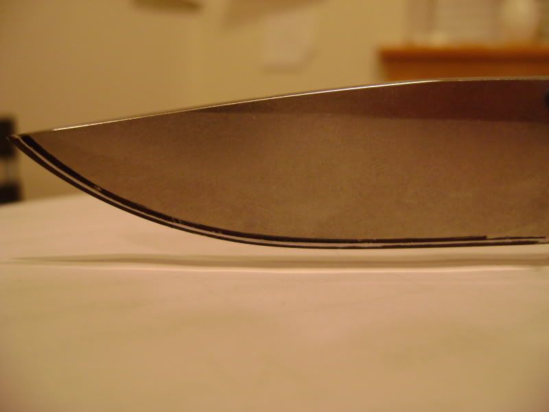

Initial testing results of the 21 setting (Used the polishing tapes to show where the EP is hitting).
As I mentioned, I'm mainly concerned with the tip as I do not want to remove too much metal. I think the marker indicates that too much metal will be removed from the tip at the 21 setting(Not as extreme as my first sebenza)...any advice?
