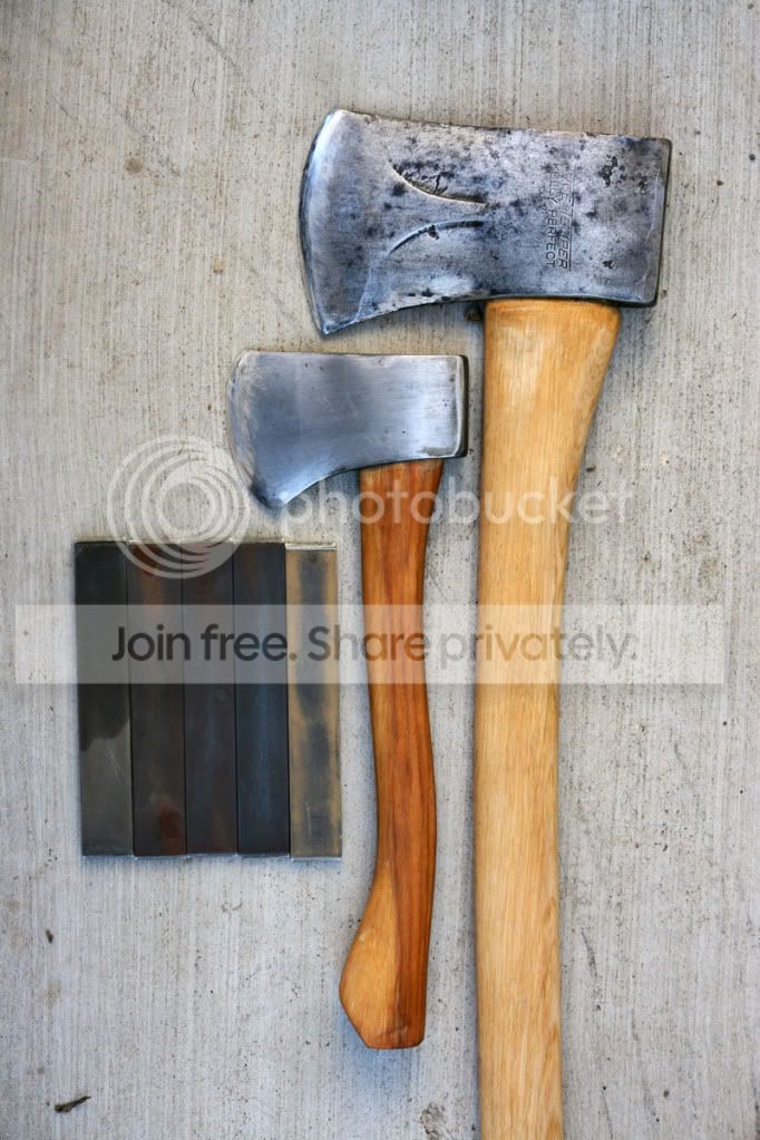

I just sharpened 2 axes I was going to use with these. initially I wanted to use the table to get a solid consistent edge, but these are obviously way to be for the little apex model's table. so instead I used them like I use a file to get a very nice convex edge, up to a consistent polish.
you can mark the edge off with permanent marker and work your way from acute to obtuse until you know your right at the edge, rather then the standard stone method where the edge being sharpened is covered and on the underside. I've never been able to freehand stone sharpen before, but I'm pretty good and consistent with a file, so using these in that manner is like bliss after many hours of frustration trying a standard stone method before.
I like the diafold sharpeners from dmt, but these are way better for full sharpening tasks, as they last until the stone is gone. it also helps that most of the stones wear down in the middle when used with the table, and this type of sharpening is only at the edges of the stone, which helps keep it even.
Even if my table broke or I had never bought it, I would keep buying these stones to use in this way.
The axe in the picture, the kelly true temper, is the hardest axe I've ever handled. only my brand new out of package files will touch it, and those tend to ring out unless you go very slow, and very carefully. It seems like the rc has to be at least 62, maybe a few points higher.

I think the technical word is called "skating", where the file is unable to pull a chip off the metal and the teeth just bounce, or skate over it. I tend to say "ring" because it makes a ringing bell sound when it does it, rather then a grating sound. I should probably stop calling it that...
the stones in the picture are from left to right - 180, 220, 320, 600, 3000

to be honest I've never been shown or taught how to sharpen an axe, so I wouldn't know correct from incorrect. I'd put a straight edge on these with the apex if I could, but since I can't I go with semi-convex because that's how my filing comes out. straight at the actual edge, then I bring the file to a more acute angle to thin out the shoulder.
this stone use/experiment came from me being tired of people posting hair whittling sharp edges and mine being gritty at best. just trying to improve the edge on various edged tools.
