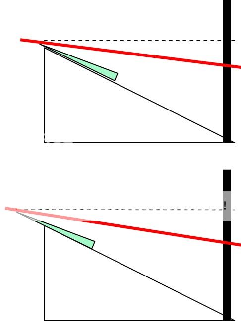

Recently been on a YouTube kick, saw a few EdgePro how to things and notice some guys do things one way, while another guy does it this way, but what I did notice was the relationship doesn't seem consistent, talking about the distance the edge is from the end of the table.
Now it seems obvious to me that when you go to set the angle of the sharpening stone, the designer had those coloured spots as indicators of what the angle you will be putting on the edge, BUT I think that WHERE the edge is also makes a big difference as to the angle you end up with.
If you have the blade sticking out a 1/2" away from the end of the table, you will end up with a more shallow bevel, does that make sense to you guys/gals of the sharp world of EdgePro?
I just checked the booklet that comes with the kit and that also seems misleading, basically saying have it overhanging, on page 6 it shows a chef's knife with a lot of overhang, to my eyes at least.
What I do it to have it overhang the table just a slight amount, just so you are not abrading the table by accident as you go out to the tip of the blade. In this way, I think you will be closer to what those coloured dots are indicating.

Here's a quick sketch in powerpoint to show the angle changes when you bring the edge far away from the end of the table...
Top is set to the edge of the knife is just overhanging the end of the table, the bottom shows moving the edge of the knife further out, it requires the stones to strike at a different shallower angle.
a closeup of the contact would show it better but I wanted to show the whole setup there.
Your geometry is correct, the angles will be dfiferent. A simple plastic protractor will solve the angle question easily though.
Thanks and yes that certainly would help
My point and worry is that some folks will just set the blade any where and use the colored dots as exact angles, but they'd be off and will have a wrong angle set and maybe too thin/weak bevels

I love the Edge Pro, wouldn't be without it. But I've sharpened enough different kinds of knives on it to know that the videos and manual leave much to be desired. You are correct that the edge's distance to the end of the table has a significant effect on the angle. There are some other factors at work as well. If you use the techniques from instructional videos to sharpen a blade with a lot of belly, you might be unpleasantly surprised by your result.

First, generally you should put your knife edge as close to the platform's edge in the Edge Pro as you can. This gives maximal support to the knife to hold it rigidly, plus increases consistency of your angle if you always do this.

Thanks Lagrangian, sorry didn't see your reply until today, I generally do try to keep the edge of the blade near the edge of the platform, but, I think I keep it a bit too close as I end up catching the platform edge sometimes, so I've changed slightly to move the edge out just a tad away, so as to be sure not to bang into the plastic platform.
