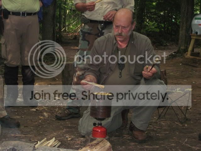

On a pine tree you can ussualy find a big mess of sap bubbled up in an area where the tree was wounded. Knock that off and boil it in water, you can also add crushed charcoal to the mix and stir. The resin will stay on top. You then can dip your finger in there to collect the resin, I prefer to use a stick to collect it, but I'm a wuss.
What you are making is like a gluestick. When the sap hardends on the stick you can heat it up later and use it to fill voids or adhere things together.
Here's a pic of the man who taught me how to do it.

great stuff tony...marty is the man..:thumbup: i have always liked his neck knife set up too...
NORCALBLACKTAIL is an arborist, he had a whole mess of that pin sap, he had harvested....
