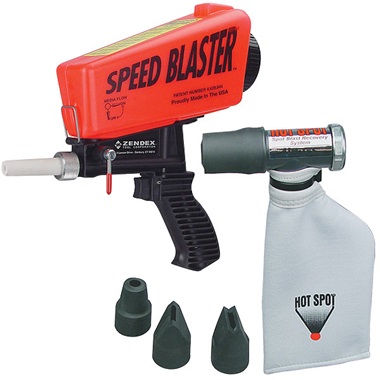

Hey Guys,
I am rebuilding a drill press and need a sandblaster to strip crud and paint off of it. Ultimately I will get a decent blast cabinet and use it for some knife making stuff as well.
I've never used a sandblaster but the concept is pretty straight forward. I've read up on some cheaper models carried by Harbor Freight and Home Depot and am satisfied one of them would do what I need it to. I think I have settled on the 110lb model HF carries.
I normally don't go for the cheapest when buying tools but I'm in a pinch with this one and don't want to spend a lot of money at the moment. I almost bought the thing tonight but the kid at HF was being lazy and didn't want to move some boxes and get one down for the back so I left. I did some more looking when I got home and saw Tractor Supply has a similar model for about the same price but also had several models that were nearly $2000. If I buy the one from HF or TS is there anything I am really going to regret or hate about it? Its only going to cost me about $100 so I'm not going to be too broken up about it if I need to replace it down the road.
Also is this serious overkill? For $20 less I could get one about half the size but I figured for $20 I might as well just go with the bigger capacity.
Thanks
-Clint

A "pressure pot" is a cylinder full of abrasive that can be pressurized at high pressure to force abrasive into a stream of lower pressure air that flows externally to the pot (super-simple diagram below).
The benefits over a siphon feed are more consistent abrasive flow, lower air consumption, ability to blast at low pressure, more overall control.
A drawback is not being able to blast non-stop for hours on end since the pot needs to be refilled at some point.
The system by Pirate looks similar to a system I used to sell at a much lower price (and mine was better as it had an air-operated foot pedal to control the flow). You could build one that works just as well as the Pirate for much less by sourcing the parts individually and selling.
You could get started with a simple pot from Harbor (or similar vendors) and then build upon it.
Do you have a cabinet? If not, you're not going to enjoy blasting AT ALL unless you wear a full protective suit suit and have a respirator system. For cabinet-free blasting that is safe, I'd recommend something super-simple like a spot blaster that catches the abrasive as you go. It does small areas at a time so it will take a bit longer, but it works effectively (I used mine once to blast a 36x48 piece of glass that wouldn't fit in my cabinet, and it's sat on my shelf since. It might get used again on a minibike my son and I are restoring).
They go for about $50 online and look like the picture below my "diagram".
