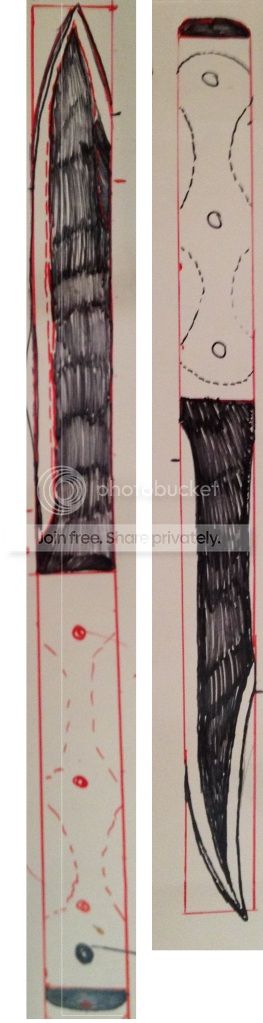

So far I have made a few EK stle model 1 (modified to stay within the law) in use in S.E.A. and a few are being HT`d right now, The marine raider(clip point) is a new design and I am a little unsure of it`s durability in rough use as a combat knife.
I have a Vintage Marine Raider that I used to make this template which I chose because it`s a little more Utilitarian and looks more like a kitchen knife.
I`m planning in using 4mm thick S30V on this one. 12.5 OAL, 5 handle, 7 blade. Chisel Convex. I`m shooting for RC of 57-58 on this. This is the most elegant tipped knife I am thinking to make. All stuff I make is being carried and used nothing sits around ( I have gifted all my knives to people who put their life on the line)
My question is the Marine Raider design too weak for use in the jungles of S.E.A? Same climate and terrain as North Korea and Vietnam. EK has since modified its design to the model 5 which is a really robust knife IMO. (yes, these inherently are more geared toward killing or trench knives than utility)
any thoughts are welcomed.
