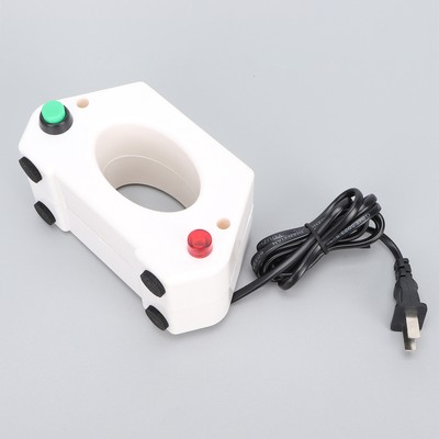

Hey guys. So I've got a vintage electric pass - through type demagnetizer but I did leave it on one time too long and it started smoking. That being said it still seems to work as I can feel the magnetic field like normal when I turn it on.
The problem is I'm still getting some very light residual magnetism in the blade... Like when I sharpen all the steel dust is attracted to the blade.
For others that have one, I was wondering if you have this issue with your demagnetizer? (regardless of what type - I'm trying to decide if I need a new one and which one to get)
It's still barely strong enough to pick up a detent ball
Here's a pick of my demagnetizer
I can't comment on the ring type ones like you have but I've been using a cheap Shars plate-type demagnetizer in my shop for years and I couldn't imagine not having one. It's not the most powerful model but it's largely been sufficient for my uses so far.
To demagnetize, while holding the blade in the center of the demagnetizer, turn it on and slowly draw the blade out of the demagnetizer till the blade tip is a few inches away from the demagnetizer, then turn it off. The blade should be demagnetized.
Nope, after a few seconds mine won’t pick up dust or shavings. My SGA turns my knives into pretty powerful magnets too.

Place the blade all the way through with the ricasso on the other side. Hold the ON button/switch down and slowly draw the blade back through the de-magnetizer until several inches away. Release the button/switch.
If you do what you are saying, it will magnetize the blade.

OK then there must be something wrong with mine and it's time for a "new" one! Thanks for confirming.

Yep that's exactly what I do... So once you demagnetize there should be zero residual correct?

Rapping the blade sharply will really get rid of the magnetism. I use a magnet to hold some of my tools.
It works. You can also hit the magnetized item with a small hammer, etc.

Striking a magnetized object sharply will jostle the electrons around (simplest way to say it). This will dissarange them from the order they were in when magnetized. It will lose most of the magnetism, but not all. It also takes a good hard blow. I wouldn't recommend it for a knife blade. It works fine for tools like screwdrivers and wrenches.
