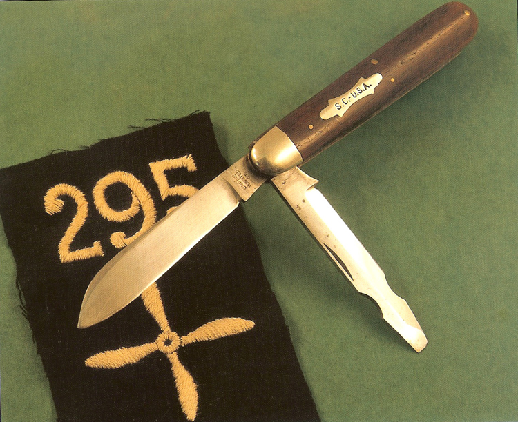

Waynorth,
Here is an example of the Empire early version military electrician knife. http://www.usmilitaryknives.com/Empire_SCUSA1.JPG
Yes, the two versions you show are the two also shown in the old Klein information. These are the earliest of the electrician patterns I have seen. They are pre TL-29 designation when it was just a Signal Corps knife or Electricians Knife in the military. Empire also made a two blade EZ opener pattern with SC USA in the shield. Much like shown in the display at the 4:00 o'clock position.

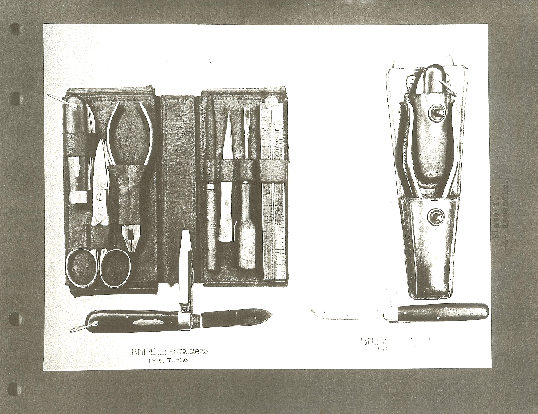

While we are at it here is a copy of a copy of the experimental TL-116 knife photo. This knife was made by Schrade for the Army test
on the larger sized electricians knives in 1929.
I left the photo large so you can see the blade markings.
http://www.usmilitaryknives.com/TL-116_kit.JPG
All the best
Frank Trzaska

Frank,
Great information here and super photo of the TL-116..:thumbup: :cool:
