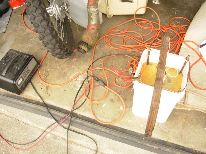

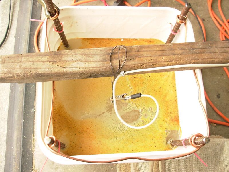

Where the magic happens
Neat setups.
First time I did it, wife warned me I'll get in trouble if I blow up anything :D. It does look like mad science "from outside looking in", as if Frankenstein's monster missing from the pictures. But it works beautifully.
You can see the bubbles it's producing and the rusty scum on the surface of the water/ washing soda mix in my pics.
I had the battery charger on the lowest setting and checked the results often. It worked well. sorry I don't have pics of the axe head I did.
It was much like mastermachetier second no name axe. Pretty rusty but no major divots. results were about the same. Cheap and easy to make.
