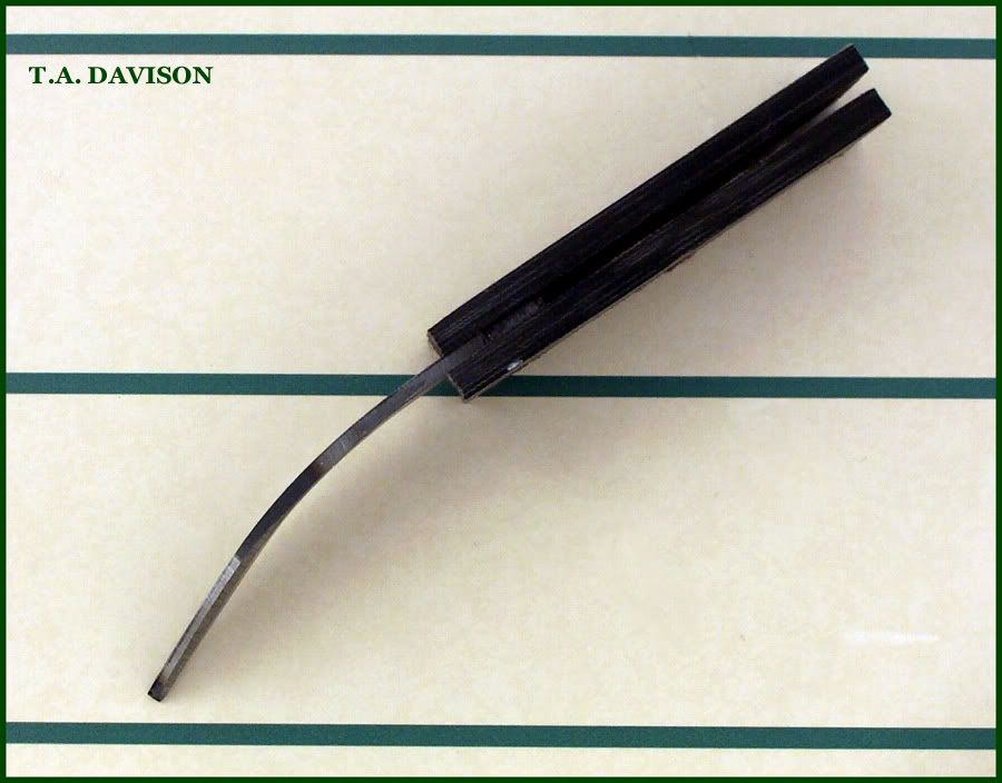

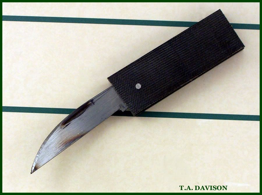

Here is a couple photos of a test piece I did.
I just pinned these slabs of micarta together - NO counter sink - NO washers.
And put it in the vice bent it over, it did not come apart. NO blade play. - :thumbup:
This is just one pin holding the slabs together, you should try it and tell me??
Like I said anyone using a folder knife this hard? Well???? :eek::rolleyes:
