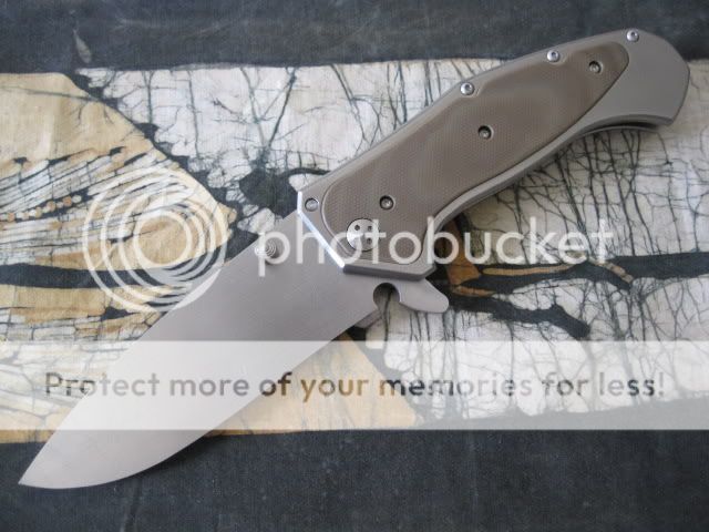

Allen and I have been working on this for almost a year!
Now after all this time, we put the proto together this weekend here at my shop. Still have to heat treat and grind the blade.

Nice , great choice going with the tip up / down option bud.
So was that Elishewitz guy getting the shakes from being in a non sterile environment ? ;)
Cool. Is that added-in section of the lock a travel limiter?

No, it's a stainless steel lock bar insert that gives gives us the benefits of a replaceable stainless lock face and the benefits of a titanium lock bar. This one is held together with 4 stainless steel pins that we peened in place, we haven't decided who we will to the rest of them, screws or pins.
These are technically midtechs, but they have a lot of hand work in the handles and hand ground blades. We will do them in limited, small batches that will have some varied features and finishes.

HOLY SCALLOPS! Can you elaborate on the purpose of having 4 scooped out area on the lock? :confused:
Beautiful knife though. You guys ought to make a midtech version.
If the titanium was not thinned out in a spot then you would no be able to operate the lock bar. No way most would be able to disengage a lock that is .160 (5/32 +) with your mortal thumb!
