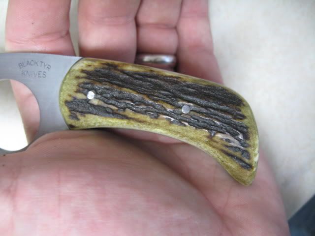

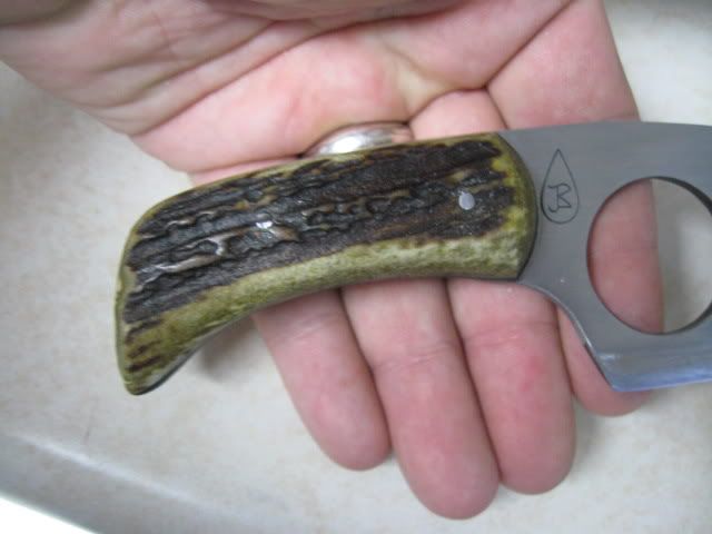

Here are some knives I made with elk antler scales:
picture.php
I would let the antler air dry in your house for 6 monthes before using it (it will shrink as it dries). Also if you cut scales before it is dry they will warp during drying. I use super glue to seal the ends if there is any porous material showing.

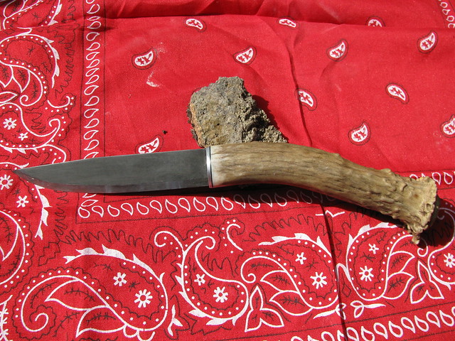

Not elk, but here is one I did in white tail. You should be fine using it raw, but you could always have it stabilized, or seal it with super glue, or what I like is a pine pitch/linseed oil mix.

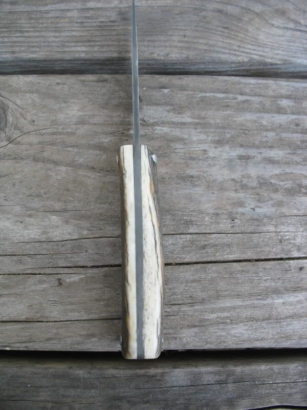

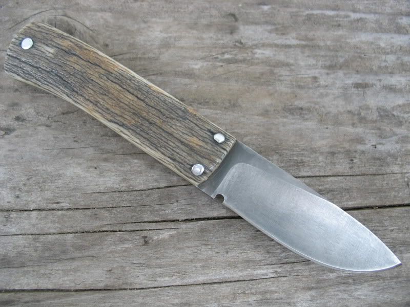

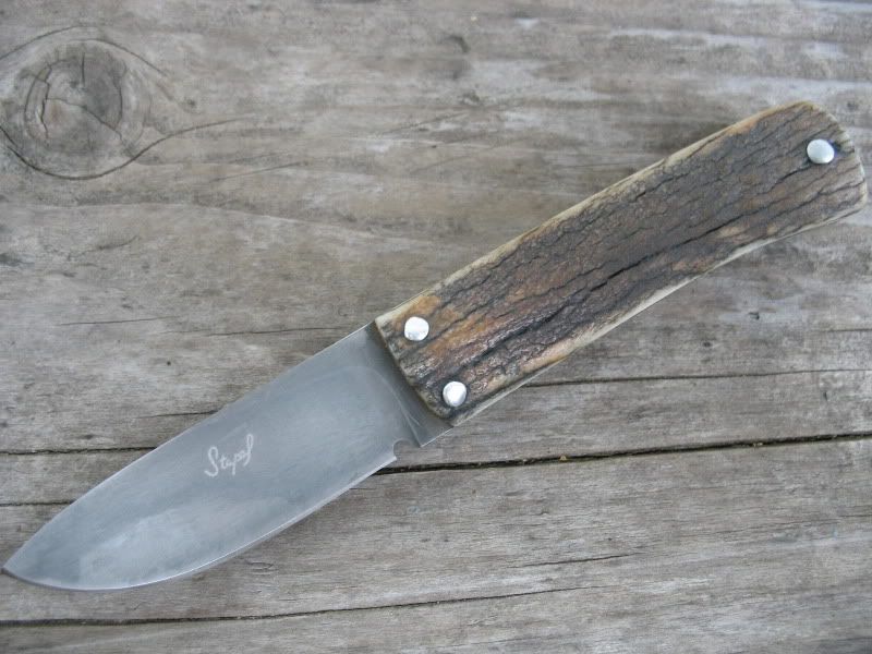

here's the only one i have.. it's a small utility/EDC style knife.. made by Ca, knifemaker Chuck Stapel... this is a is a cool little knife.. i have been carrying and using it a lot lately... i picked it up in April at a trad. archery shoot...
the natural off-set of the elk scales, fit my hand just perfectly..
