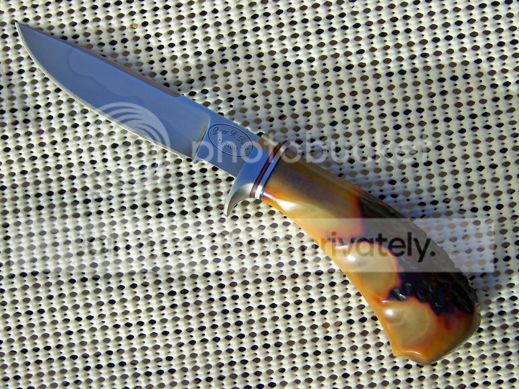

Here's a knife with a bleached out blacktail or mule deer crown with one of my phony dye jobs. :D
Ray,
With appologies to Nick.......
That looks like $hit, buddy! I'll give you a hundred bucks for it so you won't have to look at any more.:D
Seriously, that's a great looking knife!
-Mike-
Edited to add... for clarity and lack of pissing off TOO many people... I have seen some stag Russ Andrews dyed chocolate brown, and it looked really nice. And, I have never seen any stag that my friend Bill Burke dyed.
Thanks the commentary Nick. I think you are right about most of the dye jobs out there but there are a few that look ok. I guess if you have never seen any of the dye jobs that I have done then they must have been good ones.

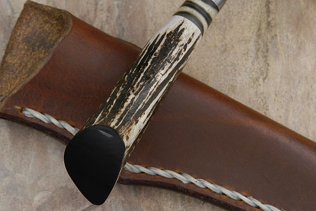

Here is a small elk brow tine with the Culpepper amber dye job. I like it.

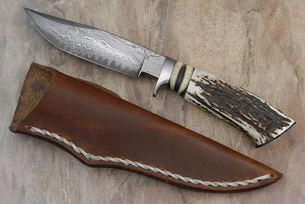

I use Krazy Glue with antler dust also to fill in voids/hairline cracks in aged elk. I get my darker browns on the buffer. I let it burn the anlter when buffing. Here's a bowie with some really aged/bleached elk.
Scott
Bruce, It looks pretty phony to me. :D They really do look good but anything you touch turns to gold anyway. I was thinking there dye penetrated deeper than that. I'll stick to doing my own dye jobs. I enjoy doing it.

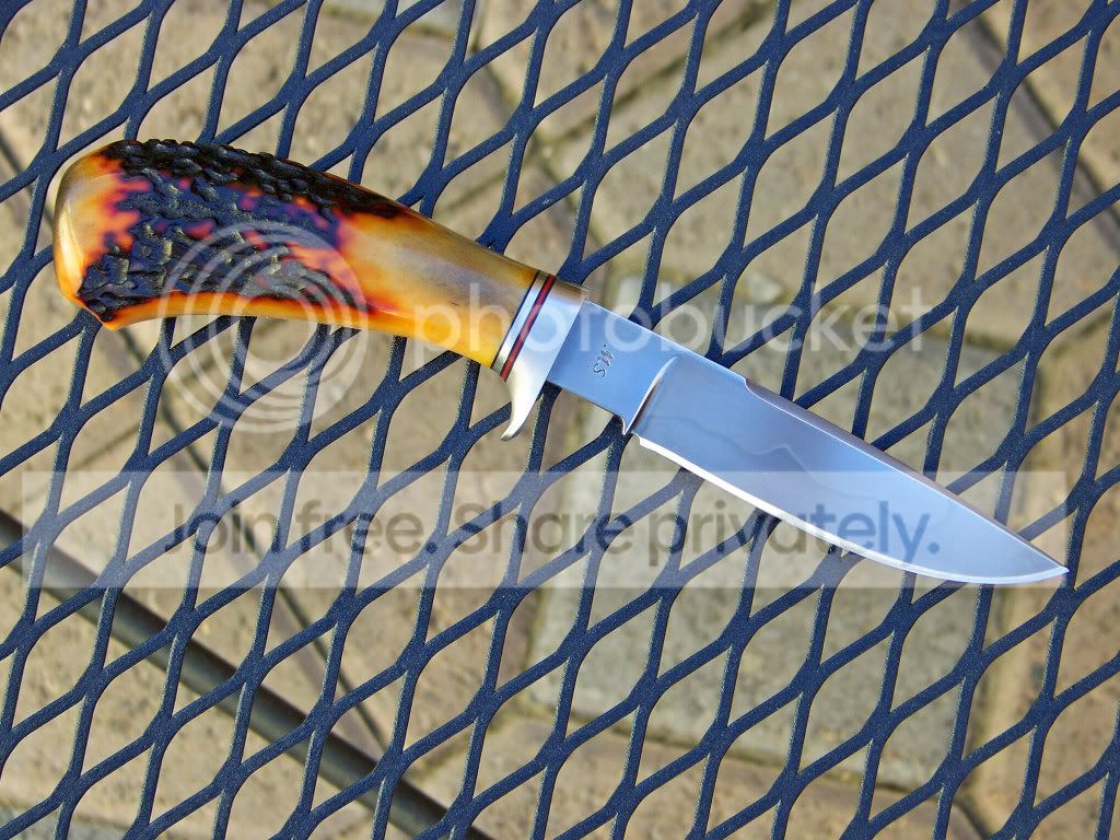

well since Bruce and Ray put up some pictures here are a couple of my dye jobs. I try and make them look as natural as possible. How did I do?
shopexd.asp
Well, you screwed up posting the image, but the knife looks awesome :D ;)
Here it is... That does look natural to me Bill. I love the dark lows and polished high spots like they actually look on the animal.

I think Bill's knife looks great, and I'm pretty sure I DID see that back when he sold it and didn't realize it was dyed antler... cuz it does look so good.
But for the most part, I will stick by my feeling that other than Culpepper most dye jobs just aren't MY THING. But if everybody liked the same thing it would be a really boring world. :)
Ray, you've got me on the fence with that one. I think you are one of the handful of makers around here that REALLY "gets" the idea of flow and line. I love your style and work in general (you already know that) but I'm not sure about the dye. I'd like to see that knife before you dyed the antler just to see. It's definitely a great knife though. :)
