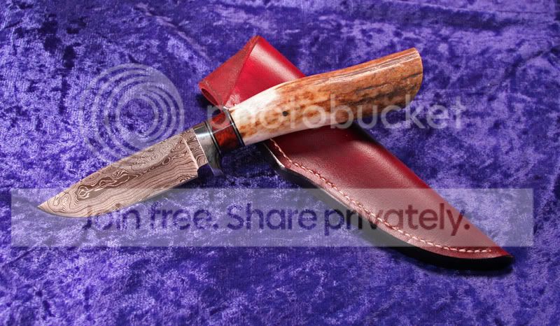

I make a ton of knives from elk antler and can tell you, like Fred says, only the ones and twos are worth a hoot to deal with. Whole antlers go for $10 a pound where I hunt in NM...more than the others are quoting. That being said, I usually trade my guide a knife a year for about ten or so antlers (give him one or two a year as well....great friend). Here is one I made from one of the brow tines that finished up well. The other parts of he antler? Too pithy, no popcorn, no shape.....
