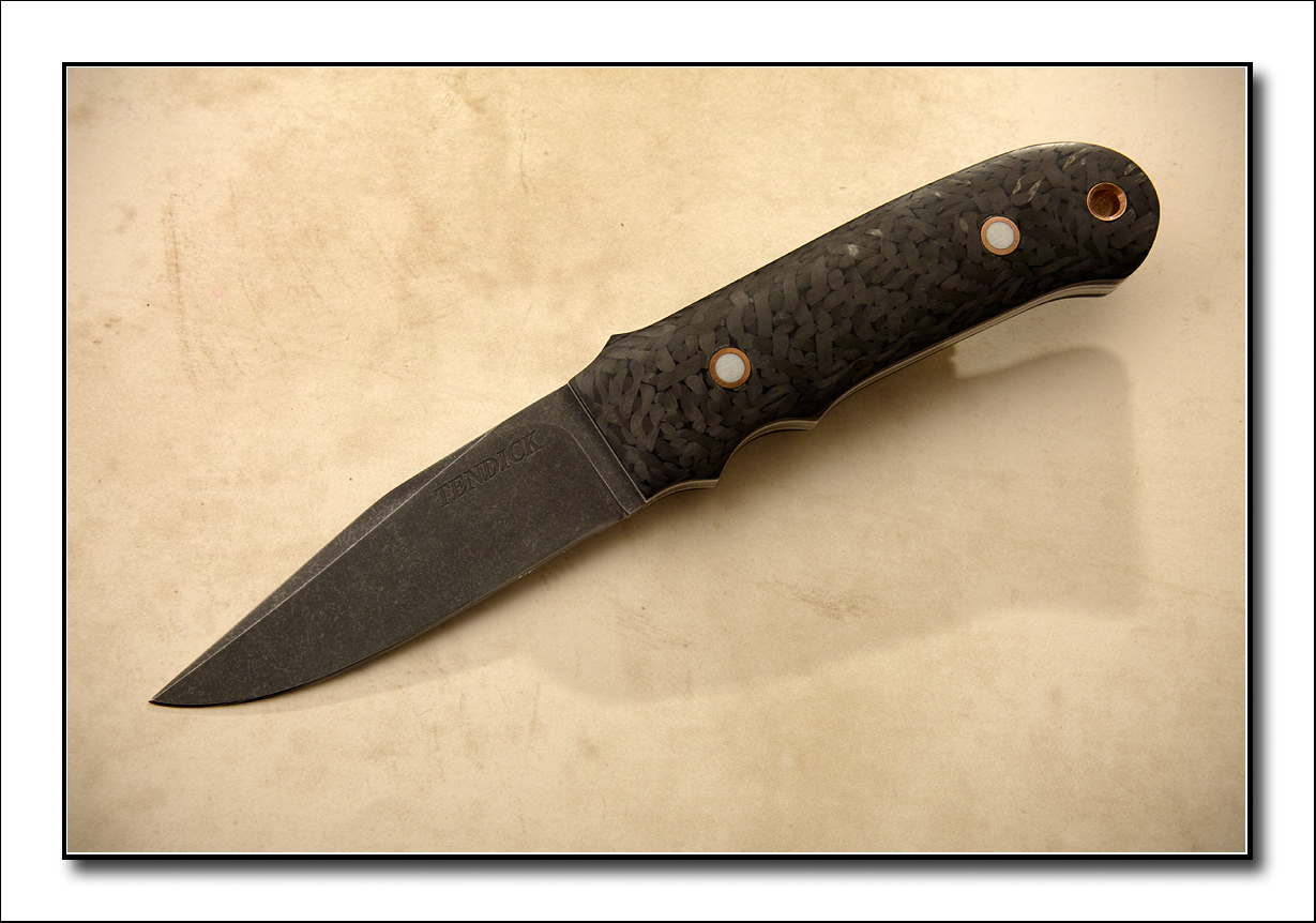

Got mine (along with two others for friends of mine) a couple of days ago and have carried it ever since - I have to say that I love this design for EDC-purposes. A real winner in my book, Ben! Thank you, buddy!
Here's one quick snap of my personal copy:

I am glad you are happy with it Alex. The Carbon fiber one was definitely my personal favorite.
wo, these are nice .. specially like the carbon fibre one, looks like it would 'hand' well, i'd love to pick it up
good thinking on the horizontal grinder too
can i ask what the acidwash consisted of?

The acid wash starts with being media blasted, then a 5 - 10min soak in feric and vinegar, and then a quick tumble. Comes out very dark this way.
