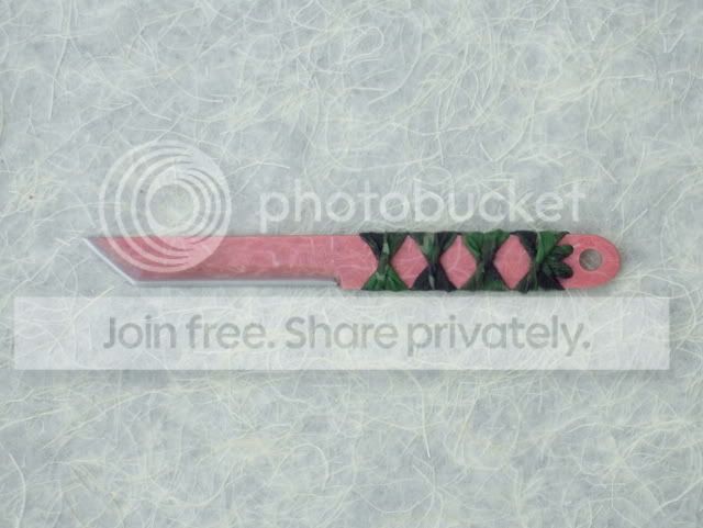

I make 8" oal American style tantos that are under an ounce
sample that sold last show with M2 edge:
same size in steel will of course be stronger and more durable, but will weigh 4oz
