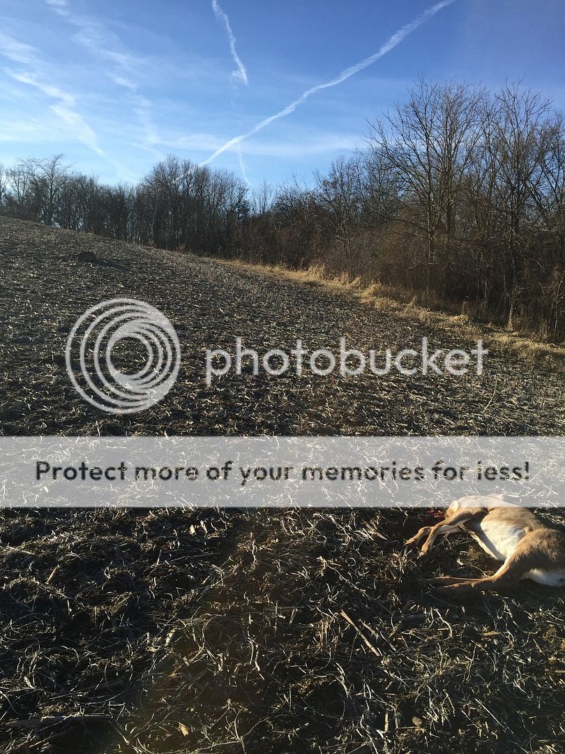

Even skinned and deboned a deer this past season. There is one on the bottom right and one on the top left of this pic (it was one of these two does. Sorry, no "in progress" pics)-
All of this work took the shine off the blade and left it with an odd tarnish. Kinda streaky and dark towards the tip.

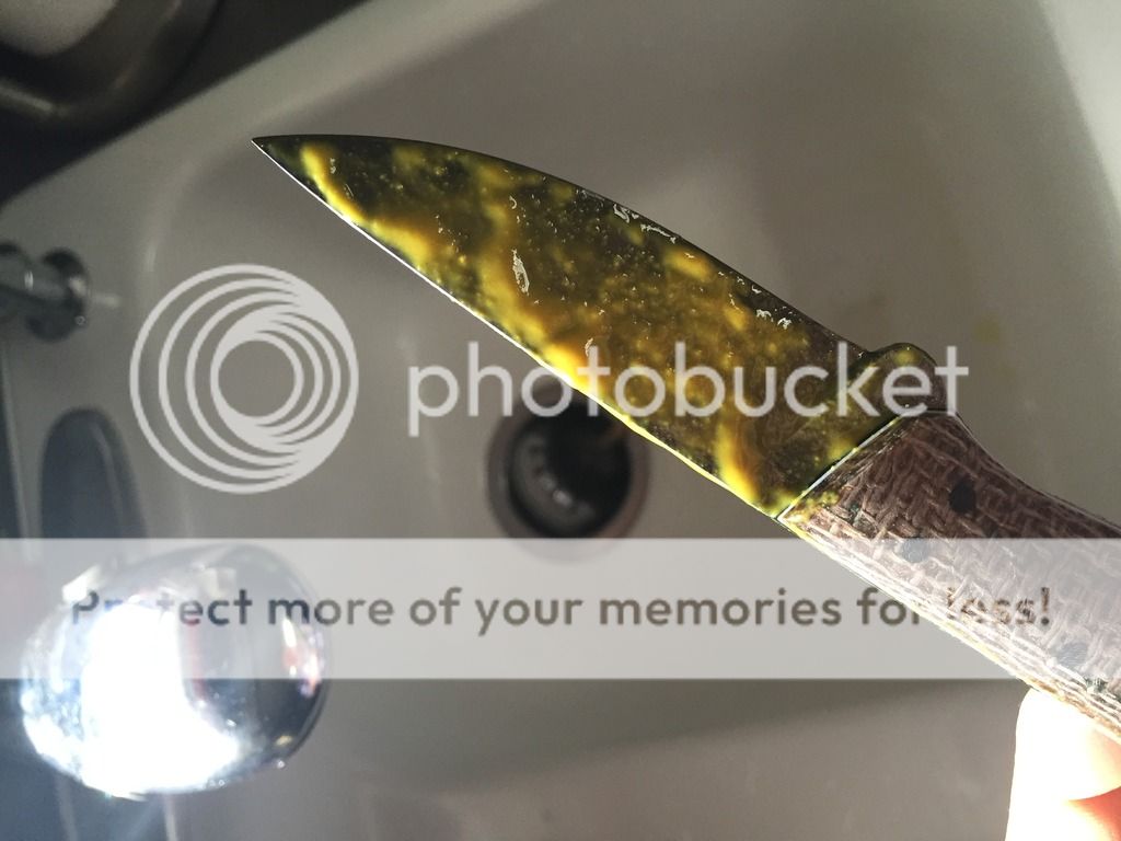

Round 2- mustard
Again. Results were- Eh. Boring really. These two methods left it spotty, streaky and uninteresting.

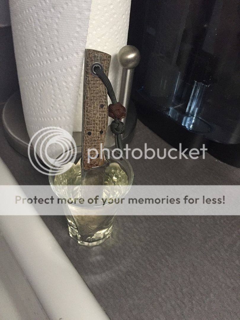

Looking around the kitchen we had some apple juice cocktail of sorts. How about a soak?
Again = not the results I wanted. I was hoping for a result that would bring a more even, uniform dull gray. Not streaky, spotty and odd. After all, it would do that with time anyway.
Then I remembered reading that many have had good success with a plain old warm white vinegar soak. (No pics. Looks the same as above)

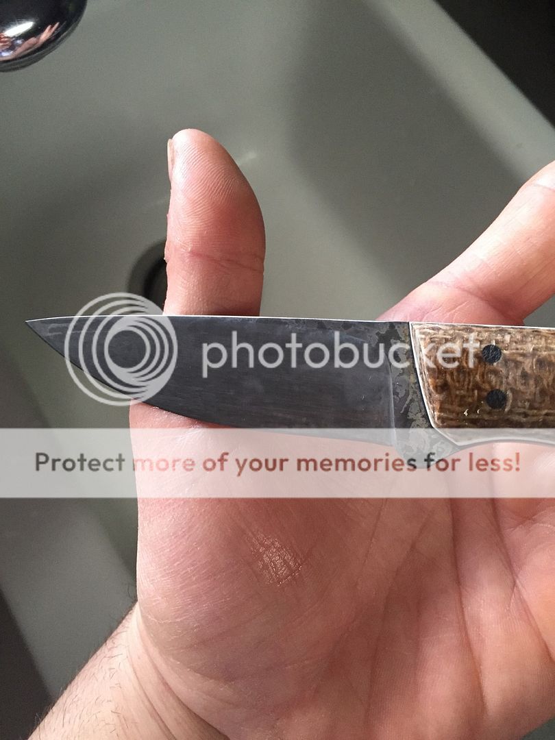

Why didn't I do this first?? It was just what I hoped for! A flat gray.
After stropping the edge back-
Long story short- I'm happy and got what I wanted. This knife and I will be together for a long time. After step 1 above, she will hold a special and sentimental spot in our home. And she is a great little workhorse.

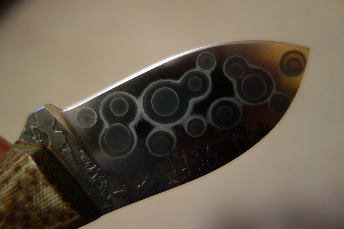

I call this my "Amoeba Patina."
A combination of forced and natural methods. I've since polished the blade to remove the patina because it was getting pretty dark and because of situations like this:
So, we often have friends over for dinner, sporting events, etc. I personally like to cook and entertain and often have a large butcher block out on the counter loaded with some fruit (lemons, limes, oranges, pineapple, etc.) to accompany drinks. I'll cut some before hand, but always leave a knife out on the block for anyone to go at it. Most of the time, I have the Ladyfinger on the board. During this past Super Bowl, a friend of ours needed a lime for her drink. I just happen to be looking in that direction and I had to smirk. I watched the confused/uneasy look on her face when she picked up the knife, looked at it and set it back down. She then proceeded to look around in our kitchen drawers for another knife. I walked over to her, laughed and said "You know, not all knives are stainless." She said yes, but I don't want that stuff rubbing off onto my fruit. Being married, I know that sometimes it is just not worth the effort of an explanation. Not to mention, my wife was hovering and once again reminded me "Really hun. It's about time to clean that thing." :rolleyes:
So, long story short, when I began to polish the blade, I was able to remove 99% of the patina on the first go around. What I noticed was a "Ghosting" of the original forced pattern that stayed on the blade. I stopped there because I actually think it looks pretty good :cool:
