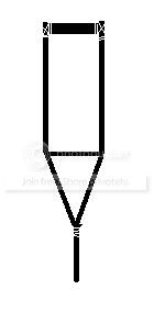

I once made a makeshift crutch for a friend whilst we were out camping, she had hurt her foot.
What I did was get a length of wood long enough, tie some cord around it close to the bottom and split the wood down to the cord. I then wedged it open with a piece of wood long enough for your hand to reach, and lashed the two top pieces to a piece of wood split in half for the armpit.
Here is a crude drawing - there are three pieces of wood total, two going horizontally and one split down the middle:
It worked well until it dried, it seemed to warp a little as my lashings came loose but it did the job until we got home :)
