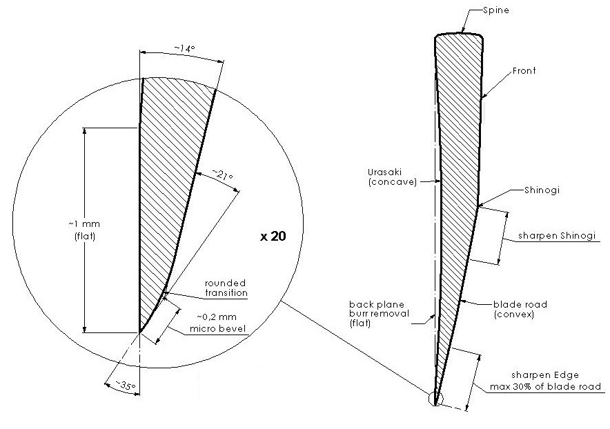

Sushi knives are chisel ground.
Talk about a complicated grind, some yanagi have the flat side actually slightly concave, and most are forged!
