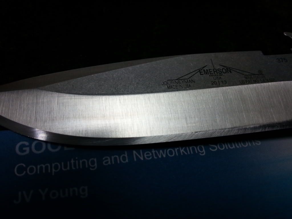

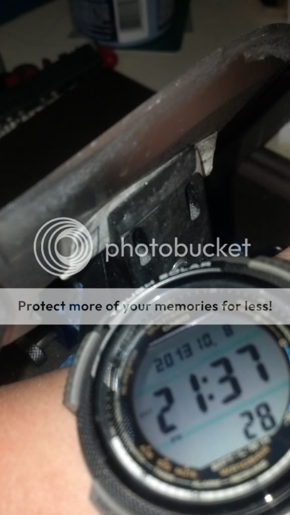

Ok, just did my Journeyman and sharpened it on the WE to 30 degrees inclusive. I took pictures with my watch so you guys can see the progression.
Started at 9:25pm. The edge was at 32-33 degrees inclusive at this point.

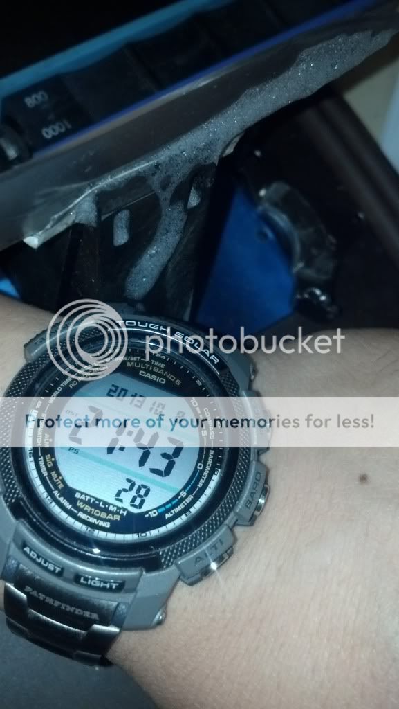

Done with 100 & 200 grit stones:

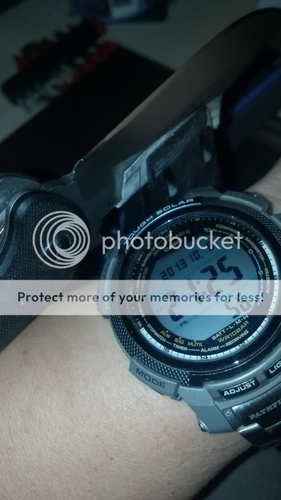

Done up to 1000 grit:

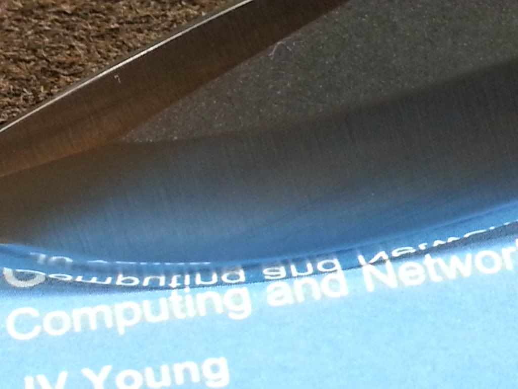

pic of the edge after 1000 grit:

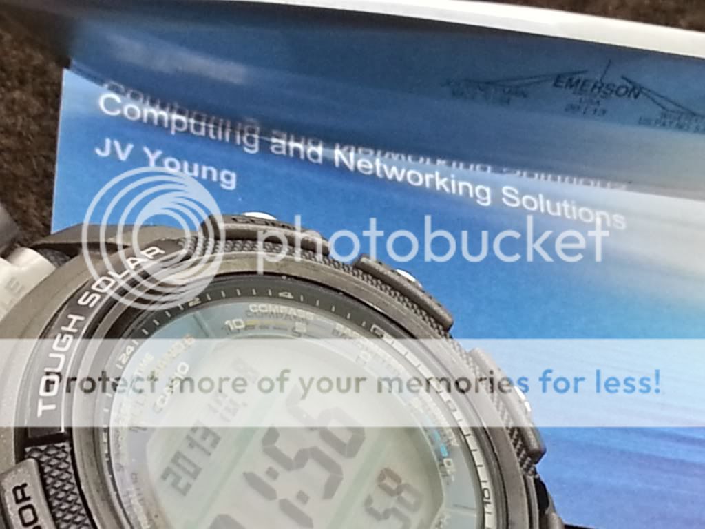

after the paper wheel strop. I was actually done at around 9:53pm, but I was trying to take a good pic of the edge with my watch in the foreground:
