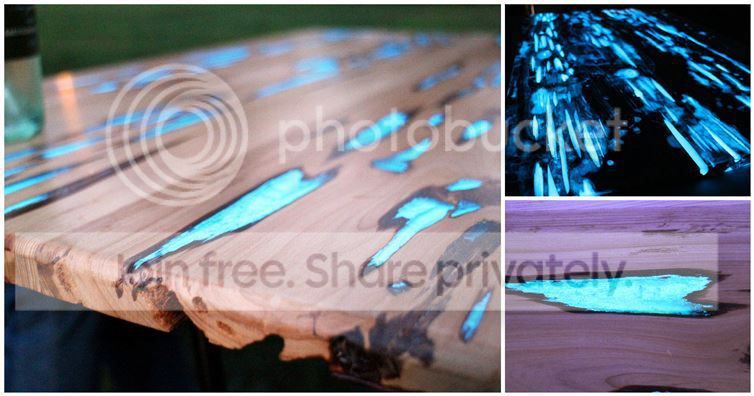

My goal is to get it to split and crack enough that after stabilization I have a stable piece of burl with enough gaps and such that I can fill them with resin mixed with Glow powder.
I hope to achieve an effect similar to this:

That is COOL. Be sure to upload some pics after!!
I have seen that type impregnation be done on burls with natural voids. Buckeye burl is the prefect choice. Other root burls may have pockets and voids.

My goal isn't to make a table, I'm wanting to make knife handles with a similar affect.

With forcing cracks and open eyes they will probably be too small to hold enough if the inlay material to look good.
