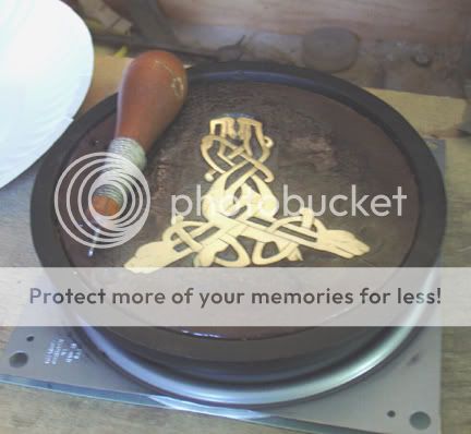

At it's simplest, one could carefully grind broken drill bits or harden ground drill rod and set the "graver" in a small block of wood and create some wonderful art. Add a pitchbowl on a sack of rice for a vise and you're good to go.
Tar (pitch) in a bowl, used for setting work pieces in. You heat it up until softened, then put the workpiece in enough to hold. It solidifies and holds things pretty snug. For use with a knife, I'd probably either try to set a piece of saranwrap on first, or I'd use a thermoset compound like "Thermolok" from GRS.
Put in a shallow bowl that's shaped like part of a sphere and set in a ring, it can be turned/slid.
Sorta like a forerunner of a modern engraving vise. Jewlers use them and it's used often for repousse' chasing.

Photo of my pitch bowl and push engraver. someone said in an earlier post that you could be banned from an engraver's forum if you asked about the differences and use of Lindsey versus GRS engraving systems.........if so,those forums are worthless to those people who already engrave and those wanting to learn and do a diservice to everyone.
