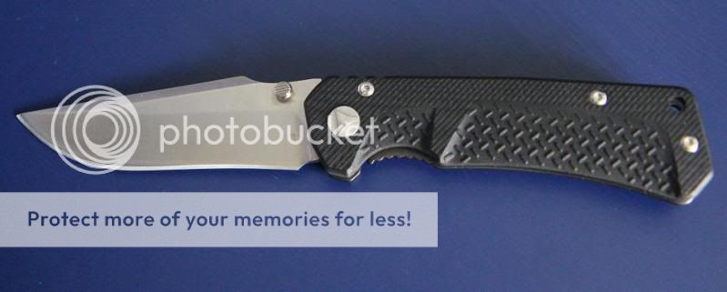

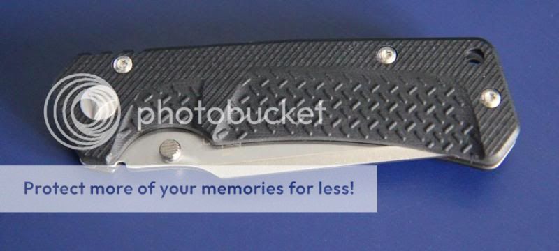

Front view (Closed) - Black G10 feels cheapo but grippy
Front view (Opened) - Gorgeous blade shape with a slight recurve

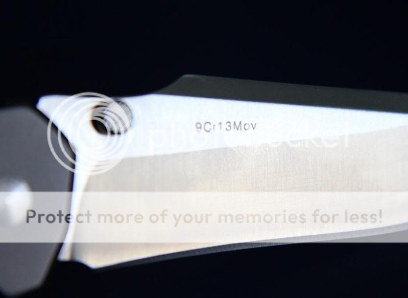

9Cr13Mov blade

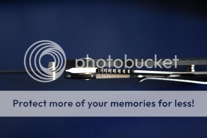

Lockbar stabilizer - Prevents lockbar from over-extending when disengaging
but doesn't prevent movement of lockbar towards the spine when gripped
tightly

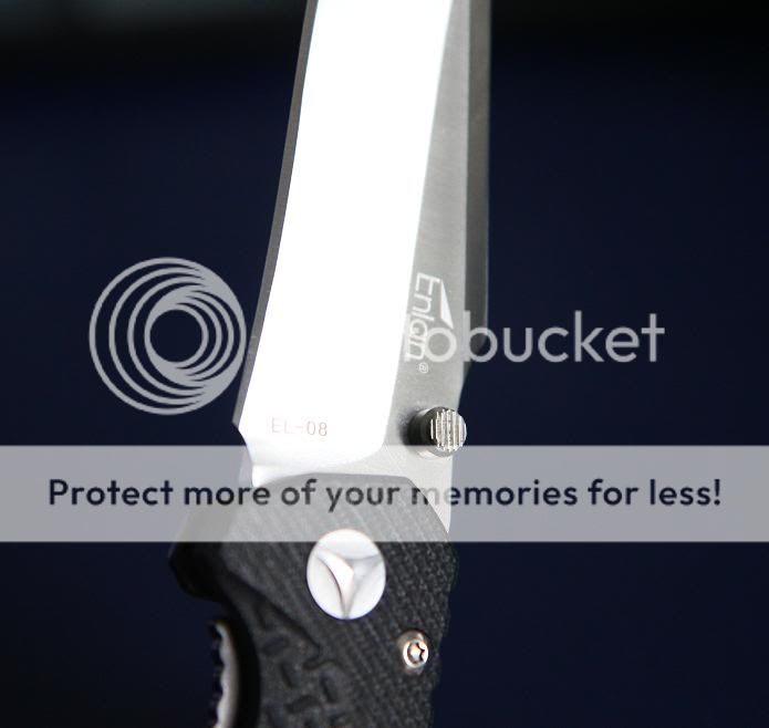

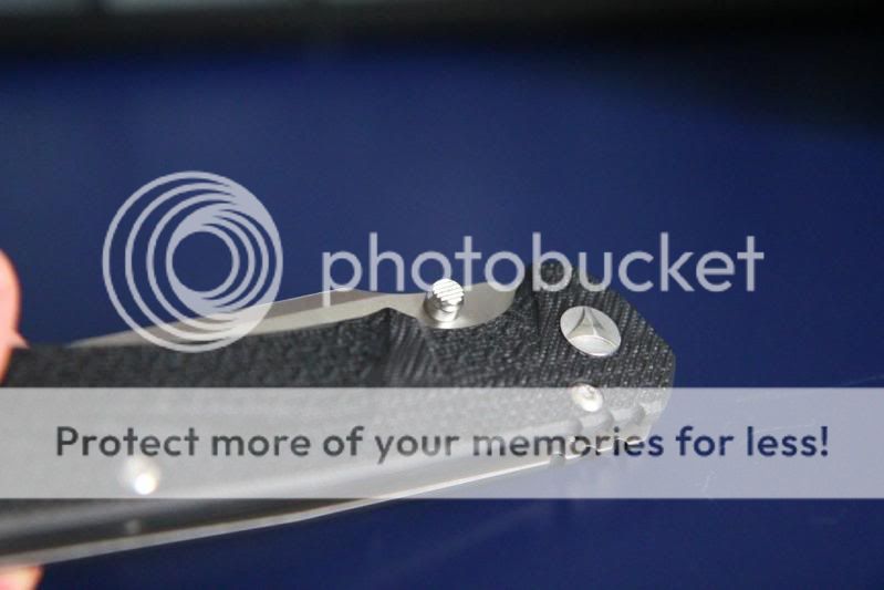

Functional dual thumbstuds providing plenty of traction

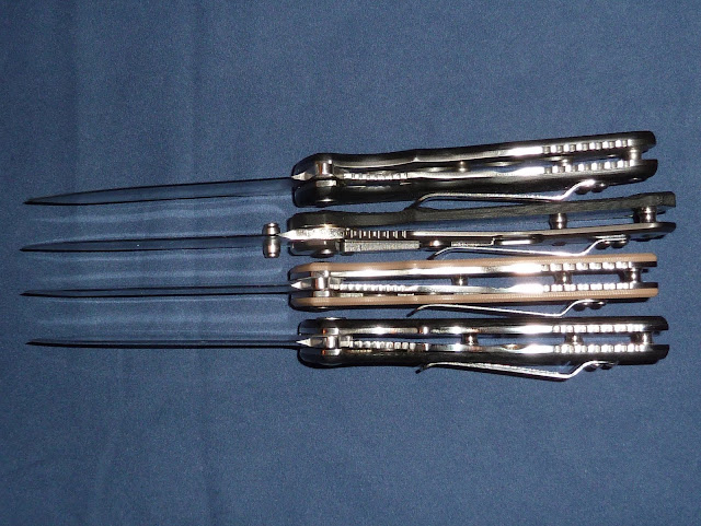

Size Comparison

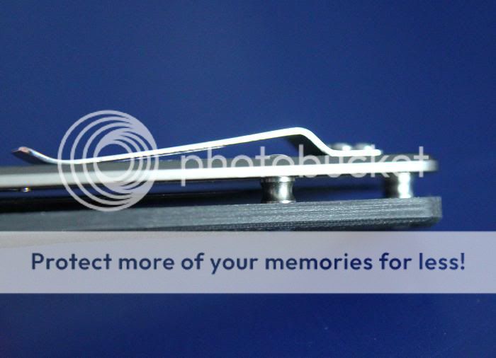

- Pocket clip is sturdy and tension is just nice ; tip up carry

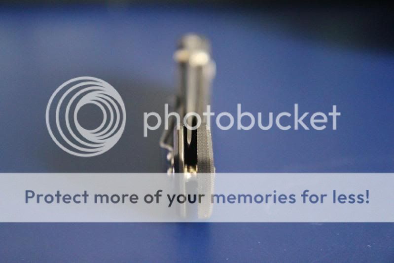

The lockbar may look thin and flimsy on photo but the truth is it isn't. As a matter of fact, it's slightly thicker than my small sebbie 21 and not to mention that it's stainless steel instead of titanium so that should be even tougher.
Here's a rundown on the thickness of lockbar vs thickness of cut-out for the folders displayed in my size comparison pic:
Thickness of lockbar/Thickness of cut-out
1) Small sebenza 0.128"/0.055"
2) 755 MPR 0.211"/0.038" (OMGGGG that's suicidal!!)
3) Sage II 0.122"/0.052"
4) DPx HEST/F 2.0 0.156"/0.056"
5) EL08 0.132"/0.057"
Seriously, if not for F&F issues, I would have recommended this folder to everyone whole-heartedly.

How's the thickness of frame lockbar compared to EL01? Seems only 20% or less thicker.
And thanks for the review. If they make it 4.25"-5" blade, it's an option for me (larger & more robust). As of now, the overall form/length for usage is covered by EL01 already.

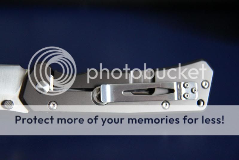

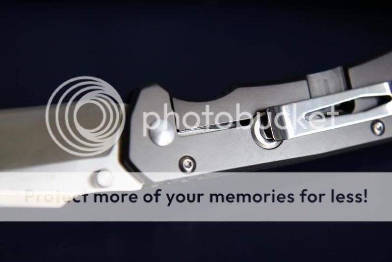

As I just got the EL08 and I have the EL01 too I will take the liberty to answer you question.
To the naked eye the thickness of the frame lock in the EL08 is a bit bigger than the 50% of the EL01 although is quite harder to operate. Keep in mind that the width of the lock is, again to the same naked eye, the double in the EL08 than in the EL01.
I just took a couple of photos of both knives side by side. I hope it helps despite the flash glow...
I hope it's ok I answer even if I wasn't asked.
Cheers.
Cheers.
