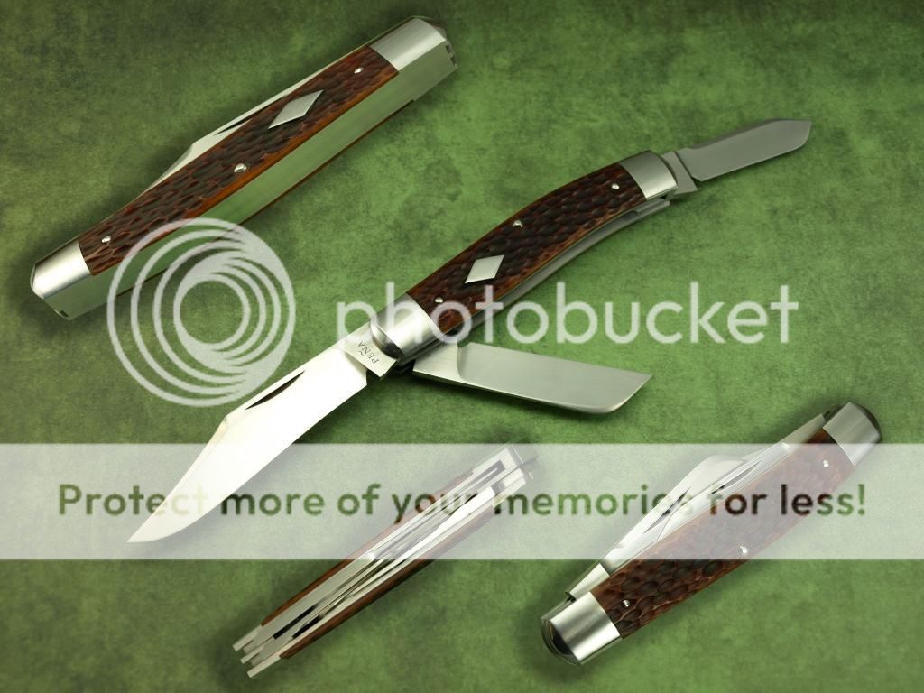

Hello to all. Here is a picture of another knife that I will be taking to the 2013 Blade Show. The knife is 4" closed, blades and springs are CPM 154, integral liners and bolsters, pinned shield, pivot bushings and stainless steel washers instead of mill relief liners for a cleaner inside look, very nice and positive action, flush in all positions, and nice and tight liners and springs. Thanks for looking and your previous comments on my knives.

Enrique, of all the custom slipjoint makers out there, yours are the ones I admire most. That jigged bone is incredible, the dark perfect ovals against amber color is just awesome. Also those swedges look great, thin and clean. I don't know how you do it man, that is a lot of attention to detail. Very nice

This knife measures 4 5/16" closed, blades and springs of CPM 154, integral liners and bolsters, washers instead of mill relive liners for a cleaner inside look. This knife turn out really nice and the fit and finish is really nice and clean as I stated earlier that I like. The blades nest really nice with no blade rubbing, all nail nicks lend themselves to ease of opening the blades, the spine is as clean and tight as can be, the springs are fully flushed in all positions, the action is right at about a 5 on my scale on every blade and the action is very smooth on every blade.
