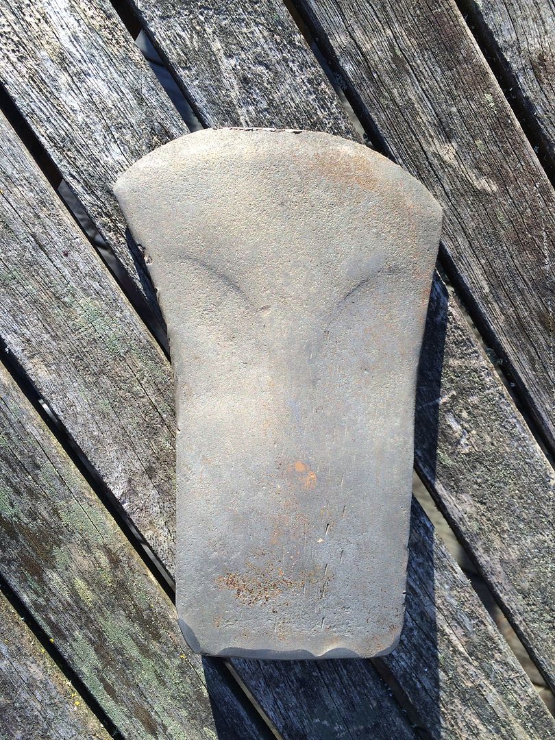

My thought is this; you're going to get a burr of some kind before you actually get the two bevels to meet. The chipping you describe sounds like you are grinding off the "false" burr (so to speak) and finding underneath that the bevels haven't yet been brought together. So you start in with the stone and it takes even more work and time than the file, when in fact you aren't ready for the stone yet.
I believe the pucks are pretty much the same as any other coarse/fine stone you might find in a hardware store, but I wouldn't use one unless the axe is already pretty sharp. I just use a flat rectangular stone as long as possible (and coarse too), lay the axe on the bench with the edge hanging over, and get into it. The stone is longer and I can get more work done per stroke, but this is only after I've actually got the two bevels to meet (belt sander for me).

I have a 12 inch mil bastard file, and a lansky puck. Clamp the axe in vice, run the file on it until the nicks are out and there a bur on the edge. Then I take the puck to it to try and finish the edge, but if I try to put a cutting edge on it, the blade just starts chipping. I can put an edge about like a butter knife on it, any sharper and it starts to chip.
That sounds like a bad heat treat or lousy steel. Rare to find one like that in my experience.

Are you pushing from bit to cheek/poll as perpendicular as possible? Different files do have different cutting attributes. Maybe you need a finer, shorter even (for control), file than the one you mentioned?
Here are two pics of what I currently use just for reference in my rambling:
For large metal removal such as bad mushrooming or on unhardened spots I use a vixen cut with a full-length handle. Removing a lot of hardened steel, I use a big Pferd - it strips it off like a cheese grater, leaves cut marks though. It's helpful for larger reprofiling of a bit.
That is when I hit it with the bastard file, smooth out the marks/finer removal, then a smaller file of the same cut.
You're results may vary. :)
That is the process I used for this unmarked head. Initially thought the steel was mediocre but my friend has split a lot of fit and juniper with it and it's holding an edge well:
