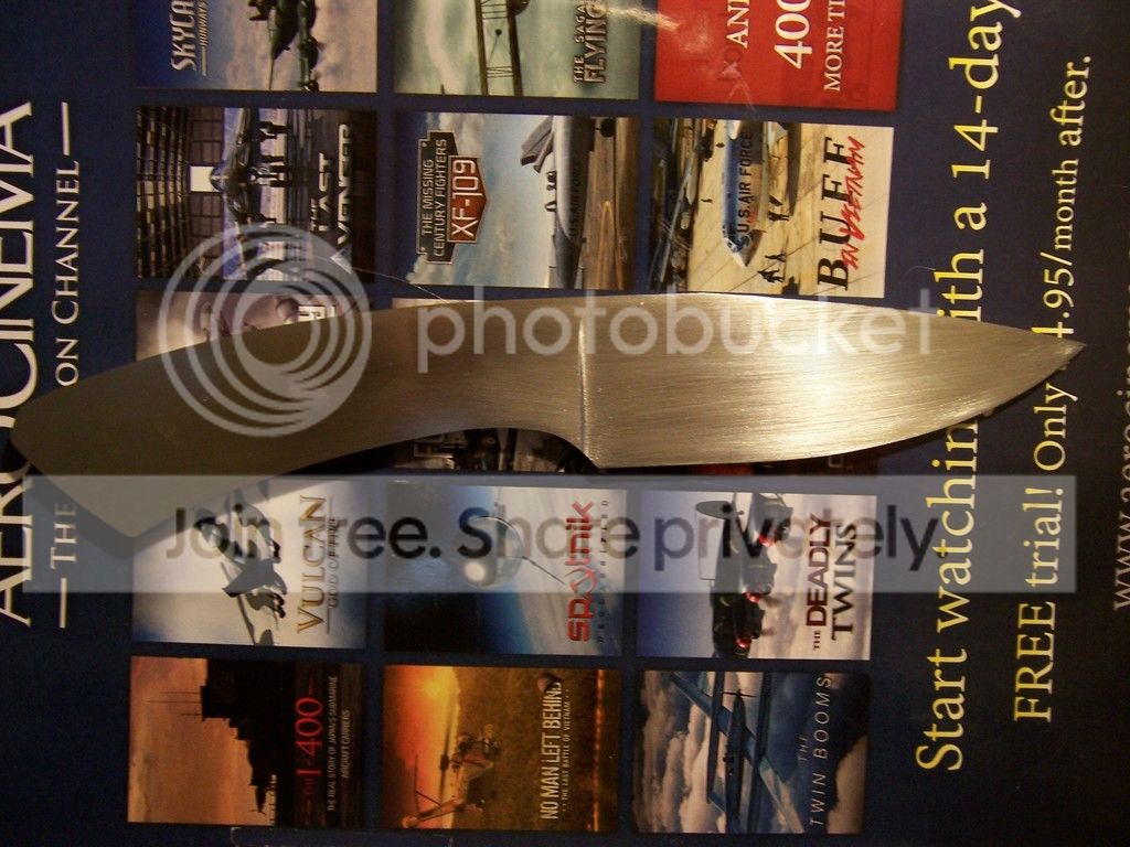

I made these on my Wilmont LB1000. I have replaced the resin wheels and have a fully adjustable table. You don' necessarily need a more professional machine to get started. The craftsmen here have been my teachers and will always help you.
