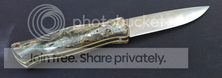

Ok, I snapped some pics of my D2 Enzo Trapper today. Sorry for the crappy quality, all I had was my webcam. This Enzo became a user as soon as I finished it up - so I never got back to polish out all the grind marks from the original bevel. Oh well. The next time I bring it in for sharpening, I'll polish those out.
Here are the statistics:
- Triple-layer laminate for the scale, held together with West System epoxy.
- Liner is 1/16" red G10
- In the middle is a 1/8" piece of moonglow
- Outer layer is 1/8" translucent jade green G10. The G10 helps protect the moonglow, which tends to be soft and scratches easily.
- Reamed out tang holes to 0.1890" (#12) and fit the scales with two 3/16" pivot bolts. It is a knock-down, so I did not use epoxy on the tang to mount the scales.
- To make the scales more stable, I used small bearing-race washers underneath the pivot bolt head. They sits tightly in each 0.250" counterbore hole. These washers are from Amazon Supply.
I didn't include it in the picture, but I'm using the standard Enzo trapper sheath for carry. I also need to get some low-light shots to capture the moon-glow. Really useful at camp in the evening...
TedP
That's very nice, Ted.
Except for the last shot, it's really hard to tell where the mooglow ends and the jade G10 begins.
I'd like to see it glow!
I hope I can get my wood/copper/G10 scales to come out as smoothly, but I keep burning through abrasives so I'm not sure I'll ever get it done. The epoxy set last night, so we'll see what tools I can break this weekend finishing it up...
As you can see, my scales extended past the matte finished area, so I didn't have any such concerns. Though I did polish up the spine, between the scales, pretty nicely.
