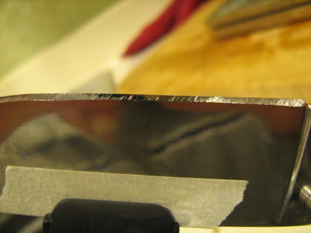

The edge pro is a very nice tool but is overly expensive for what you get. I mean really you get a 120 & 320 grit water stone and a ceramic rod with the basic kit all for $350 that's just a amazing deal :rolleyes:
Thin stones..... thin stones are good for shaped blades but if your edge has any defects like a recurve set by the factory sharpening your never going to see it. This is a edge that was previously sharpened by a edge pro, seems as something was missed.
The untouched spot in the middle is the recurve.
Waterstones WEAR and get thinner soooooooo you change angle every time you use it. Now my question is are all the stones and mounting plates all the same thickness? because this will have huge effects on your sharpening.

Unfair photo, Knifenut!! I call 'foul!' Why not show a photo of an edge done by someone who knows how to sharpen? Heck, even a newbie freehand sharpening can do better than your photo shows! :jerkit:
When I finish a knife using my EdgePro you can use any part of the bevel as your shaving mirror. You don't see any scratches. You don't see any inconsistencies. All you see is a perfectly sharpened and polished edge. And it only takes me less than 20-30 minutes to go from an edge that won't push cut paper to a hair whittling finish.
Yes, it does take me 2-3 minutes to set up. Yes, it can cause scratches on the side of the blade if you care about such things, and that would necessitate the use of some tape. (another 30 seconds) And it takes me 20-30 minutes to bring a folder from dull to hair whittling sharp. How long does it take you to freehand sharpen a folder from dull (can't push cut computer paper) to hair-whittling sharp with a perfectly even, mirror bright finish?

The knife shown came to me exceptionally sharp (I'm not saying it doesn't work good) it was finished with a 3k polish tape and was able to split hair. It looked perfect but I found different when sharpened on a wide flat stone. What you see in the picture is the heavy grind marks from my XXC stone and the polished point between is the slight recurve that was started by the factory sharpening. I know this is the case because the twin of this knife had a factory edge with the same problem. Its something that's actually very common with factory grinds and when you use low sharpening angles that are very precise even the slightest flaws like grind width and straightness of the edge stick out like a sore thumb.
I have nothing against the system because I know in the hands of a professional it probably works wonders but I do have something against the hype and the very straight bevels that are made by guided systems. Its another easy button for sharpening a knife and without it those that have not used any other method are usually lost in maintaining their tool. The precise bevel look nice but in use tend to show the most wear and sometimes even small chipping, something I quickly found out with one of my CPM-D2 blades. Nothing is perfect no matter how much we want to believe it is, and no device can take the place of actually learning what sharpening is. It makes me sad more than anything when I see things like this because it follows the trend of "Do it for me" instead of the old "do it myself. Sharpening is becoming a lost art in a fast paced world.
