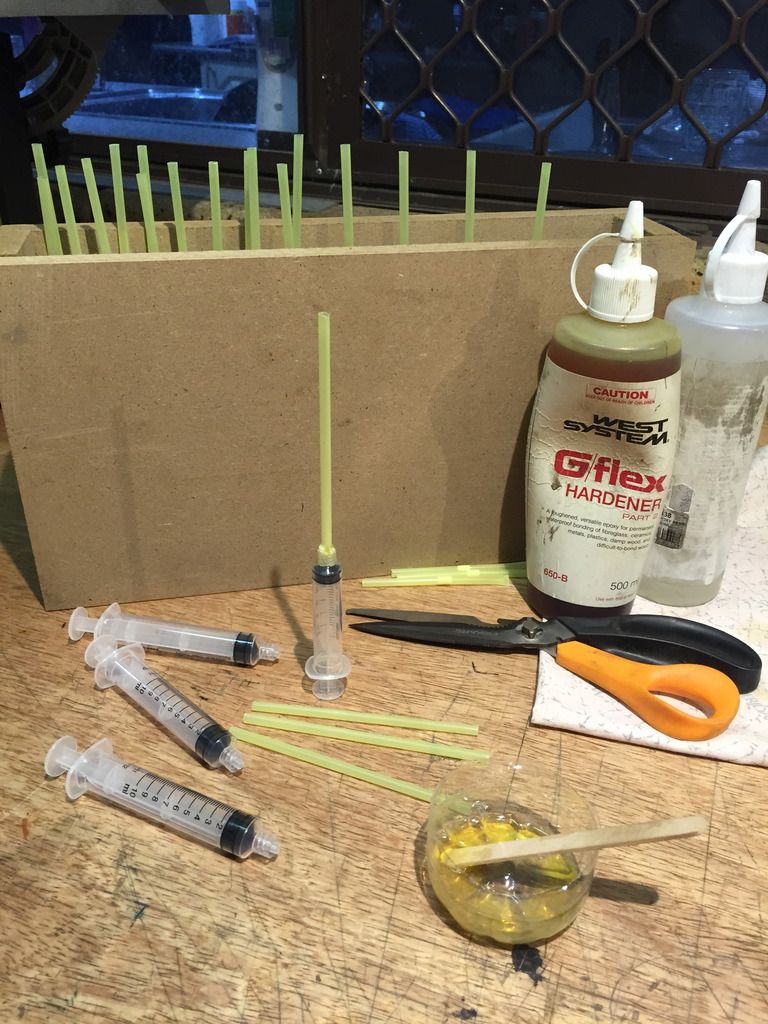

West systems G flex for me , apart from the peace of mind of using a quality product i like the fact that you have the time to work getting the fit up right with out rushing.
For narrow slots on a hidden tang i use a syringe with a straw glued to the end , the straw will fit into the narrowest of slots and down to the end of your tang hole, pull the straw out slowly as you inject the epoxy.
Normally i just make up a few for the next job(s) with any left over epoxy
