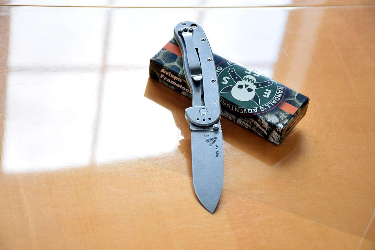

Received mine today, very happy with the Knifeworks, lightning fast shipping, great knife, great size, love the color of the scale, excellent fit and finish,
perfectly centered blade, smooth opening, positive early lock-up...
It must be too good to be truth, right...?

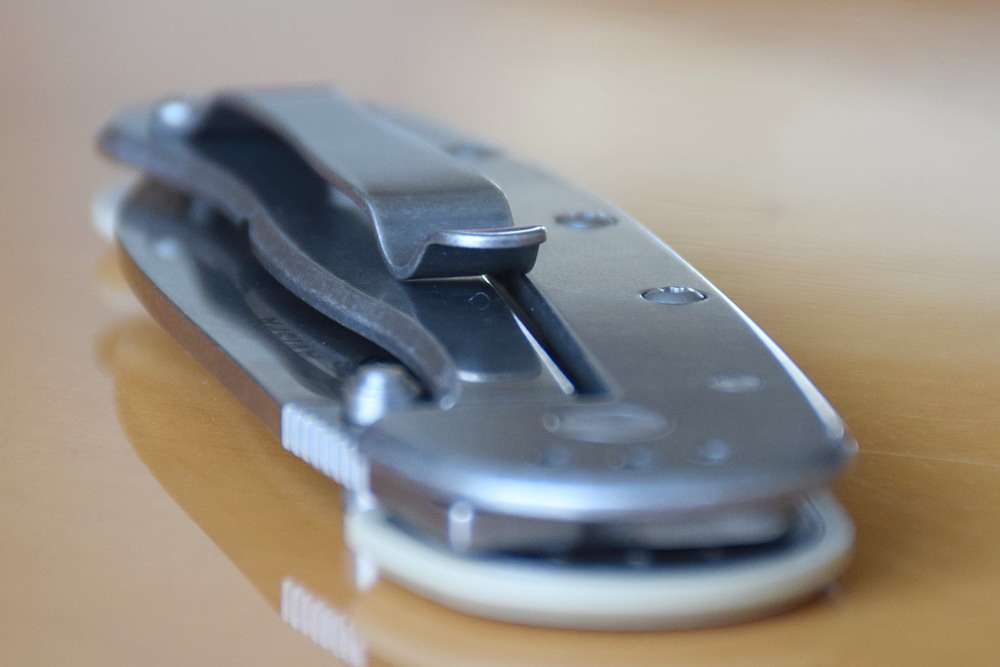

Well, if you thought that, you are correct... Take a good look at the picture above and tell me if the clip should lay directly on the lock's spring...
The knife came with tip-down clip, when I switch it for tip-up carry, I found out that someone didn't do the math correctly and by pressing on the spring,
it's almost impossible to open the knife and close it with one hand...
I loosen the screws and repositioned little bit the clip, did tight the screws again and it was supported on the frame, probably with half a millimeter...
It's still there but it shouldn't be that way and I'm not happy... I absolutely love the knife but I cannot imagine I'll use it that way, I hope this is not a common problem with those,
if it is, they probably should come up with wider clip, so when you switch from tip-up to tip-down it will be supported firmly on the frame...
This is how it looks like now...
Maybe they were trying to use it as an over travel stop for the lock. If it doesn't touch, and is only close, how does it effect opening and closing? The lock should never move further (closer to the clip) than it shows in the picture, right?
I don't believe they made this by purpose... It doesn't make sense to me at al... When clip is moved for tip-up carry, it naturally falls completely on the spring, doubling the pushing force.
I have a really hard time opening the knife one handed, closing it for me is almost impossible if I don't use both hands.
This is how it looks like before I loosen up the screws and reposition it so it barely supports itself on the frame, it doesn't touches the frame at all:
When I reposition it, it looks like it is on the bottom picture of my previous post.
There are no knives that I know that would have the clip directly pushing on the spring.
One millimeter wider clip, on both sites, will solve the problem instantly. I hope this is not the case with all the knifes released because it will be real turn off for some.
It is a great knife IMHO, I wish they release a different clip to fix this issue, I would even purchase it because I like a lot the shape of the original,
otherwise I would have to look for aftermarket clip in order to use the knife without worrying that I would not be able to open it one-handed when I need it...
