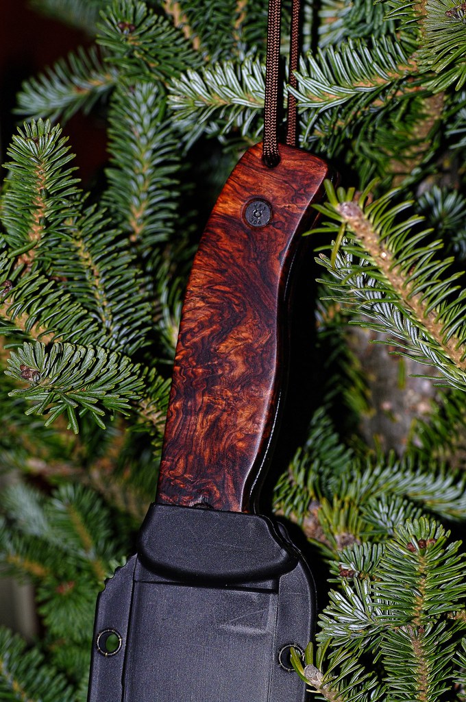

Here is my ESEE-6 hanging on my Christmas tree from Santa with a Honduran Rosewood Burl museum grade mod.

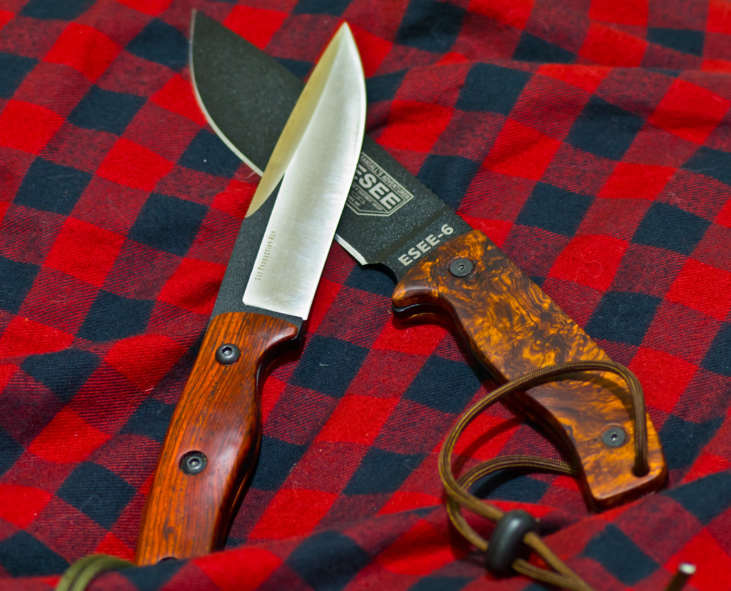

Here is my ESEE-6 with my Bark River STS-5 with a handle mod using prime Cocobolo wood. Two very fine knives.
