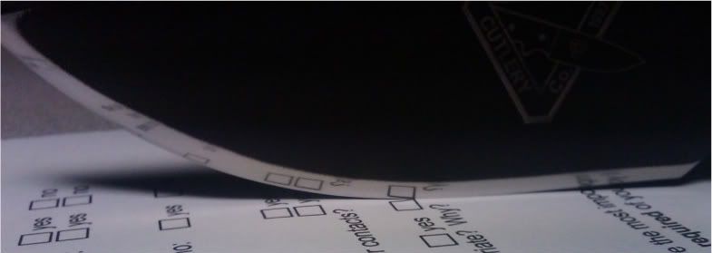

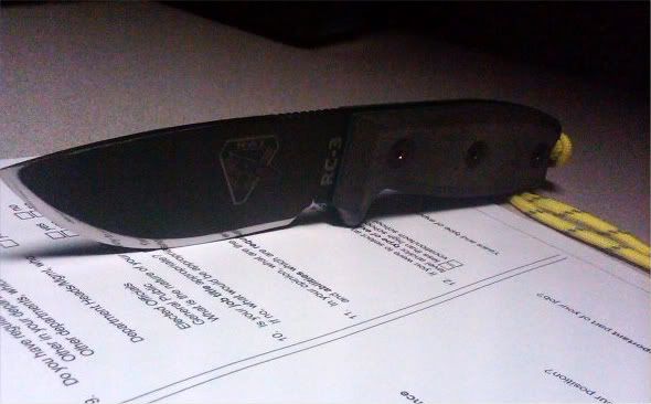

Izula, sandpaper, and mousepad here.

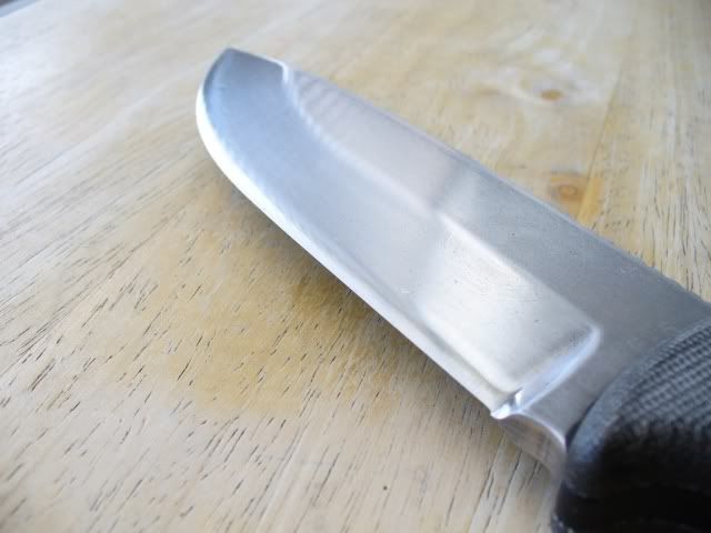

My first attempt at any edge/bevel modification, pretty happy with the results so far...

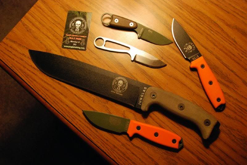

These are all convexed.

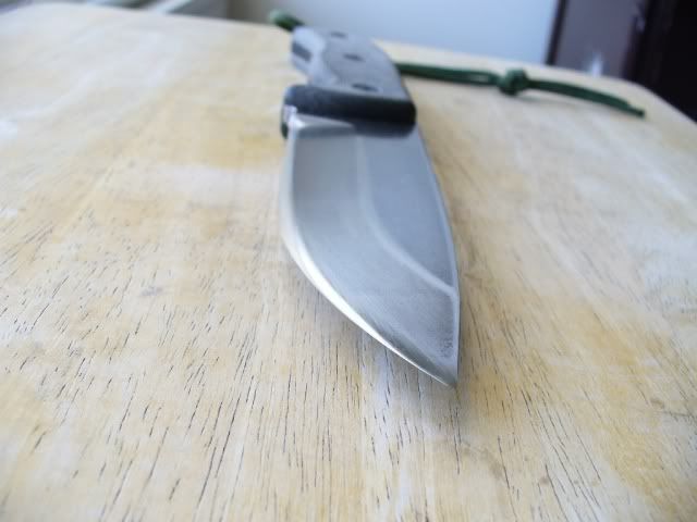

Yeah they take a great convex, and they hold the edge very well. Apologies for the bad pics / low light
Blade up close
