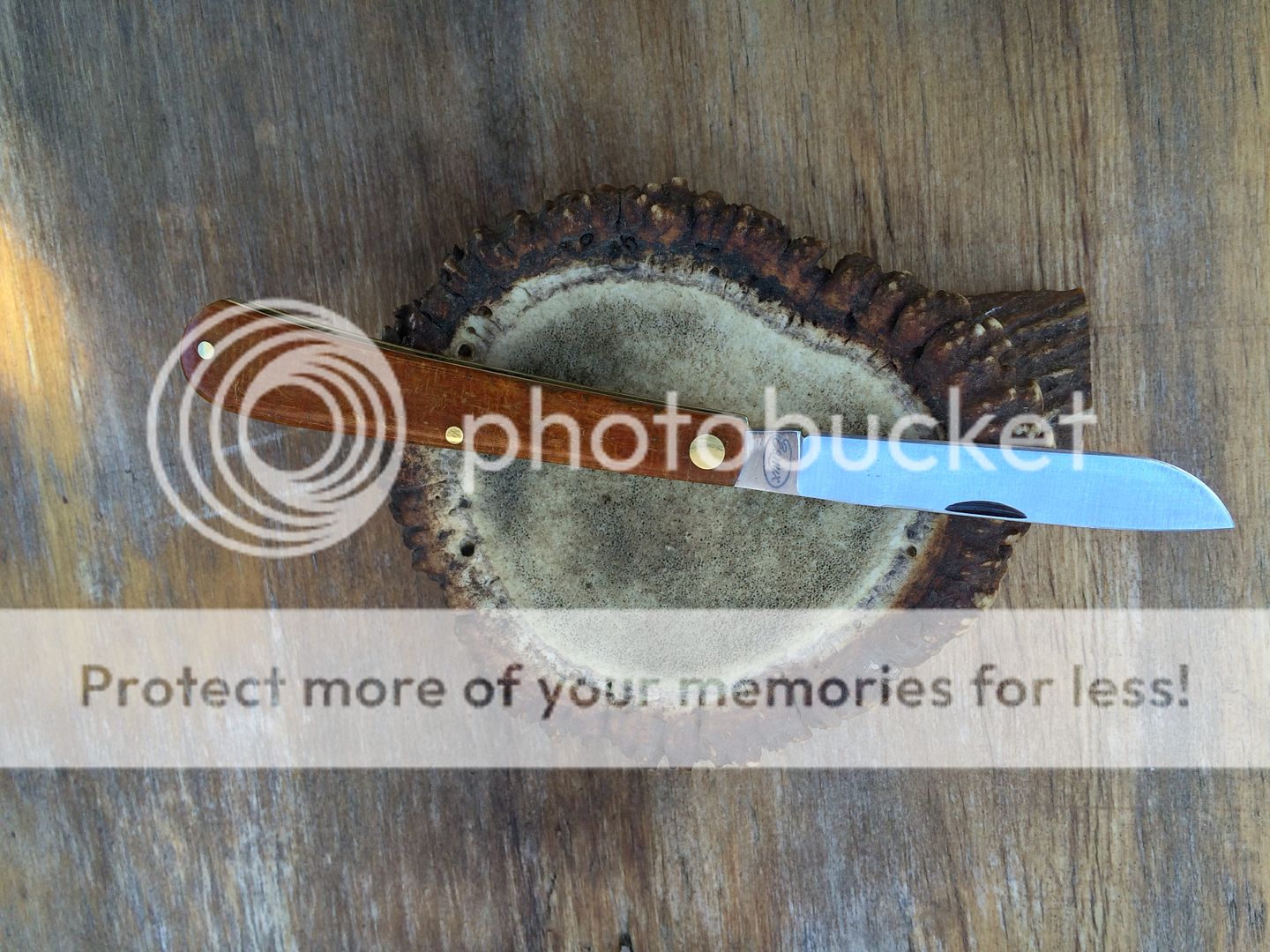

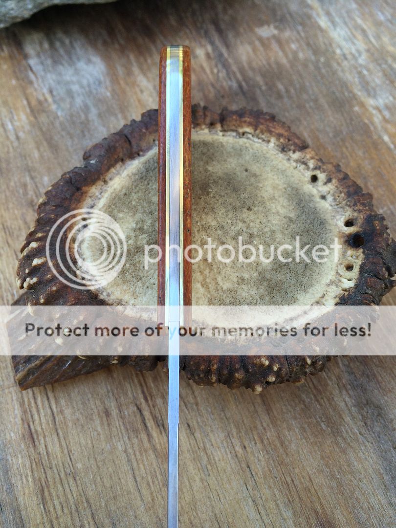

I hope to see many more posts appearing in this thread in the future.

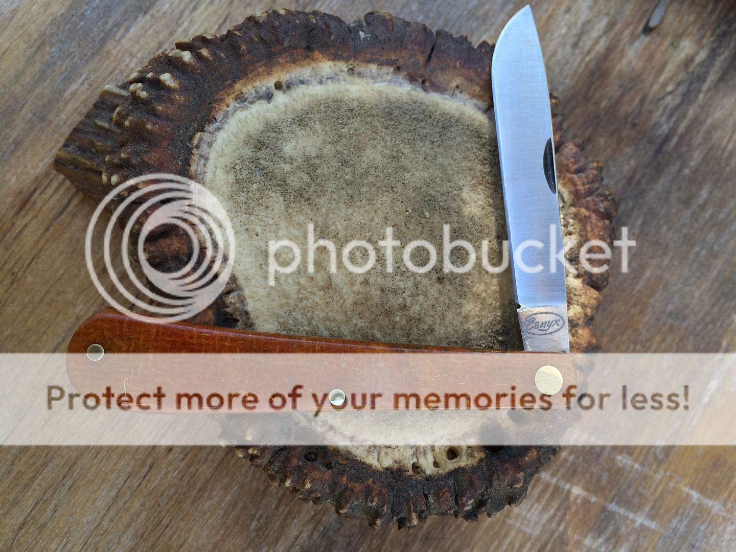

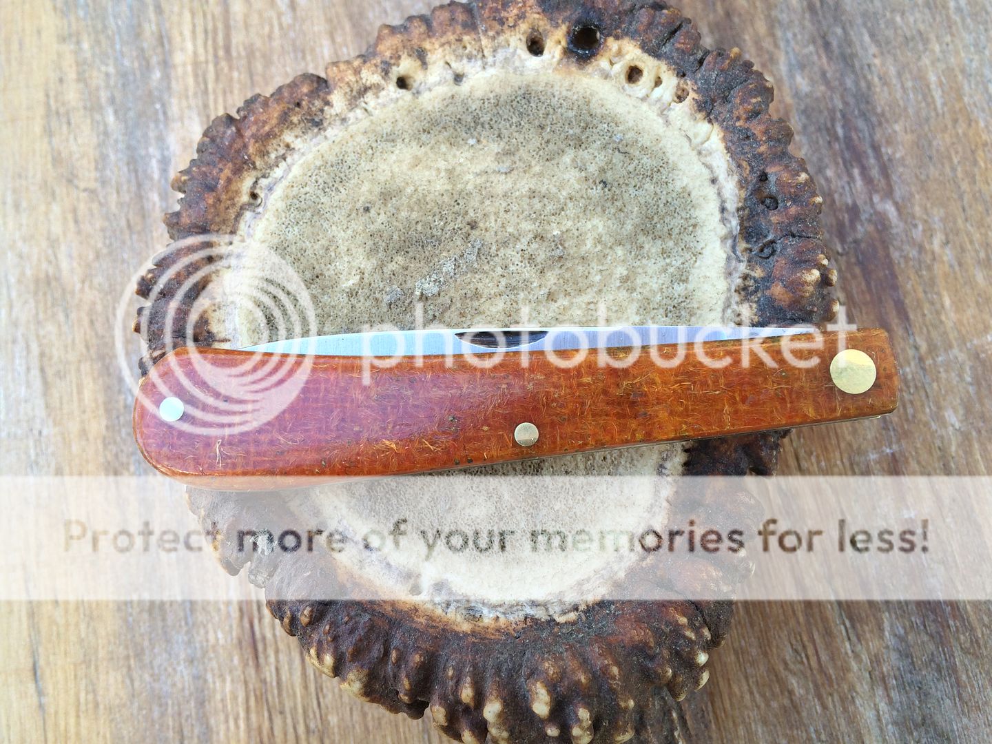

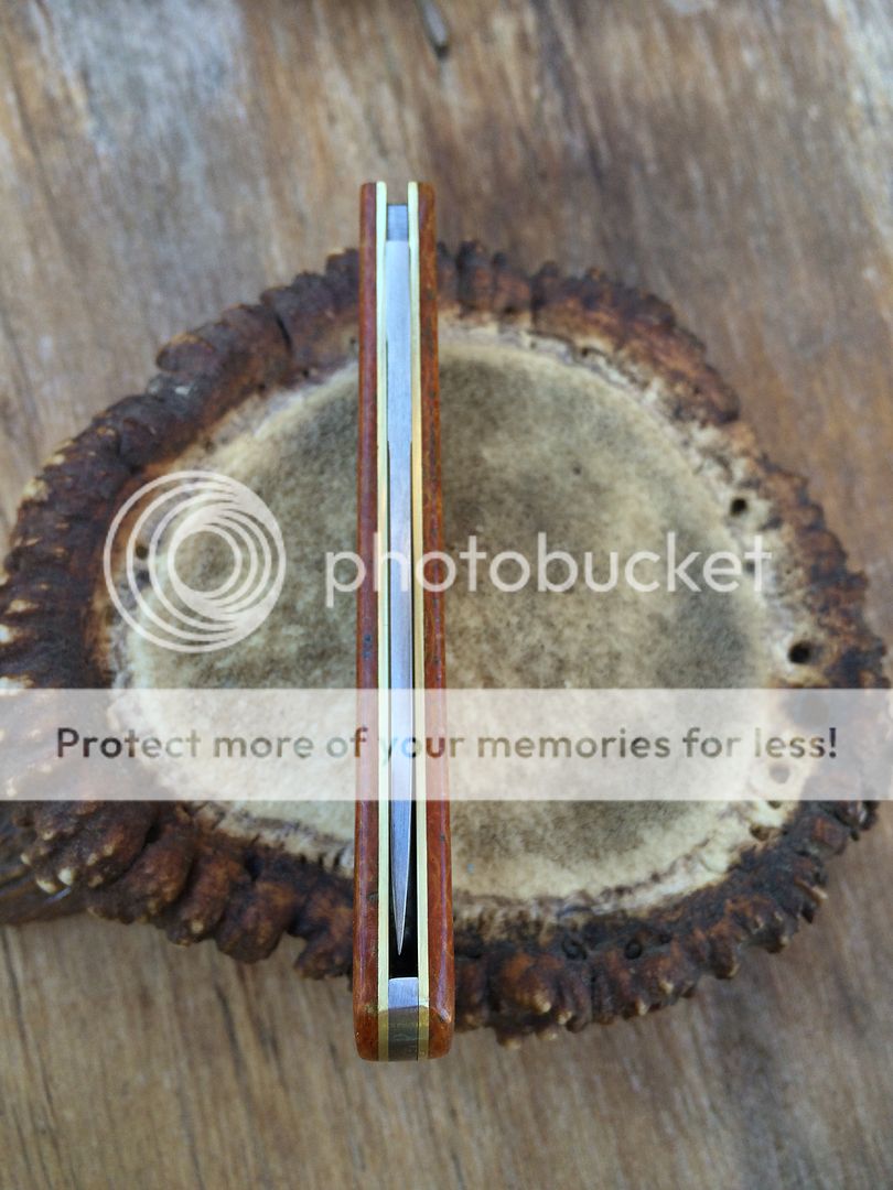

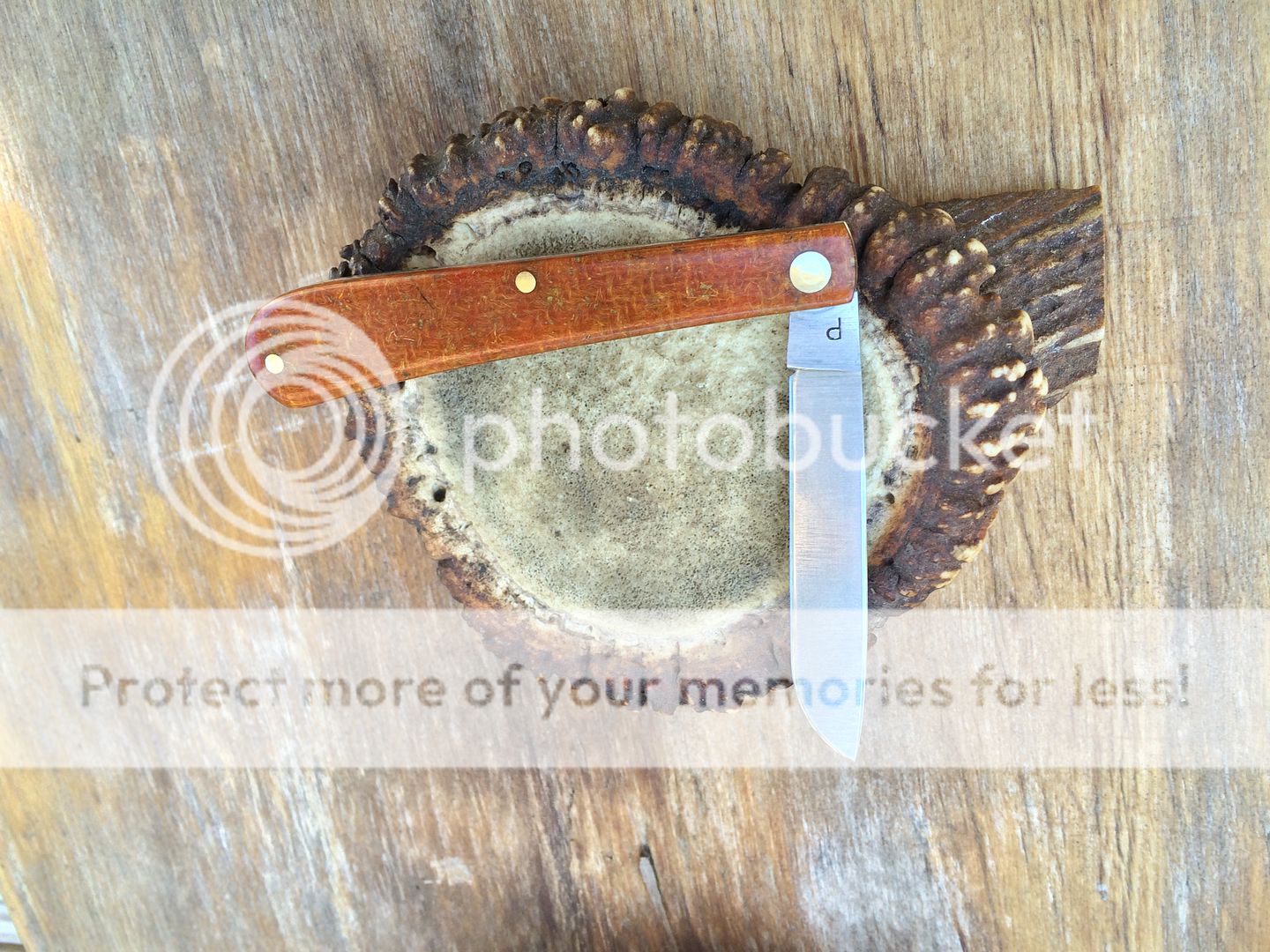

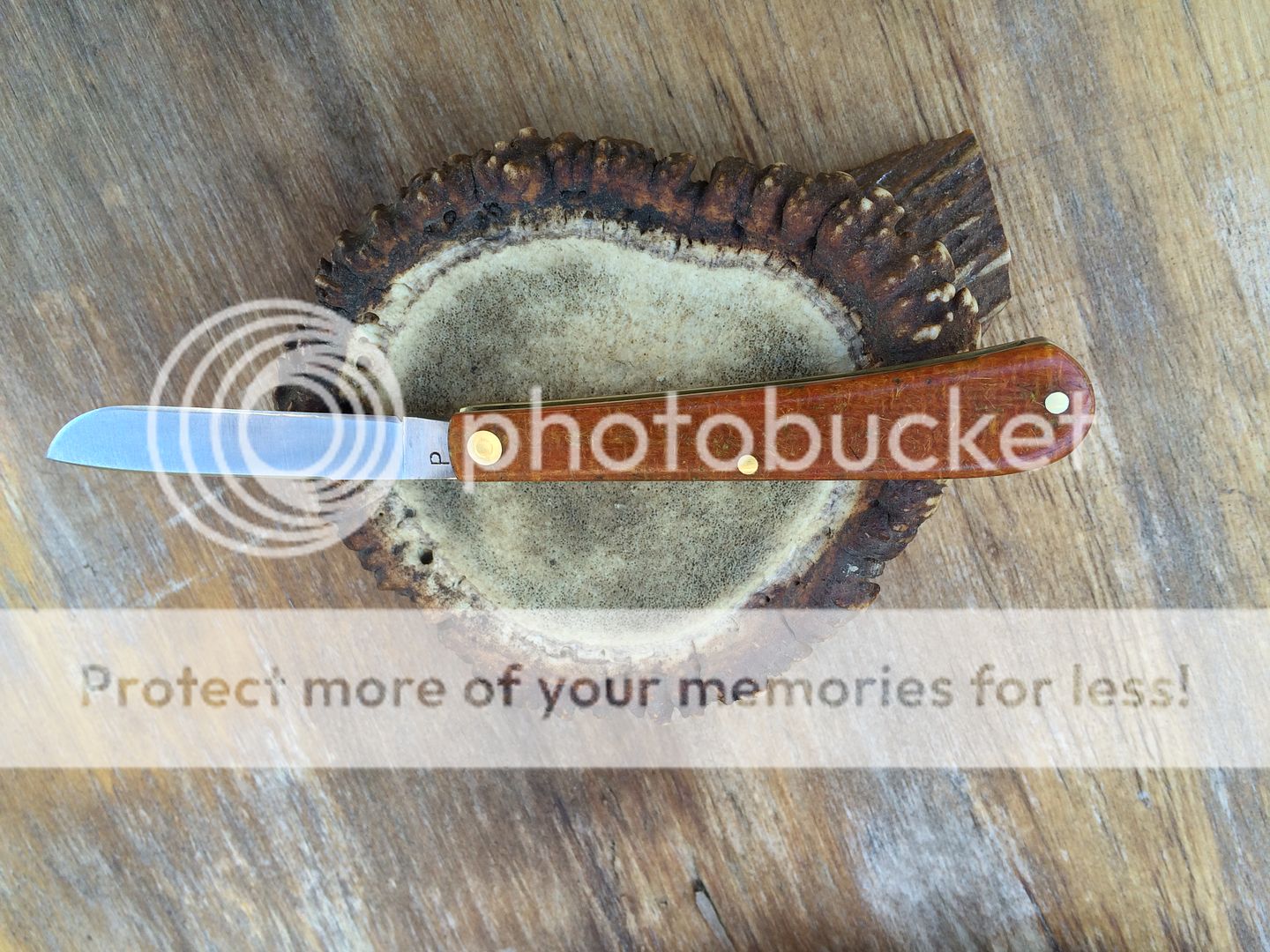

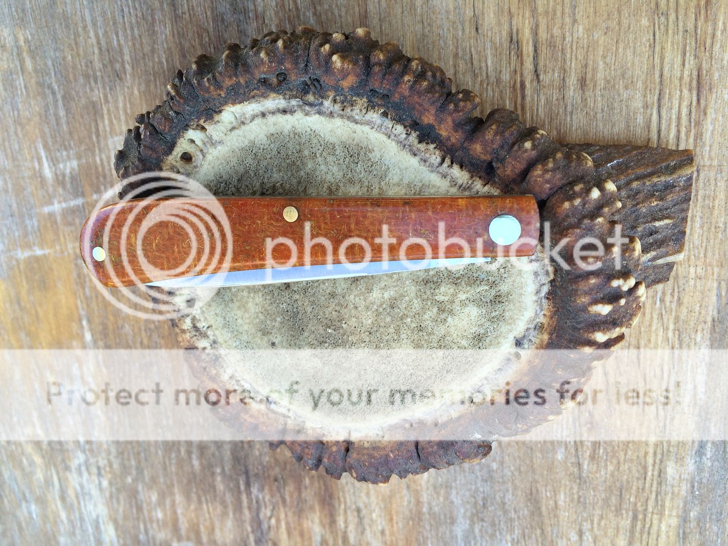

This particular venture had its genesis on the 4th of July 2014.
It will shortly be winging its way across the Atlantic, certain parts of it for the second time thus returning home. It is very special to me for more than one reason.
It has been dubbed by its maker - Mini Soddie.
- 1095 carbon steel
- 3.25 inches closed length
- brass furniture
- and unless I'm mistaken a world first with its covers too
As it hasn't left yet, Evan kindly allowed me to use his pictures.
Evan was great to work with, I'm sure his business will grow and prosper.
Thanks my friend.
Paul

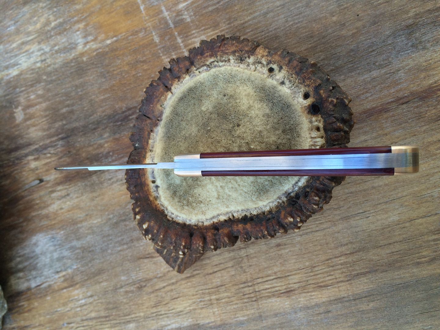

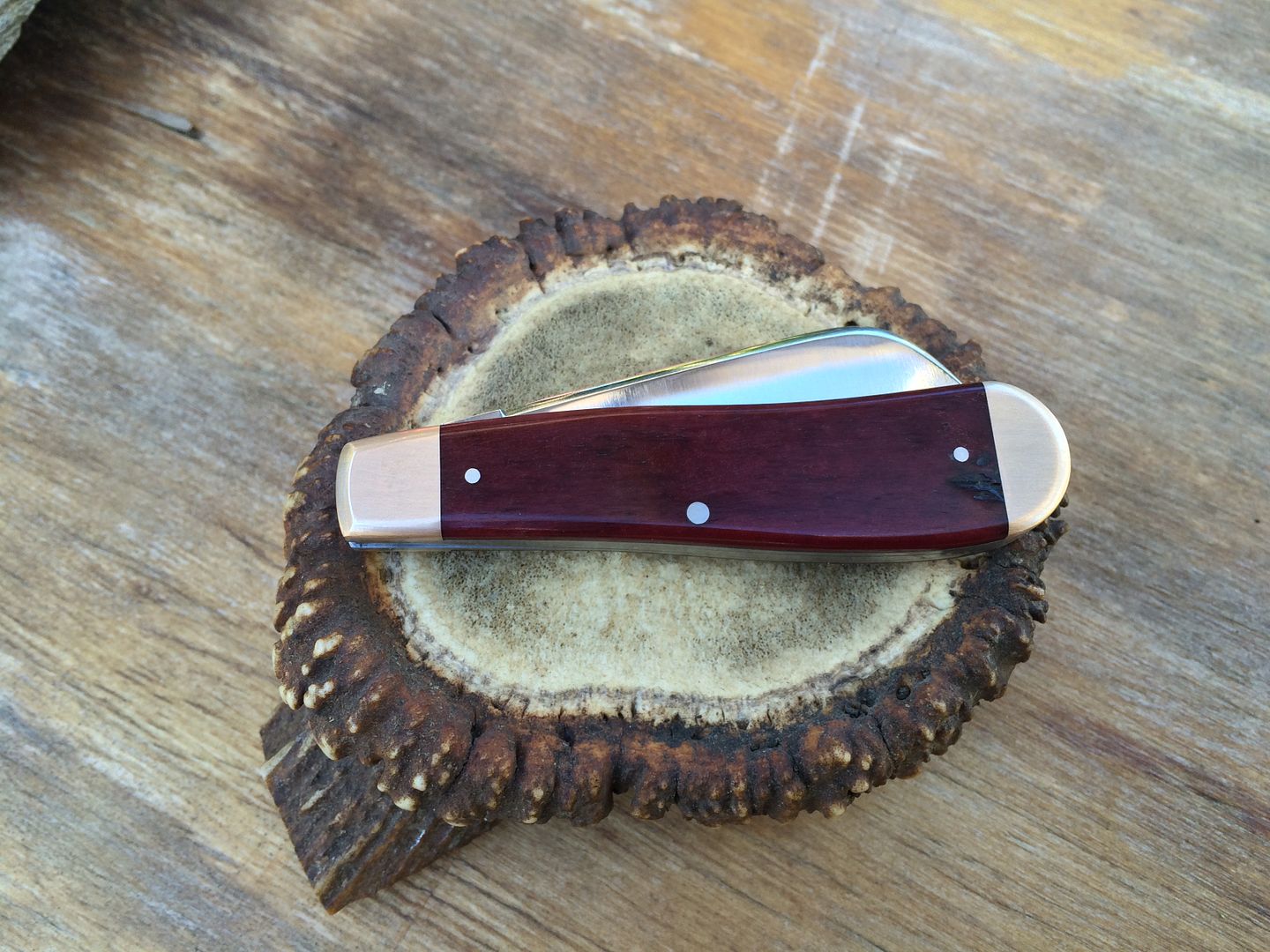

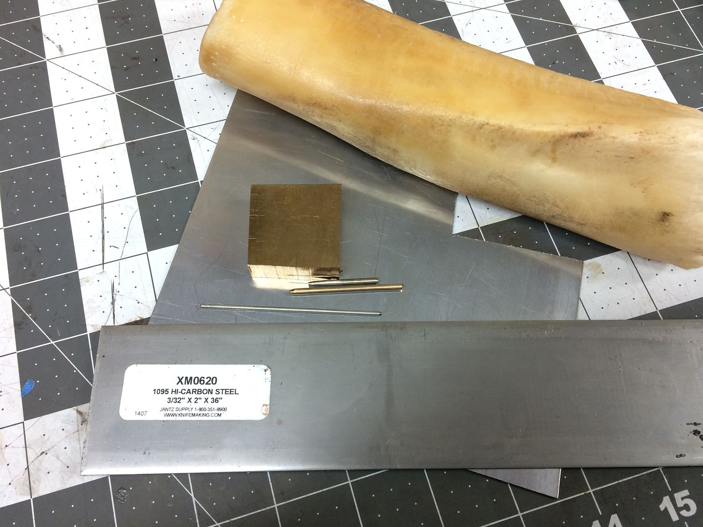

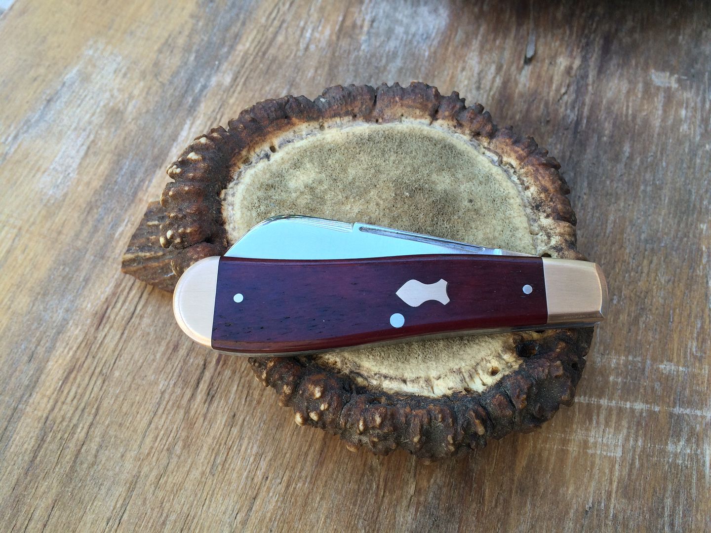

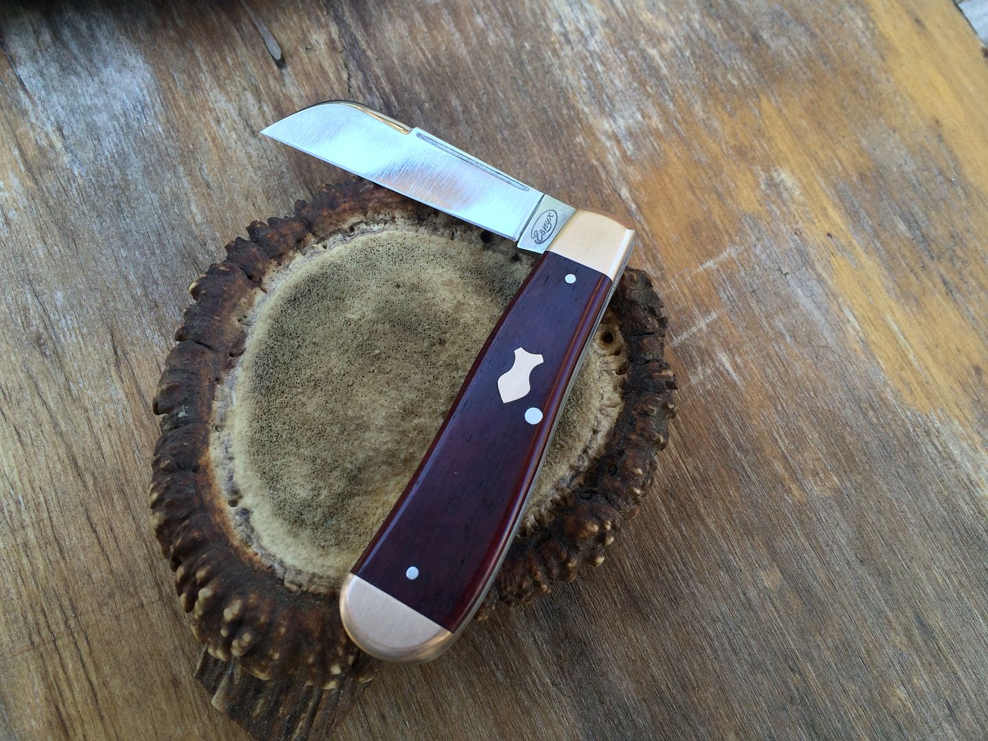

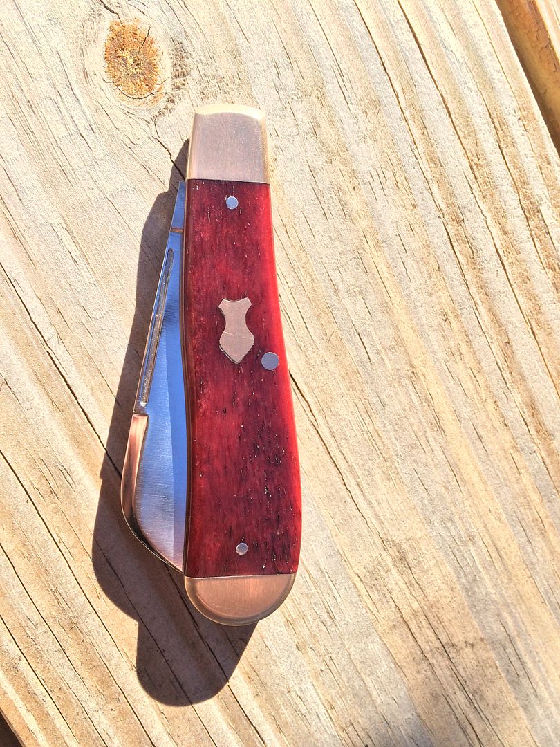

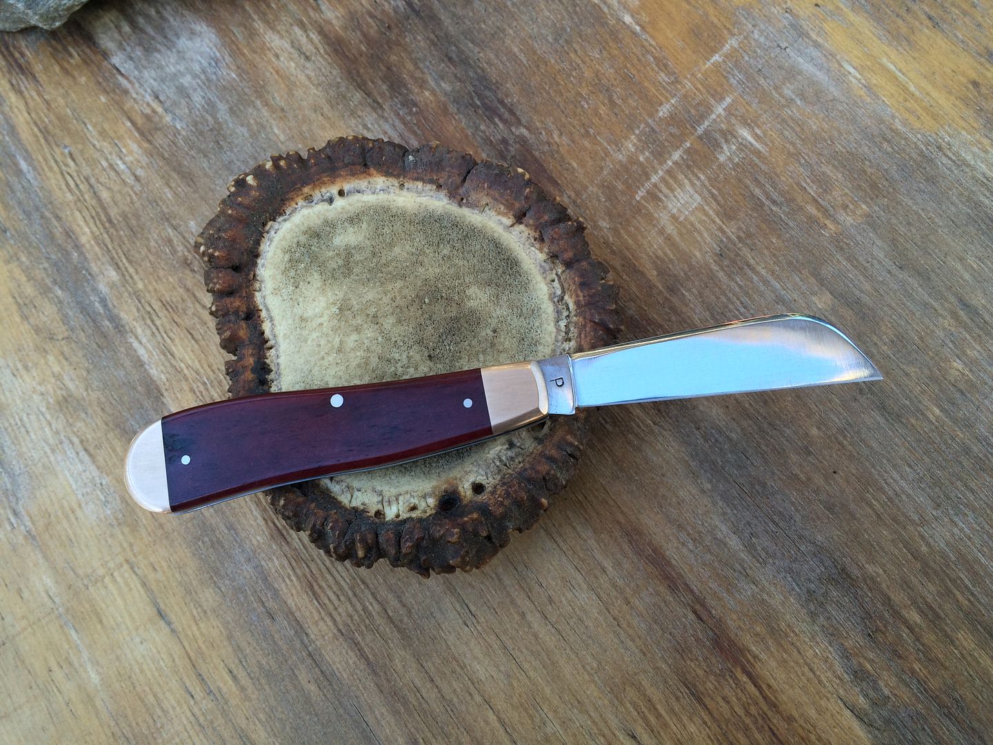

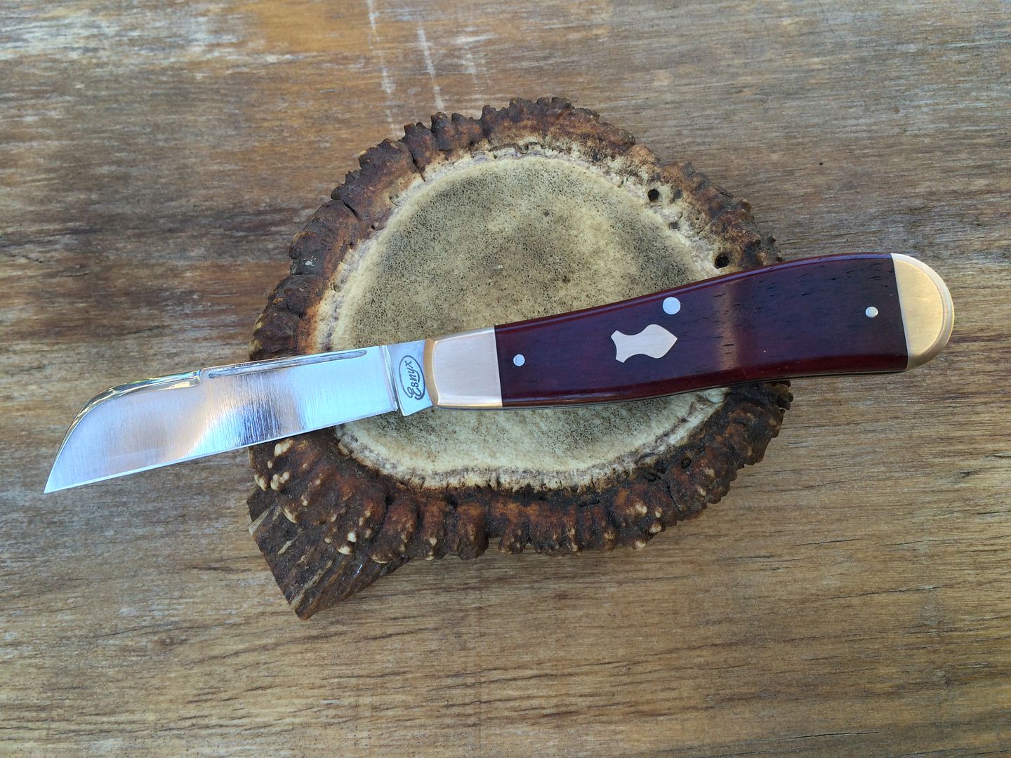

Here is my first completed custom. A reverse dogleg jack with dyed bone scales, bronze bolsters and shield, with stainless liners and scale pins. I cut and dyed the bone myself along with cutting the bronze shield and bolsters from a large bronze bar. The I used 1095 for the blade and spring and had them professionally heat treated. The blade is a rockwell hardness of 59-60 with the tang matching the spring temper at 49, and both had a cryo treatment. This is the same for Paul's "Minnie Soddie".
Well, here she is!
Esnyx No.1
A little soup on the backside:

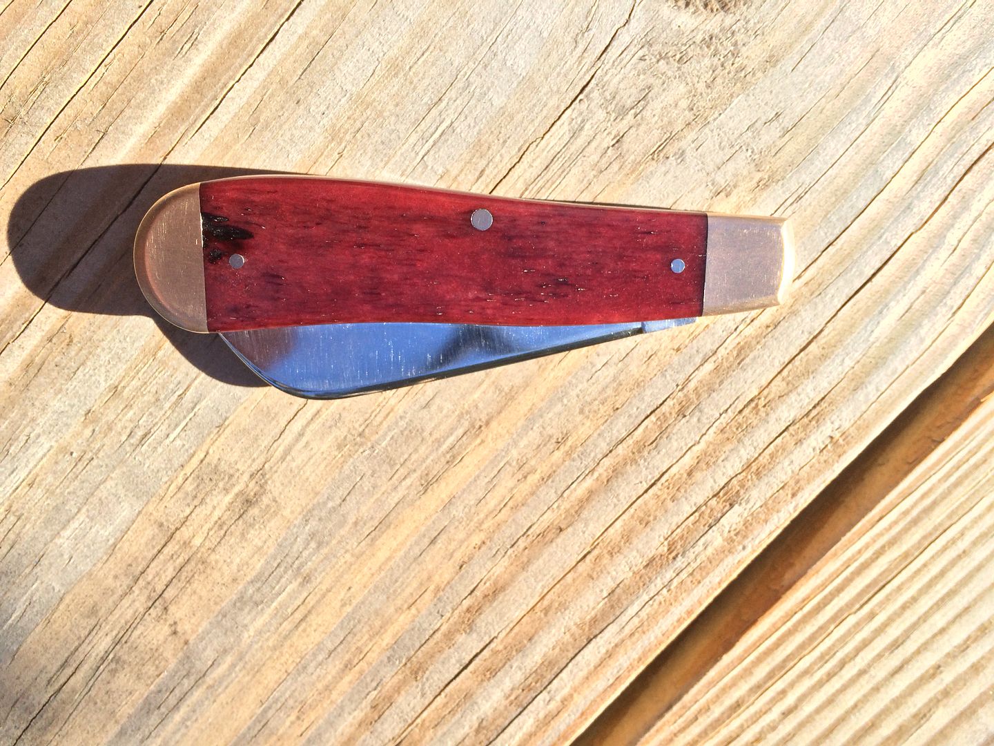

Here are the scales in the sunlight:
Aaaand, the before pic:

Paul congrats, that Mini soddie looks like it is gonna be sweet.
Evan, that reverse dogleg is a great design and looks like you did a fantastic job on your first... Nice!
Great to see this thread started :thumbup: Two lovely knives, which have quite a different look to them I think. Good luck Evan, I look forward to seeing this thread grow over the months and years to come, just as the threads of our longer-established custom makers have :)
I think we have the next great maker in-the-making here, folks. Great looking knife, Evan!
Amazing knives, Evan!
You've got a beauty, Paul; congrats!
- GT
You did a splendid job on the fit and finish on Evan # 1 - nice and tight fit to the bolsters and shield and I love the shape of the knife. :eek::eek::thumbup::)
I was also amazed at the rich dark brownish-red color you got on the bone and it looks like the old Case redbone color to me - really really nice! :eek::D
Now, my friend - rather than just swell your head with all positive comments - I want to add some constructive advice - not from a knife maker - but, from a knife buyer. :grumpy::)
For me personally, I would prefer the blade finish to be a bit less polished, closer to the bolster finish. Others might like the polish better.
The indirect light pictures do the knife justice and show off your work very nicely !
I would suggest you drop the harsh direct sunlight photos - which attempt to show the bone color in sunlight. Let the viewer imagine that and those two pics do not do all of your hard work justice, IMO.
The direct sunlight pics are like putting your work under a microscope (with intense lighting) and I don't feel that fine knife deserves that.
I offered my opinion this way, as you have previously told me that you welcome constructive critiques. ;):)
I can only imagine how hard it is to make a knife that well. :)
Overall - I really like the knife and the soup, just really nicely done! :)

Primble, thank you for your advice. It will be taken into consideration, and it is greatly appreciated, as always!:thumbup:
