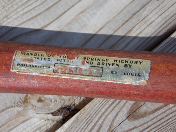

Yes, they are red and gold.. The sticker on the handle reads.. Handle of tough springy hickory tested, fitted, and driven by Plumb.

Here is the exact label on the haft of my axe. I could only make out part of the words on my label, then I found this axe on another site and put the two together. It reads: Handle of tough springy hickory, tested, fitted, and driven by Plumb.

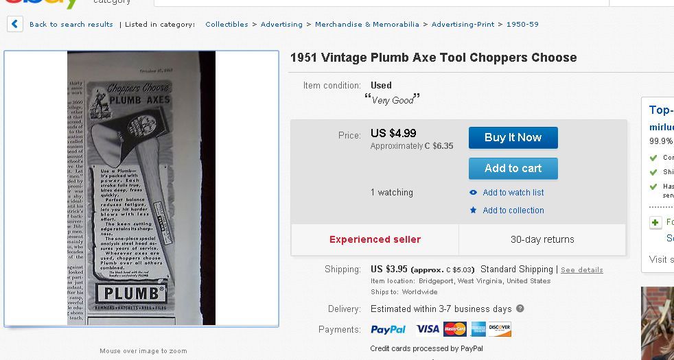

I found that sticker on a early fifties advertisement on a auction sight. I linked it yesterday but my post is gone. Current auction so I may have broke the rules. And my post being deleted.
If so my apologies to the managers of this sight. I meant no harm and had nothing to gain by linking it.

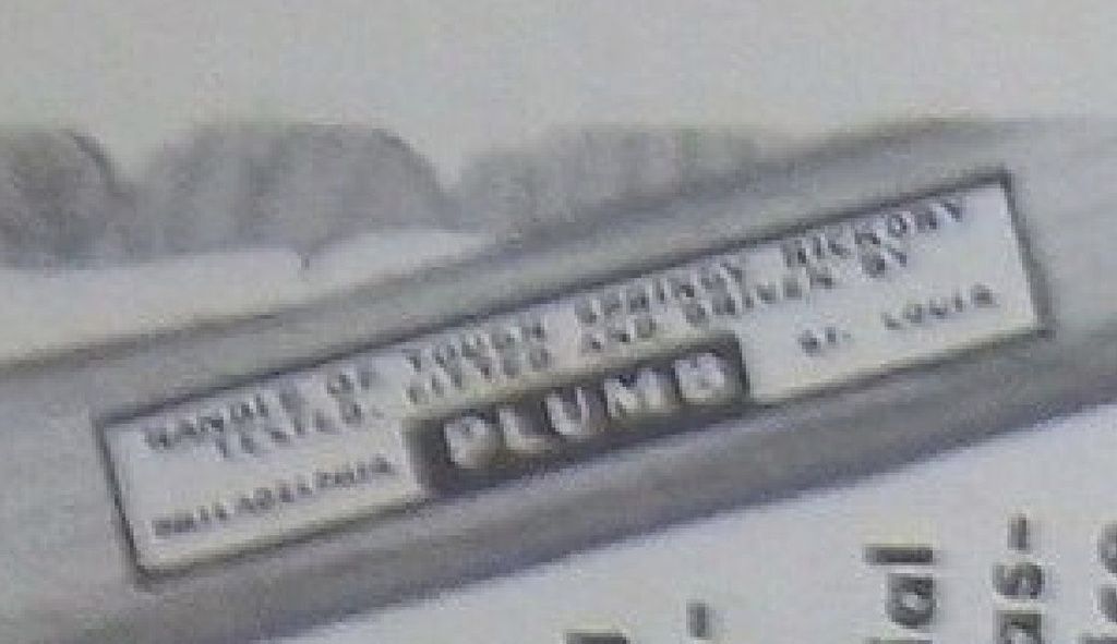

Follow to my previous post. Here is where I found that label.
