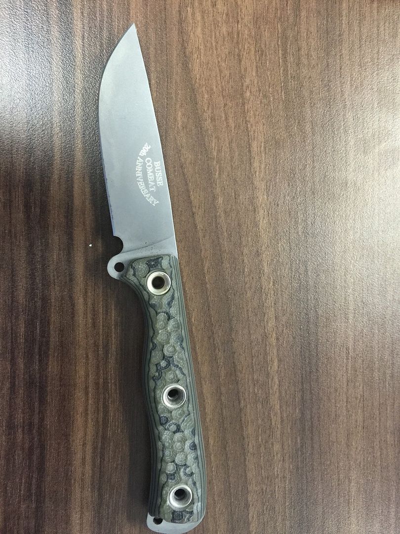

Etching and stripping a NMFSH:
Using Sodium Persulfate (called "PCB etsepulver" in Norway) to etch the logo. I let the solution work for a couple of hours.
Beeeaaaautiful crinkle coat.
Micarta after a night in Duxola paint remover.
Etched logo
Not sure what to do about the finish. I may end up taking it to be bead-blasted.
Looks great. Thanks, Sir. From a member of the Engebretson family...;-)

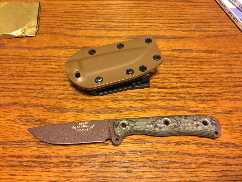

I've posted this before, but just incase anyone missed it, here is my AMS.
before:
during:
after:
I just left the decarb layer on it, looks like a poor mans double cut :D

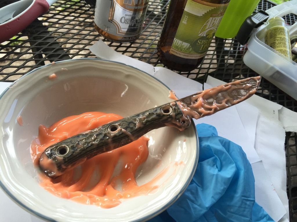

Took about 4 or 5 soakings in citristrip and brushing it with a toothbrush to get all of the coating off.
