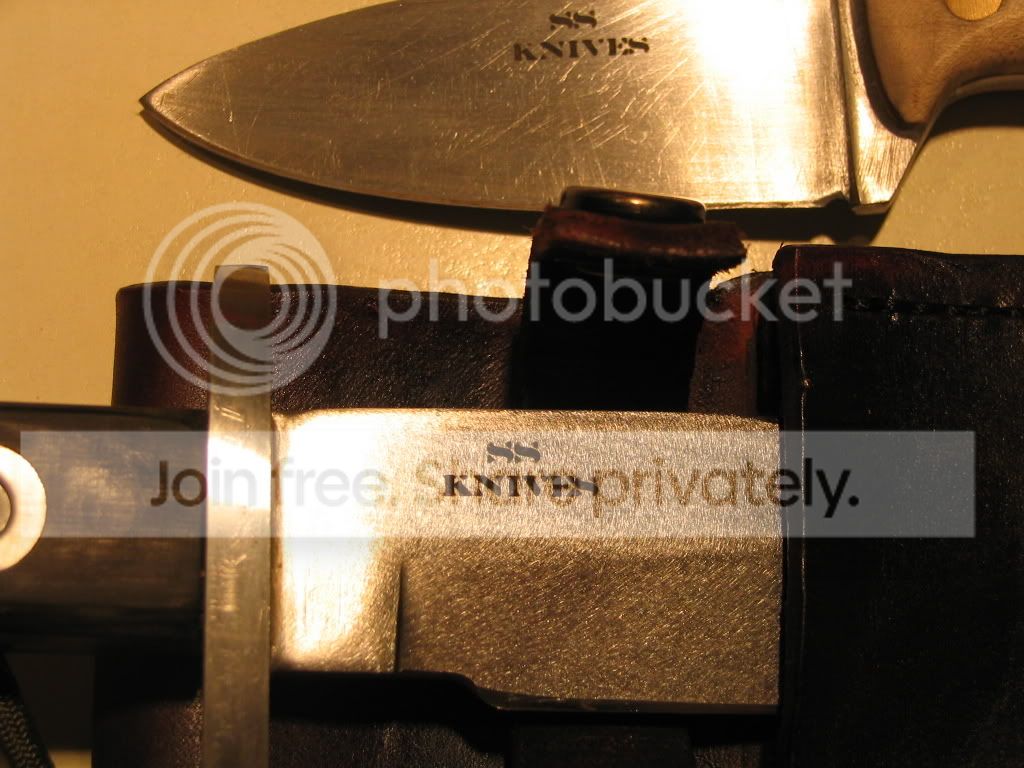

just got the kit in today. got it off of fleaybay for $54 including shipping. took about an hour from start to finish, including making the stencil. sweet...top knife was a practice knife before i knew about knife steels. made out of mild steel. other is a randall copy of an Astro in 01. just finished the sheath for it yesterday.

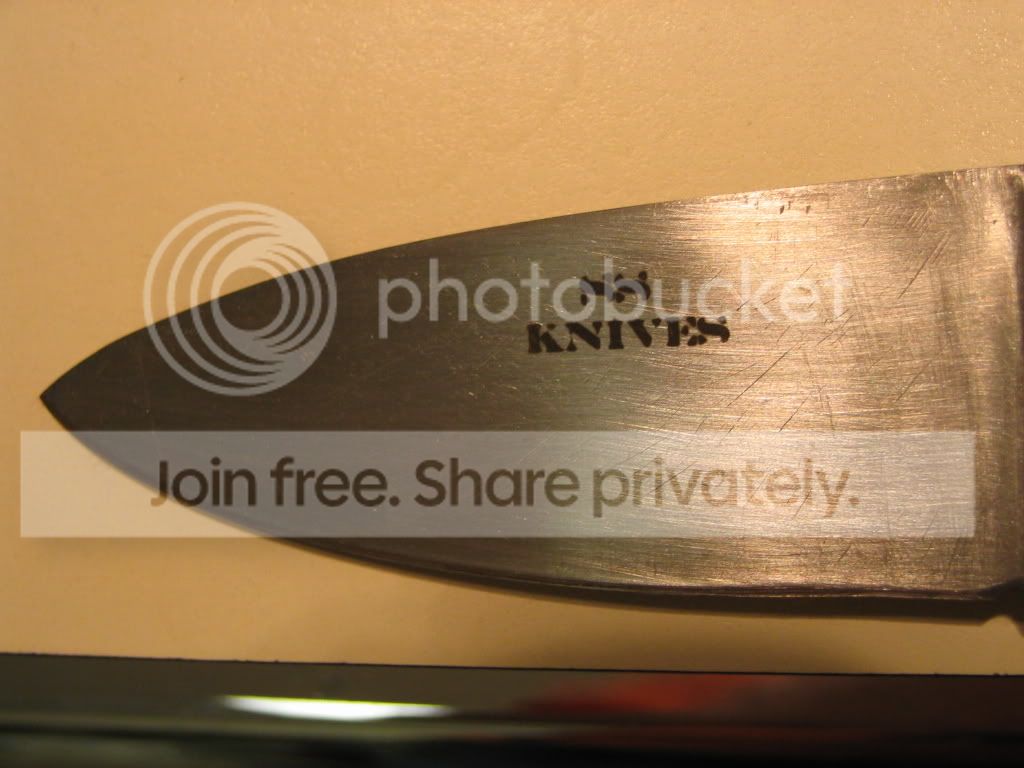

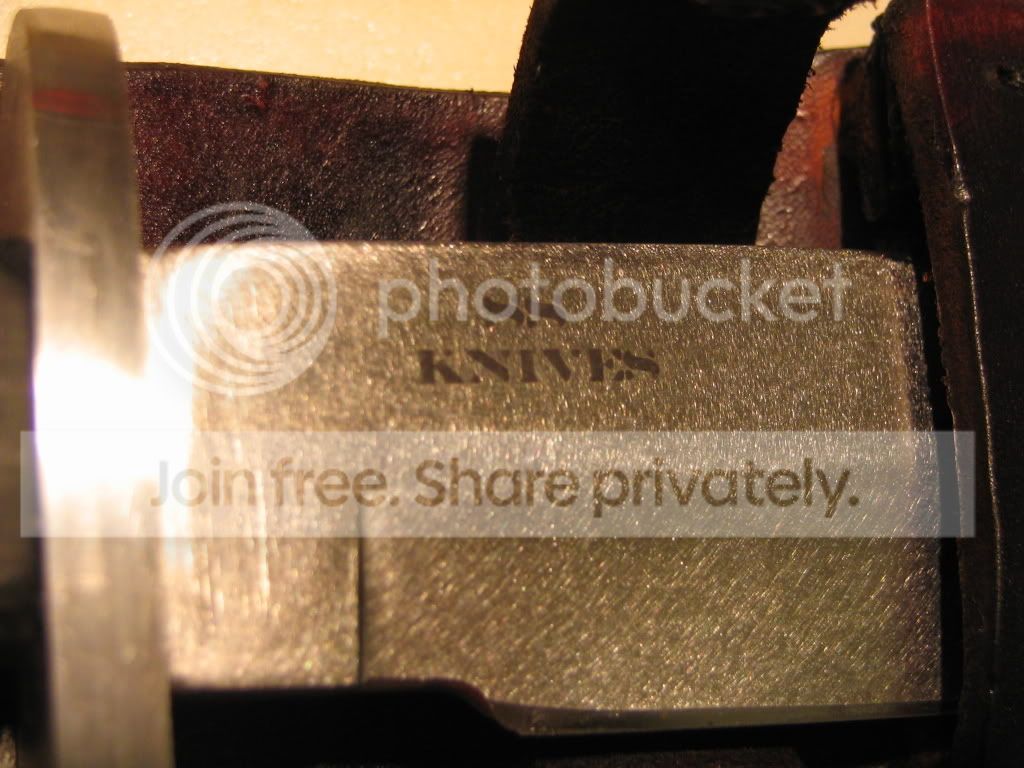

i think i will change the type of font when i make my next one, but overall pretty happy with the results..
i didn't think it was too bad for my first try at it. can only get better, right? need to play a little more with the MS word, and come up with something a little more fancy for the next one...
