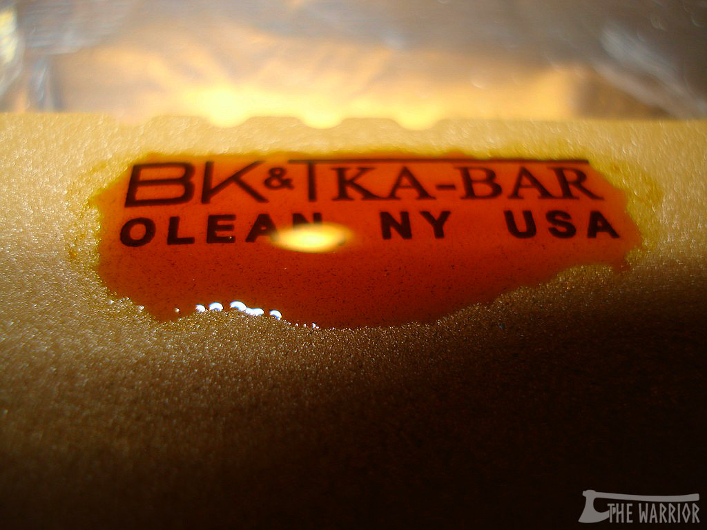

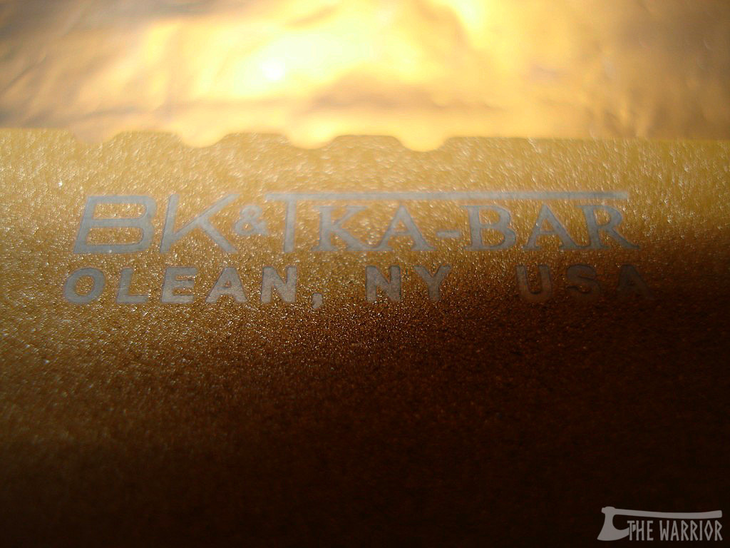

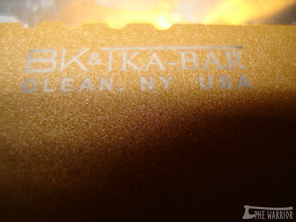

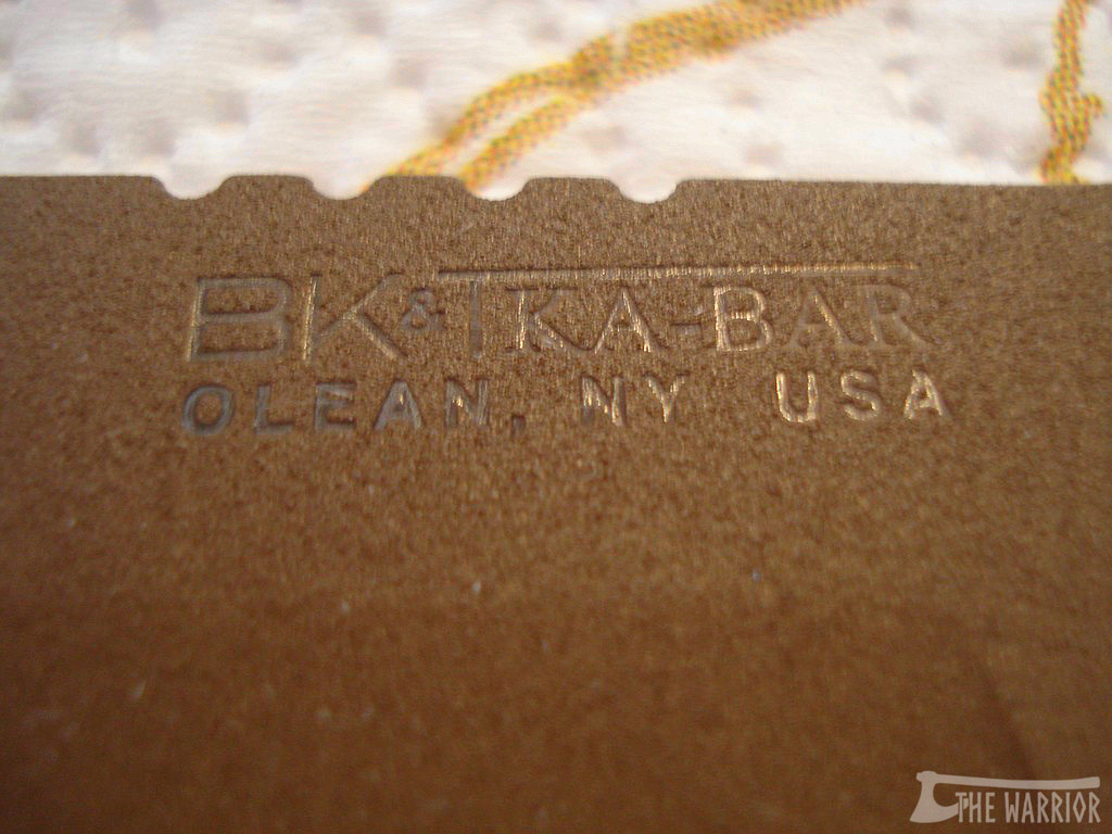

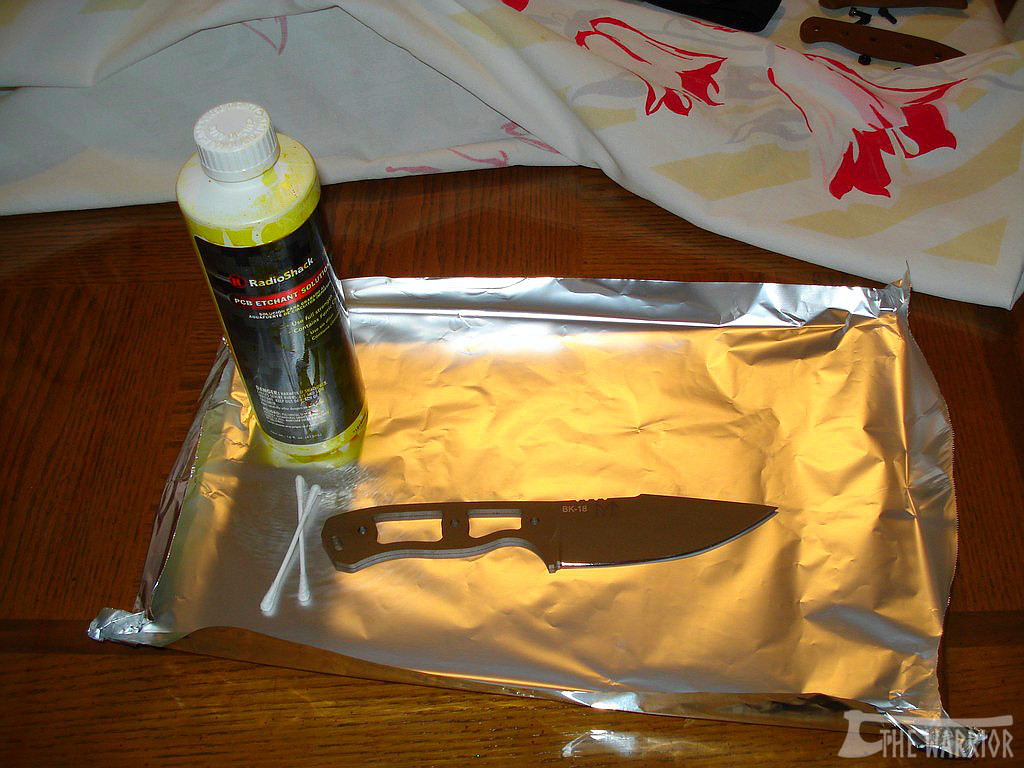

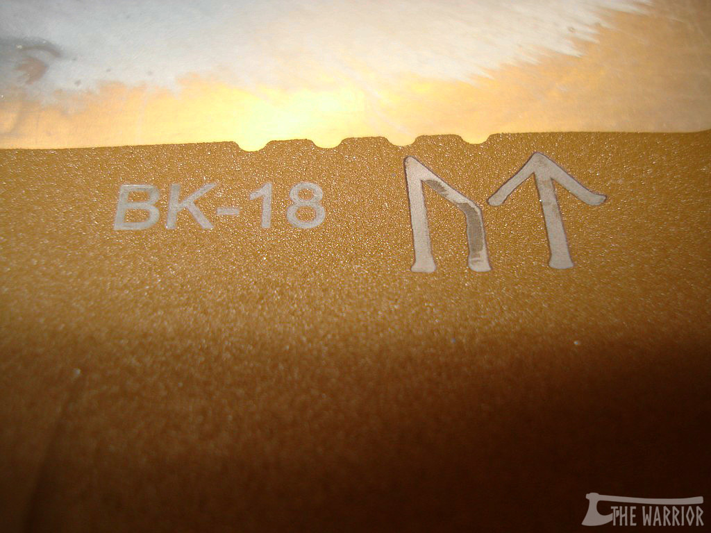

Worked on etching my 18 a few weeks ago, decided to finish it up on this fine snow day. Had a few problems I've never encountered before etching. This is from an old tutorial 91bravo 91bravo did some time ago.
Setting up for it. Radio Shack etchant:

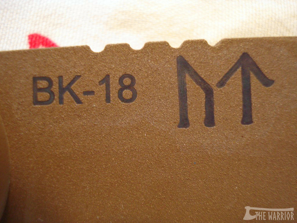

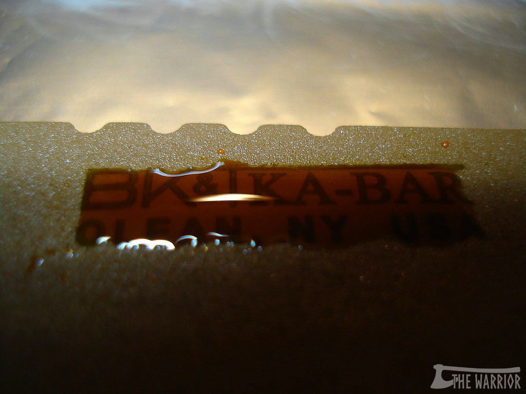

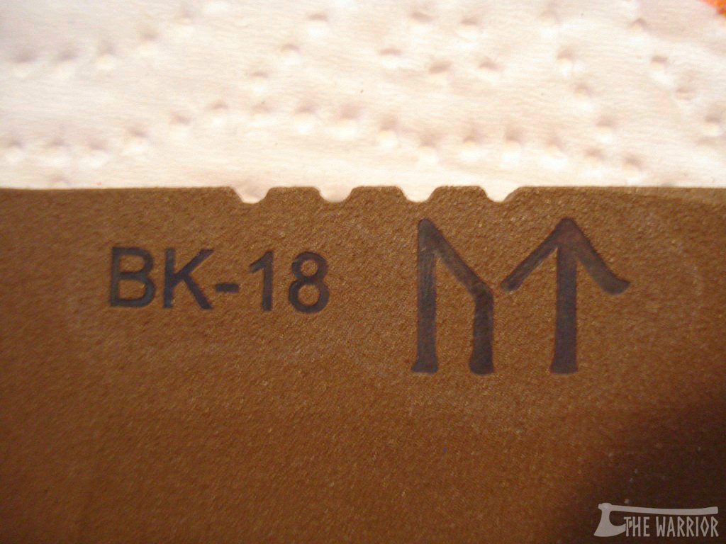

Started on the BK18, Rune side:
After an hour session:
Reapply, etc:

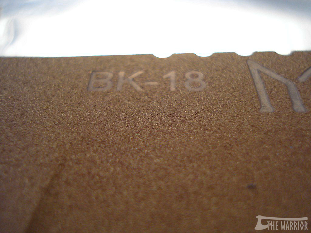

For some reason, after 4, one hour sessions, it seemed to not etch as deep as I remember.

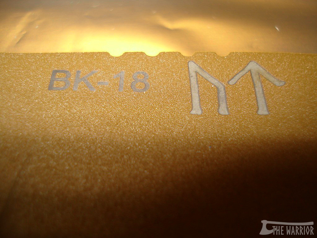

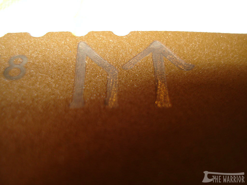

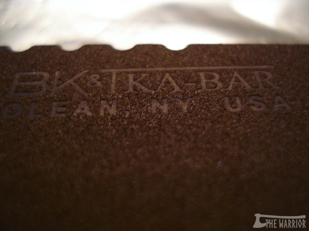

Other side:
That side seemed to do better.

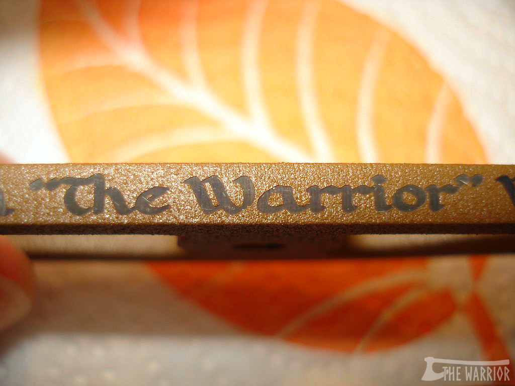

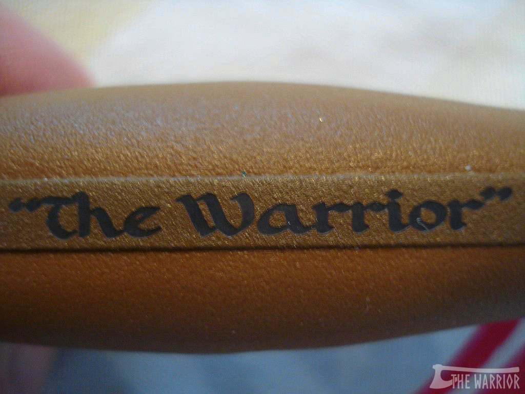

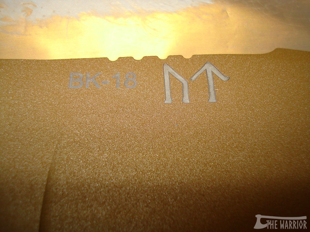

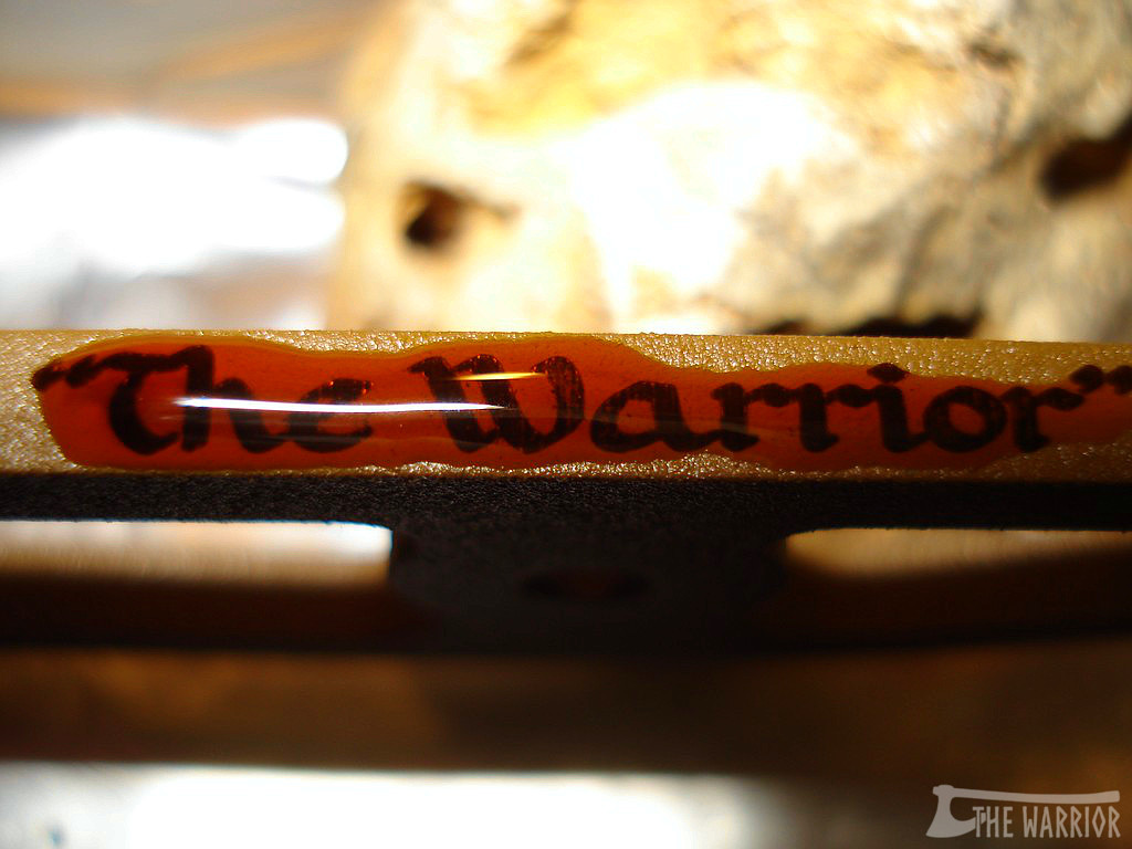

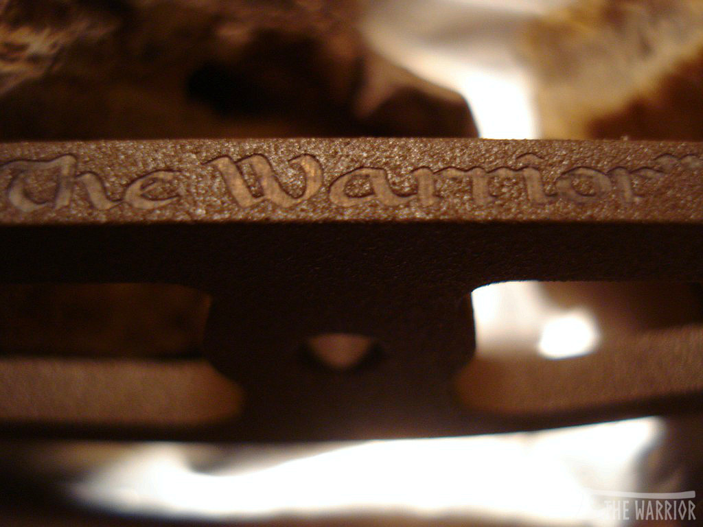

Spine:
That side seemed to do well also.

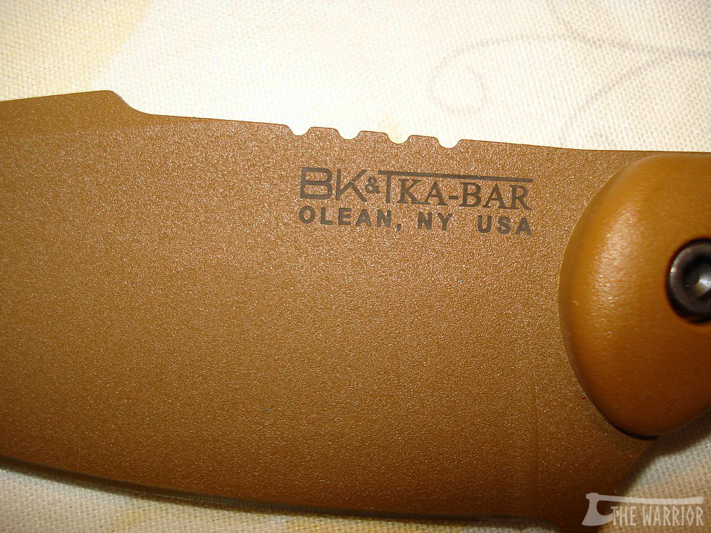

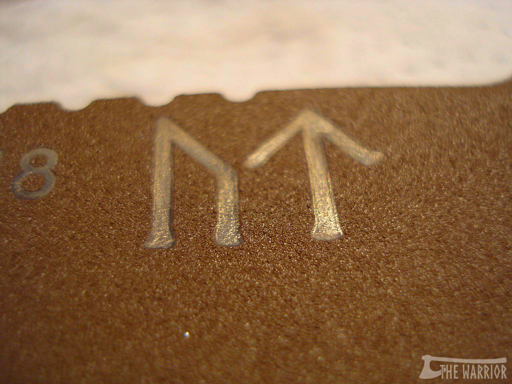

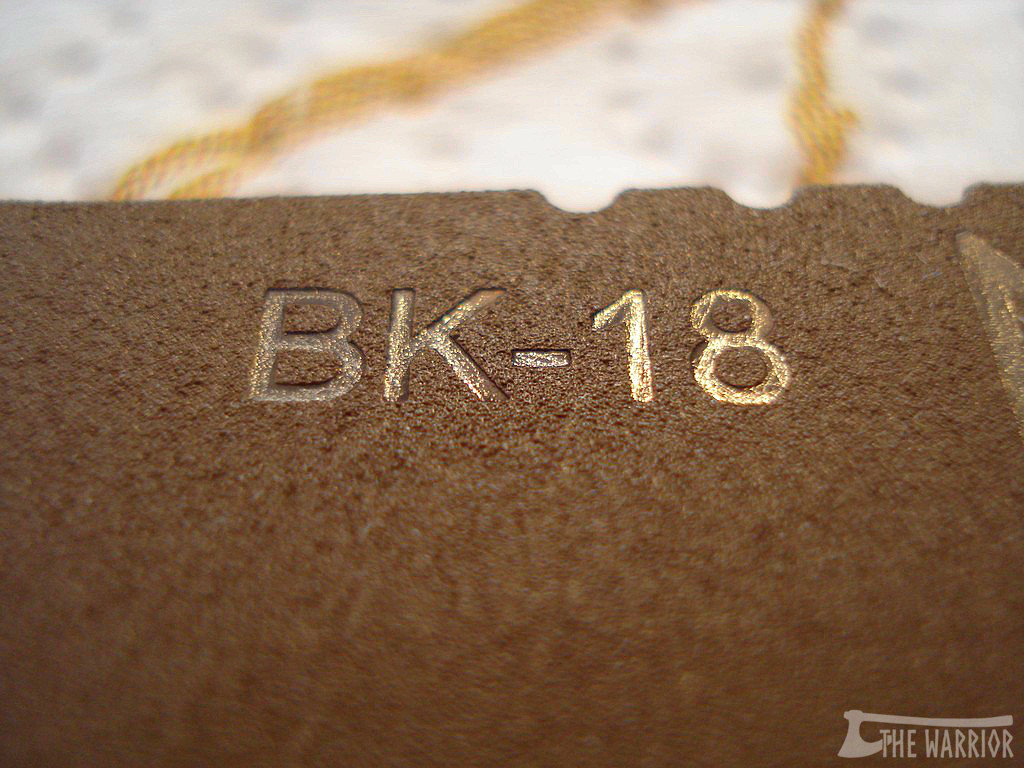

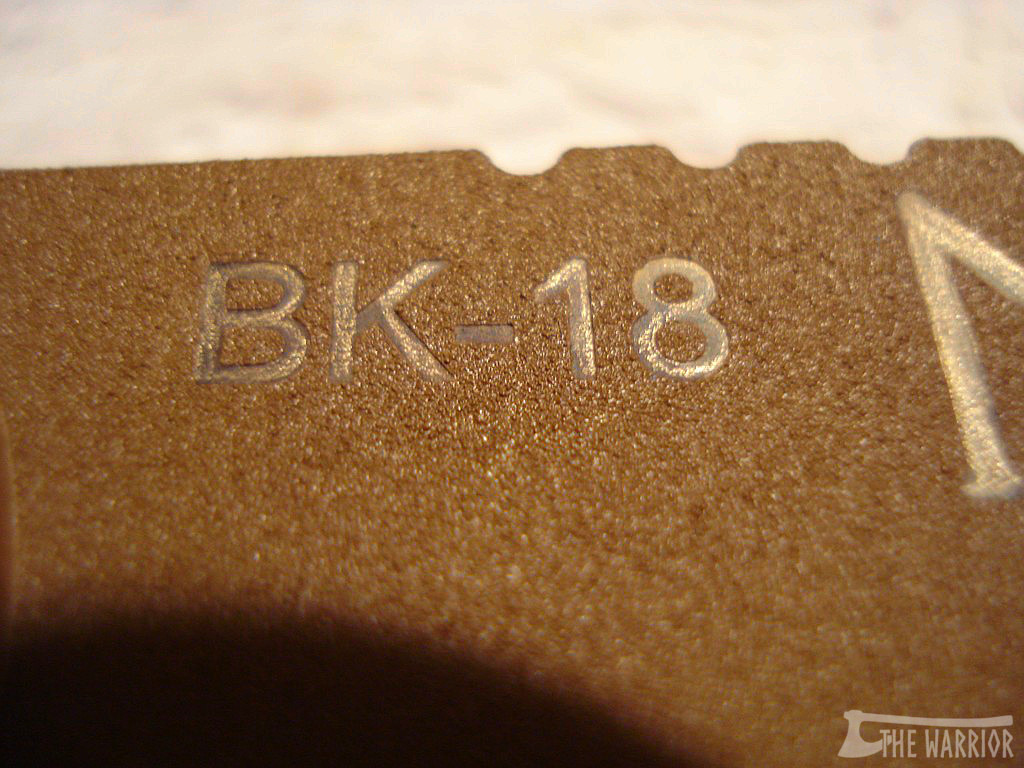

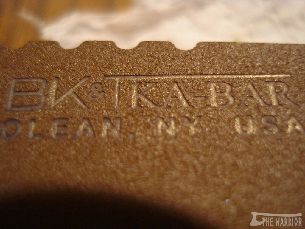

Today, I cleaned the logos best I could, then did a few more sessions per side. The results:
to be cont...

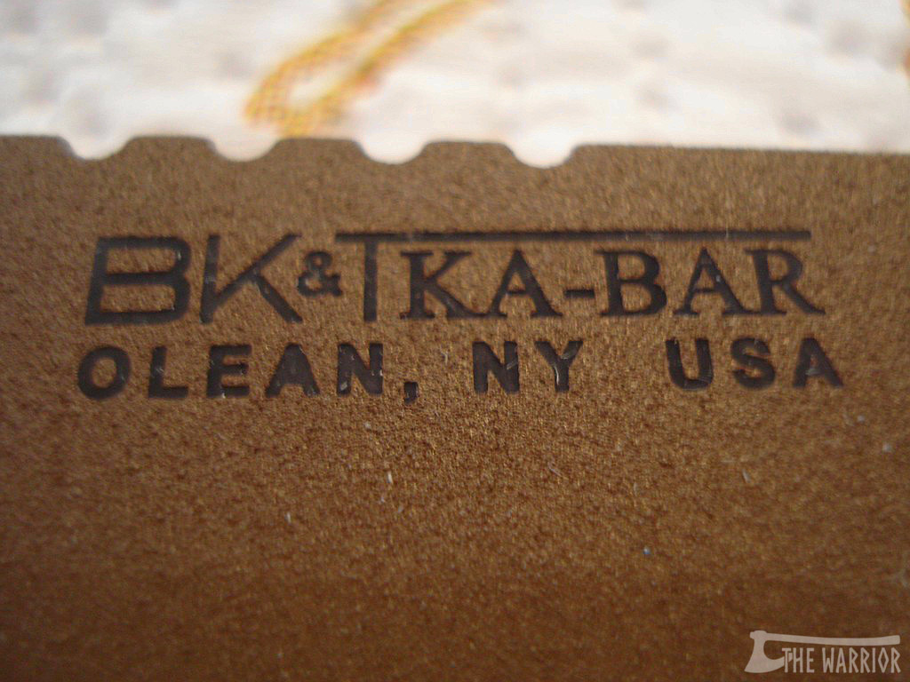

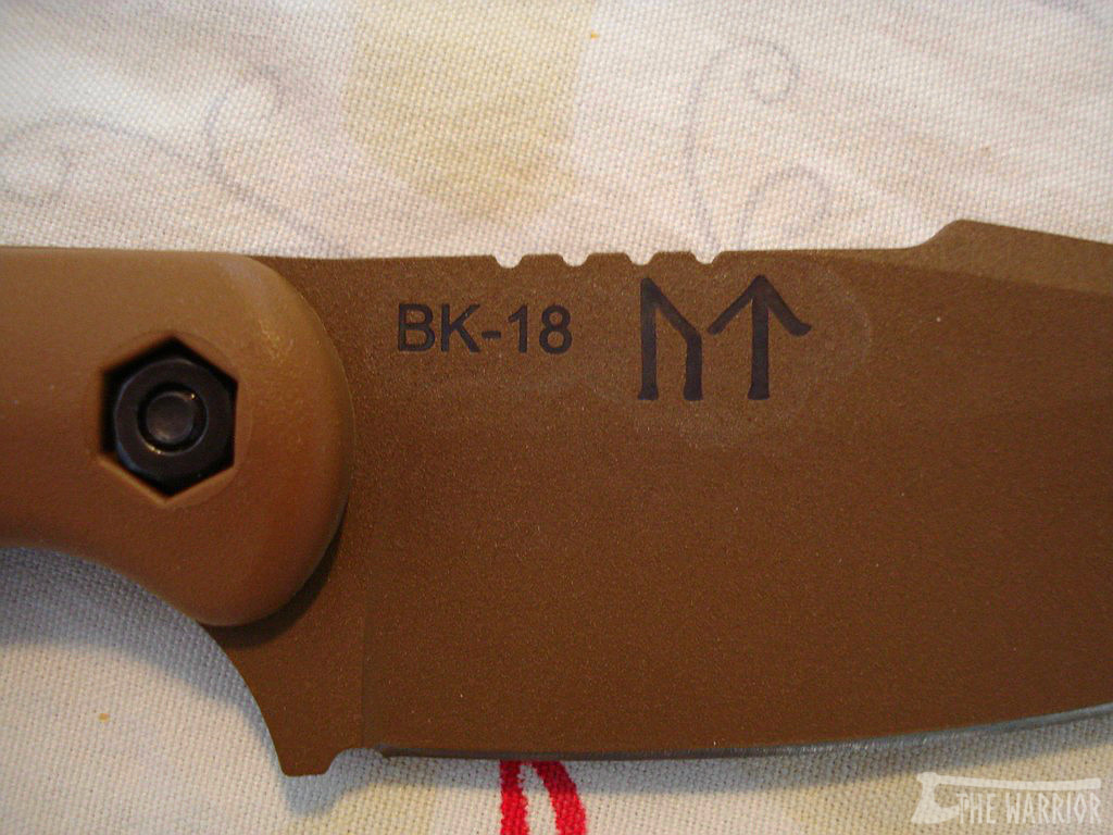

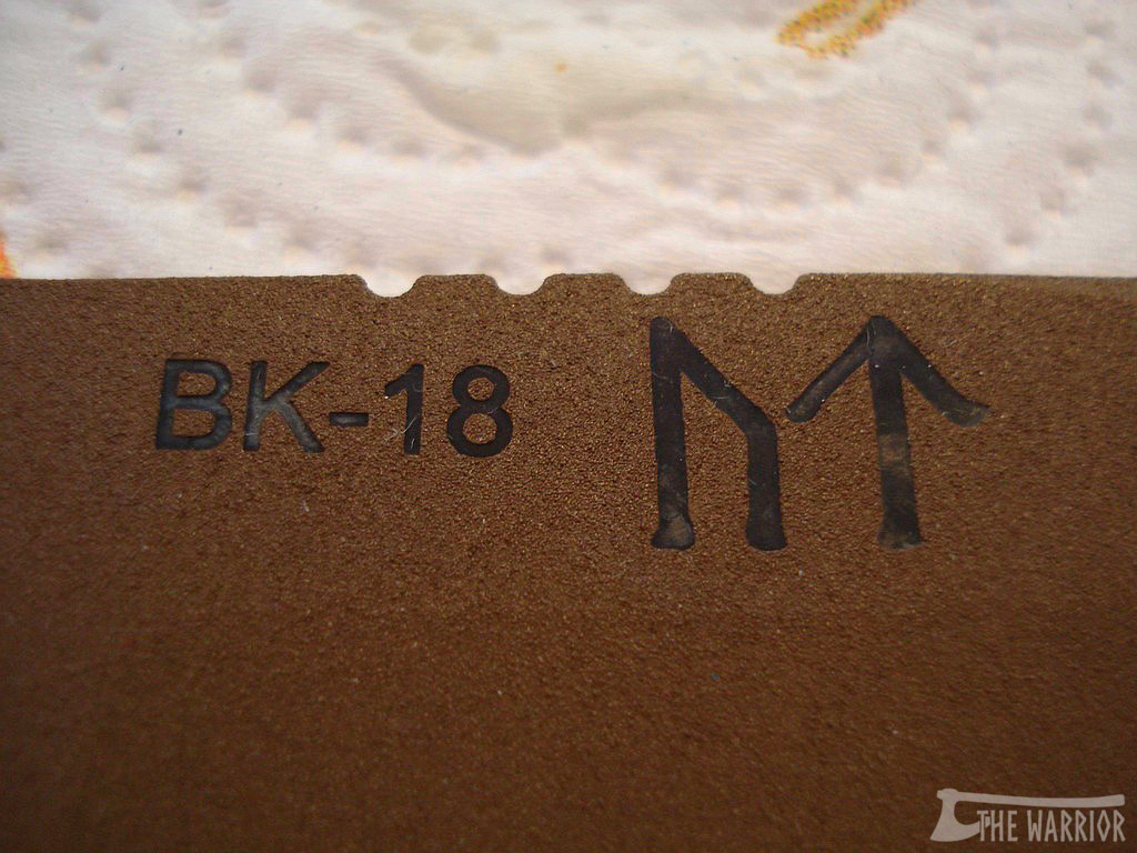

Finally, I applied gun blueing to the etched logos. Some of the shots have paper towel lint in them. Also, most of my photos really sucked:

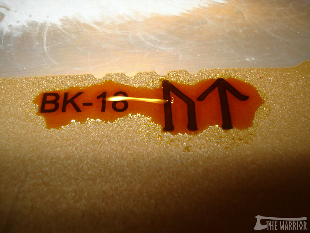

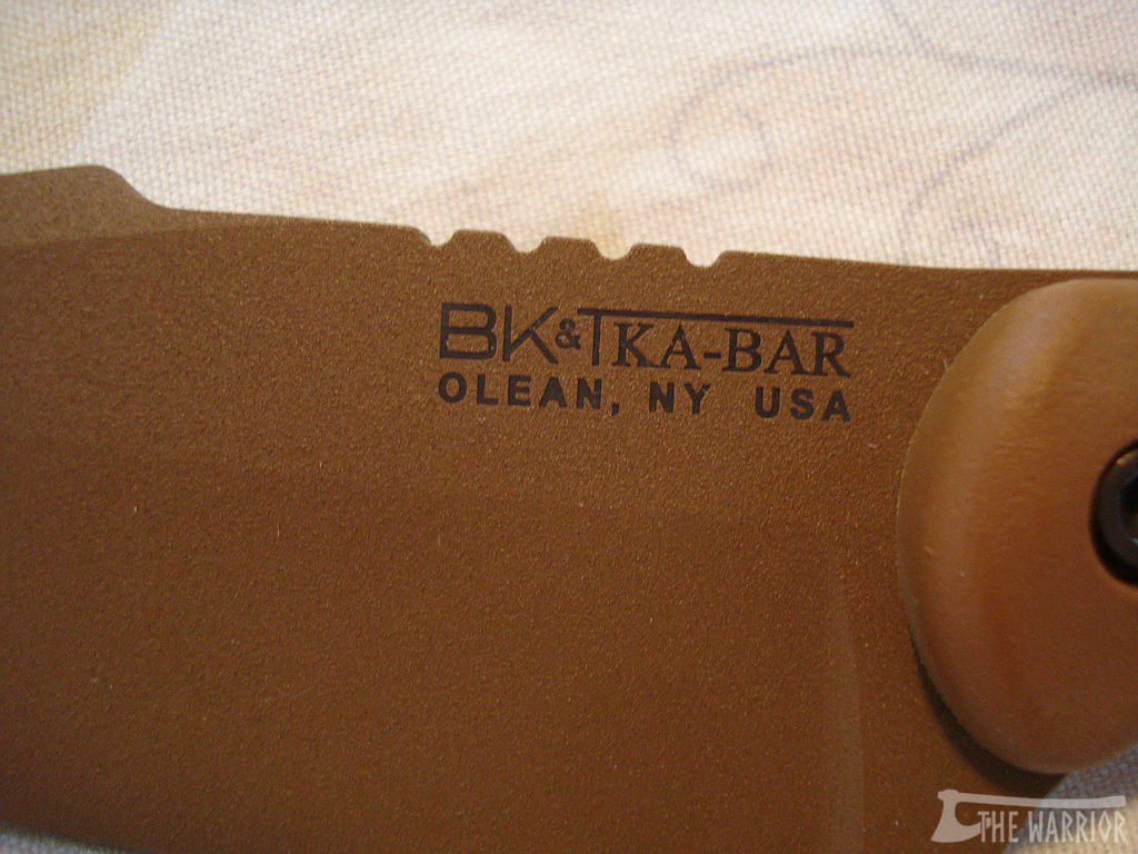

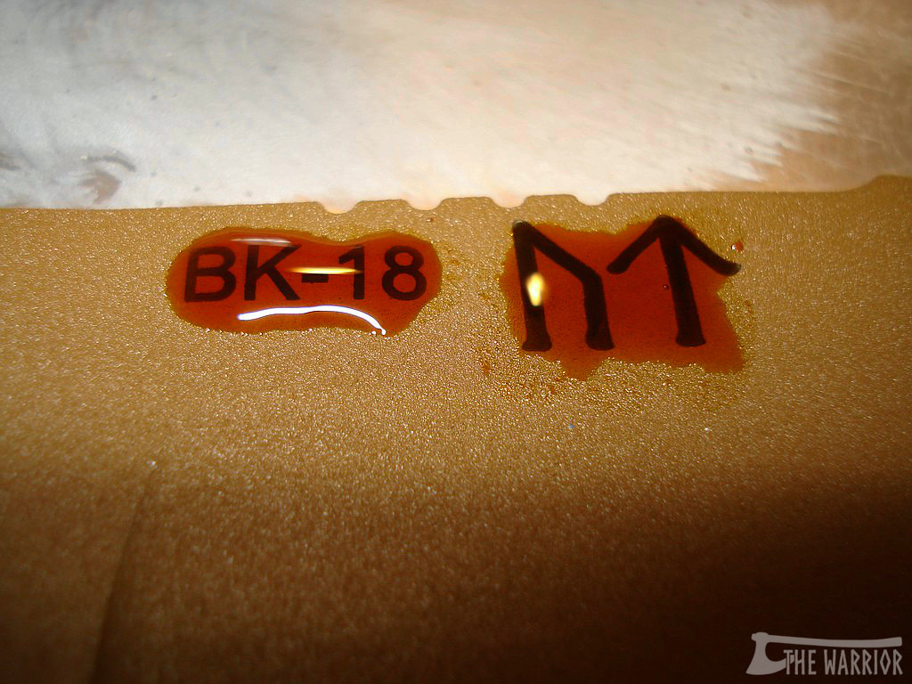

Turned out fairly nice. But when I did the BK18 side, the one that seemed difficult to etch, it wouldn't take the bluing very well. I cleaned them all very well before bluing:
I cleaned and reapplied several times. You can even see where I left the bluing on it for a few minutes. It seemed to stain the coating:
Anyways, these are the final results:

That looks good Warrior! In between etching sessions, I used a steel bristled brush to really brush out the logos. I learned how to etch using a 9v battery and some salt water and can etch in half the time now. I need to write up how I do this. It's so easy a cave man can do it!
I used a tooth brush, with dish detergent, then alcohol between etchings. When I did my RAT 6, 4 hour sessions, the etchings were deep.
Etching is weird sometimes. I've run into the same thing you have etching some Beckers before. Some etch really well, and some not so well. You just have to keep going until it's as deep as you like it.
How did you do the rune etching and your name on the spine?

Thanks man. I may try to give the BK18 side a go again, just not satisfied with it.

The PCB gives a nice smooth surface looking at the result. It may be deep enough. 9v and saltwater gives fast results but not as smooth a surface.You don’t notice it unless you look up real close. But less than 1/2 hour both sides plenty deep. Maybe next time if you want a faster way :)

Your 18 looks Great :thumbsup::thumbsup:
You can see how deep the etch was after 4 or 5 one hour sessions on the RAT6:
I did my esee 3 with a battery and salt water just yesterday
I was going to strip the coating off anyways but it discolored the coating badly so I wouldn't have been able to leave it nice like how yours looks.

The coatings are so thick it can be deceiving. Make sure you go a little below before stripping it .
