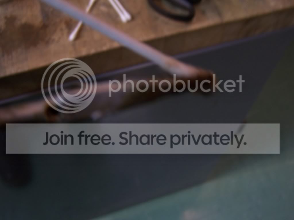

I tried making a felt marking pad for the Crawford etcher, but I found that it just worked better for me to use q-tips in an alligator clip. I dip the end of the q-tip in salt water and dab off the excess, clip the alligator clip at the top of the wet cotton, and touch the wet cotton end located below the clip to the stencil. My method involves repeated short "dabs" of the q-tip to the stencil/steel. This allows plenty of gassing off and prevents heat build up. I just work evenly over the entire stencil, flip to AC and do the same (with a clean q-tip), and then I'm done. That just worked the best for me overall, but I know a lot of makers who use the felt marking pad.

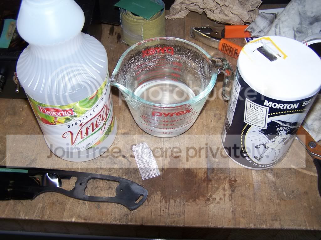

Rusty are you using vinegar and salt instead of water and salt? Or mixing vinegar in the salt water?
You should not be using any acids (or basic 'acids') with your etcher at all. No FeCl no vinegar, etc
An electro chem etcher works using electric current through an electrolyte (a salt water) The stencils are not meant to be used with anything other than a simple electrolyte. One stencil can make hundreds, if not thousands, of marks if used right.
A simple table salt water solution (NaCl + H20) works fine for most people for many purposes. Specialized electrolytes work better for certain steels / stainless steels. I buy my electrolytes from tustech (they make my stencils too) A good electrolyte will give you a much better etch than just plain salt water, but the salt water works well enough if you get the ratio right.
Oh, and as for felt, you can just pick up some white felt at your fabric store for like 6 bucks for a yard of the stuff that's 54 inches wide, and it'll work fine. I use white because then it's easier to tell when you need to replace the felt (the etched out metal will embed in the felt)
The felt is to hold the electrolyte (you just want it damp, not dripping) and to catch the etched away metal (it is pulled up, through the stencil, and into the felt by the current)
I use vinegar and salt and have been for a couple of years now, I usually get about 25-30 etches out of one stencil. Works on everything from O1 and D2 to The stainless I use for my slip joints CPM154cm and ats34. regular old distilled vinegar is only 5% acid not really enough acid to mess things up, just enough to help with the etching. The thing is, is that it is DISTILLED, which means most of the crap has been taken out of the liquid, such as lime, and calcium that cake things up that's why I add salt Oh and its cheap! .75$ cheap.
