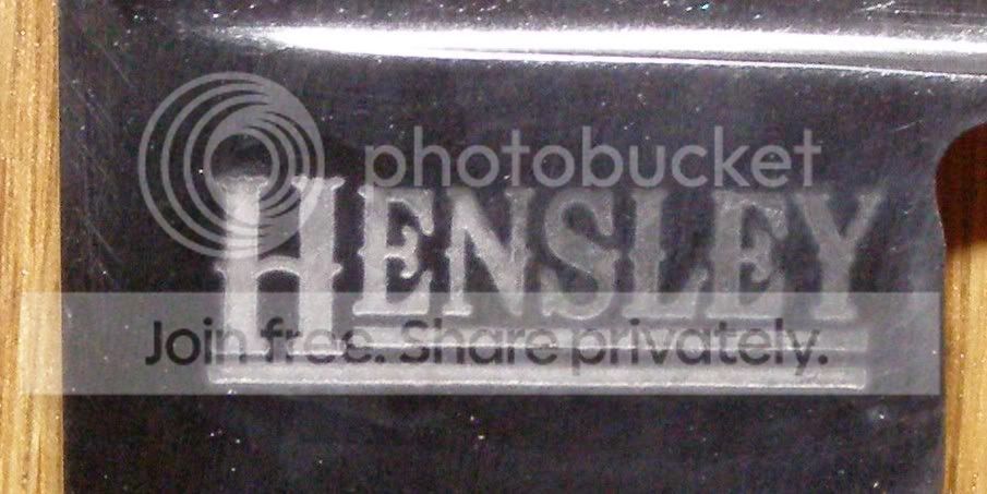

Good Idea but you need a AC power output to get the dark etch. I dont used the DC at all. I did build mine from radio shack parts and its works great. I am getting the best mark I have ever got. You could see if you could bypass the bridge rectifier for a ac output on that unit.

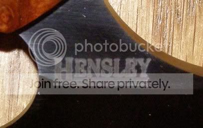

I like your mark, I have to spend some time to work on the deep. Mine get fuzzy on the edge pretty quickly but did work out the bugs in the dark etch. Seems like this machine could be used for the deep etch.
I used a DC current to night on these two knives the image is blurry from the photo the etch came out great so I am going to try the DC Converter and order the other parts online.
here is the etch i did with the DC.
