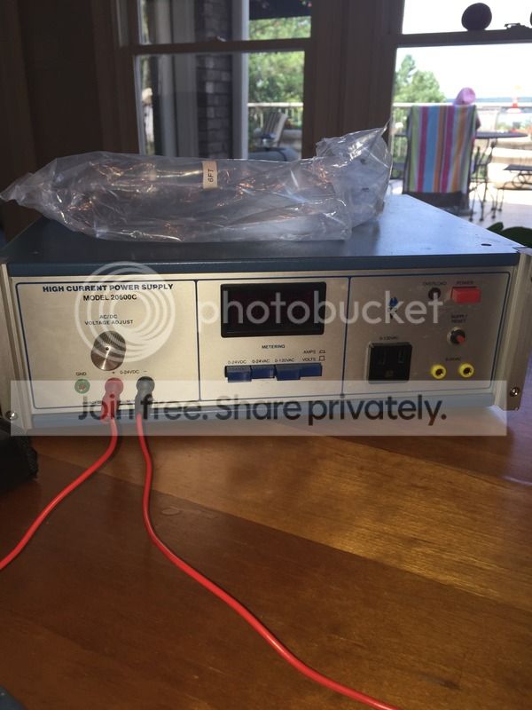

I ordered some new stencils from Marking Methods, and I am starting to get going with them, I still don't know if my power supply is OK or not. Here is a pic of it:
One issue I need advice on is that when I am making a mark, even though I am careful masking off the blade--there is some etching going on where the electrolyte gets under the stencil itself--I don't know how this is happening--when I put my marking pad against the blade/stencil it turns black pretty quickly--maybe this is an issue with my Power Supply?
When I switch my power supply to AC to try and darken the mark it makes a sizzling noise almost instantly, and I am afraid to leave it on the stencil any longer, but suffice it to say I am not getting a dark mark at all. My mark is being etched into the metal very well, I'm just not getting any darkening of the mark. One quick aside, the power supply I have has a light on it labeled 'overload' and it has always been on since I got the unit, even if I push the reset button it has the overload light stays on--have no idea why, or what it might mean even???

Sounds like the pad is to wet and etchant is flowing under the stencil. Dab it on a paper towel before applying it to the stencil. Why are you switching to AC to darken? You want to reverse the polarity and leave it on DC at a lower voltage for etch and mark and you should get a clean crisp dark mark.

If you're burning stencils the voltage is to high. To get the etch depth I like I am at about 9-12 volts for about 1- 1 1/2 minutes and about 20-30 seconds reverse polarity to darken the mark.

Etch on D.C., mark on A.C. Looking at your power supply, I see that the button on the far right, under the display, is pushed in. This is a constant current setting which you do not want. This button should be out so that the supply is regulating voltage and not current. For etching set the supply to 12V D.C. For marking, unplug from the D.C. output and plug into the A.C. output (the yellow jacks) on the lower right corner of the supply. Set the supply for 12V A.C. 12V is a good starting point and you may want to adjust a volt or two different depending upon your setup. Also, it looks like if you're plugged into the D.C. output, you need to select the 0-24VDC switch, and if you're plugged into the yellow A.C. jacks you need to select the 0-24VAC switch.
Hey Tony, thanks very much--I didn't know if my pic of the power supply was good enough, I really appreciate you taking a hard look at it and giving me the correct approach--appreciate it a lot. I haven't been sure at all as to what the proper approach should be. I'll try it exactly as you describe tomorrow, and I'll give some feedback as to how I do. I may come back with a couple links to other supplies I have located and see if you think one of them would be more appropriate.
