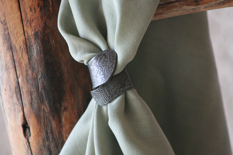

Your guard needs to be hardened for decent contrast. Years ago I'd make quite a few of these slides for wildrags out of my scrap and learned that the hard way. Hardened, good contrast, unhardened nada.

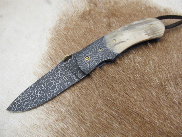

I use Ferric Chloride mixed at 1 part FC to 2 parts with our well water. Etch in this solution for 1/2 hour, rinse with water, dry with paper towel, hit with 2,000 grit sandpaper and then re etch. Then rinse, dry and sandpaper again, soak with windex (with ammonia) let sit for a few minutes, wipe dry and oil. I haven't ever played withe the coffee, or boiling or any of that as I haven't found the need. Thats for a knife blade. For the slides above and the knife below I wouldn't oil. I'd give em a couple light coats of Deft spray Clear Wood Finish (satin). Thought I'd give er a try on the slides as they are sometimes used on light colored silk and I didn't want the oxides transferring off. When I started making these small all damascus knives I thought i'd give the same treatment a try. Worked like a champ. Knife below is my own personal EDC with 3.5 plus years of daily carry on it. If I'm not using it its in its leather sheath on my belt. It has been used hard as we run a small cattle ranch too as well as all the jobs a knife sees in the shop.
Interestingly because of the clear coat I've never oiled this knife. Use it and wipe it dry if wet, thats it. Have not noticed any fading in the contrast nor any peeling off of the clear coat. On my regular knives with handles I don't do the clear coat and often wonder if I'm missing something. This one, my ranching partner's knife, I did with the same etching treatment but no clear coat, just oil.

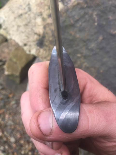

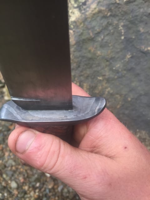

I have head people talk about how unhardened damascus doesn't etch well, but I have never experienced that. This is a bad picture, but the blade is hardened and the guard and buttcap are not. Unfortunately, I don't have pictures of the front and rear of the guard or the buttcap head on, but you can see what I mean.

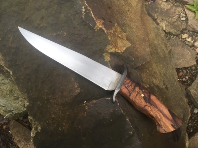

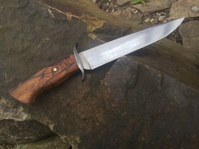

Well, here it is. Since there is no local source for ferric chloride, I used boiling lemon juice after hardening. Looks like I've got a lot to learn yet. It looked ok, but I can't get the 1084 as dark as I wanted before the 15N20 starts to darken. I guess I need to figure out how to get some ferric chloride before trying it again. Thanks for the help guys.
You have to harden and temper it, it won't etch right without. FC/WV is the best solution I have found, Muriatic works as well.
Yes, before hardening, I couldn't get even half the contrast as I have now. After hardening and tempering, this was the best I could get. Any ideas what went wrong?
