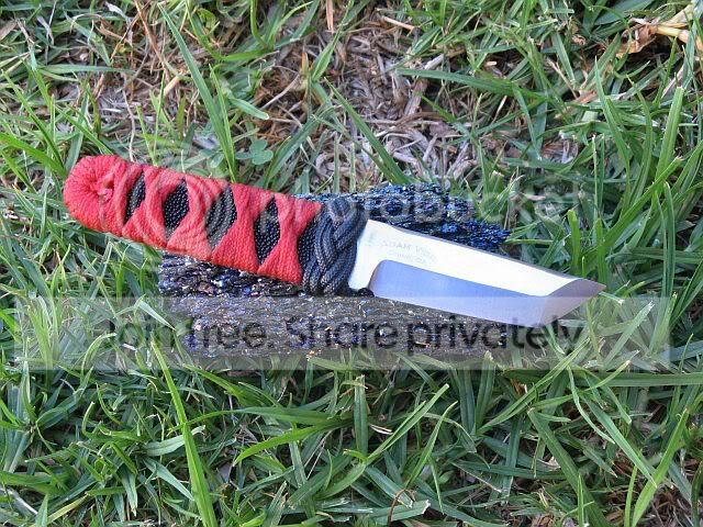

I have etched several blades with no problem. I etch the logo on a new blade and got a unwanted mark on the blade.
I tried not to use to much etchant, but is that what cause the mark? I rubbed it down with 0000 steel wool and it is a bit better but is there a better way to remove it?
Sorry for the pict but the lighting was not cooperating
The logo is only etched. I did not darken it.
I use more etchant than less. I have similar happen when I try to stretch my stencil too far; small cracks in the stencil caused it in my case.
I think that is it David.
Thanks, looking at my stencil it looks a little less smooth. Washed it with some windex and it became apparent quickly it was past its usefulness.

I was able to clean off the the unwanted mark with a green scotch brite pad. I had tumble the blade with ceramic medium but the scotch brite was able to get it off without changing the finish much. :)
I've used 4,000 grit polishing paper to clean up stray marks but it didn't work so good on some finishes. Good to know about the Scotchbrite. Snowed like heck Fri and Sat up here.
