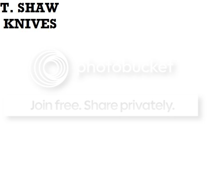

i just want something like this, does anyone on here make them or know anyone who will do them reasonably?
i want it about 3/4" x 1/2" maybe 5/8" by 3/8"...
something like this:
