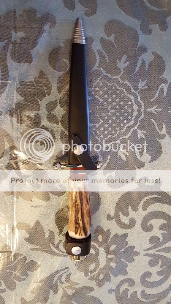

I have a few knives from Europe from the brands Aitor, Joker, Puma, Linder, Fox, etc. These brands are from different countries but it seems they use 440A across the board. Linder even uses 420 for some of their premium pieces. I was wondering if anyone knew the reason why? Is it because it is inexpensive or is it because it works well for them?
This is what I got from Linder today. Pretty nice!
It's hardly "across the board". Knives from Europe use a wide diversity of steels; the Sandvik offerings are frequently encountered, for example, as are others.
