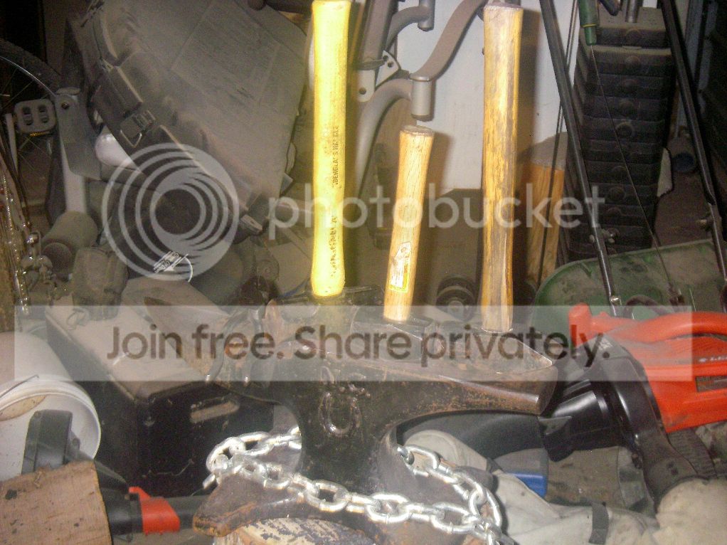

I finally got an anvil around Christmas and I've been playing around with it off and on since then. It is a 75 pound NC Tool Big Face Anvil. I like beating on hot steel so it's time to upgrade my current forging tools, specifically hammers and tongs.
This is my current set-up: a 4lb engineers hammer (from work), a 2.5 lb drilling hammer from HF, and a 3lb cross pein from HB. The "tongs" are a pair of HF linesman pliers that i ground a little off each jaw so they'd grip a piece of flat bar better. The drilling hammer with it's short handle seems to work the best for me right now.
I don't see myself forging any massive blades, at least not until I get a bigger anvil. At some point, I would like to try an integral but my skills are nowhere near ready for that yet. My hammer/tong budget is $150. How should i spend it?

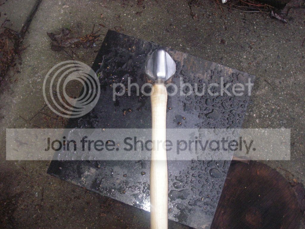

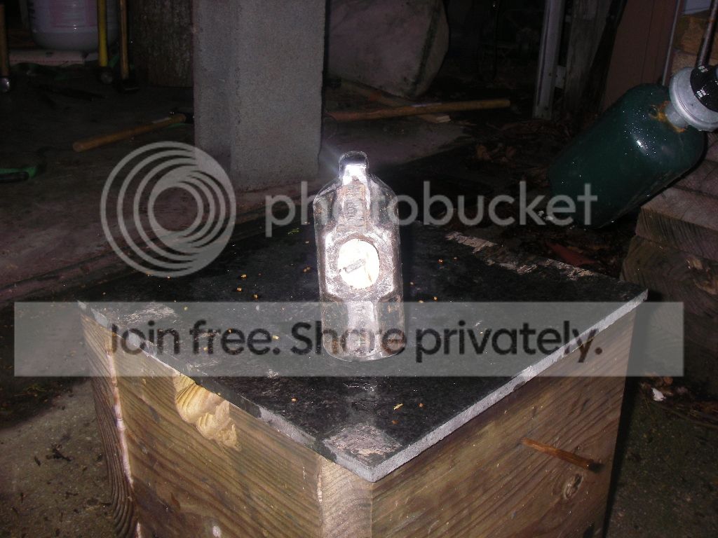

I'm too old and too un-cool to ever be called "dude" :) I found an engineer hammer head (no handle) in a junk box at work yesterday. Like Raymond said, I couldn't pass that up. 45 minutes with a cutoff wheel, a new handle and I turned it into a straight peen:
Stacy posted a few weeks ago about making a bottom fuller out of 1" round stock by upsetting the end to fit the hardie hole, then bending it flat over the anvil face. Attempt #1 was a lesson in how NOT to do it, but Attempt #2 is looking better. I should finish it tomorrow after i get a fresh propane tank.
I do have prior experience swinging a hammer. I worked on survey crews for 15 years setting R/W monuments with 36" rebars and a 4 pound hammer. If you can't drive them straight, it makes for a LONG day. It's not teh same thing but that muscle memory can't hurt. Right now I can be at the forge for about 2 hours and then take a break. My arm isn't sore, just time for a break.
