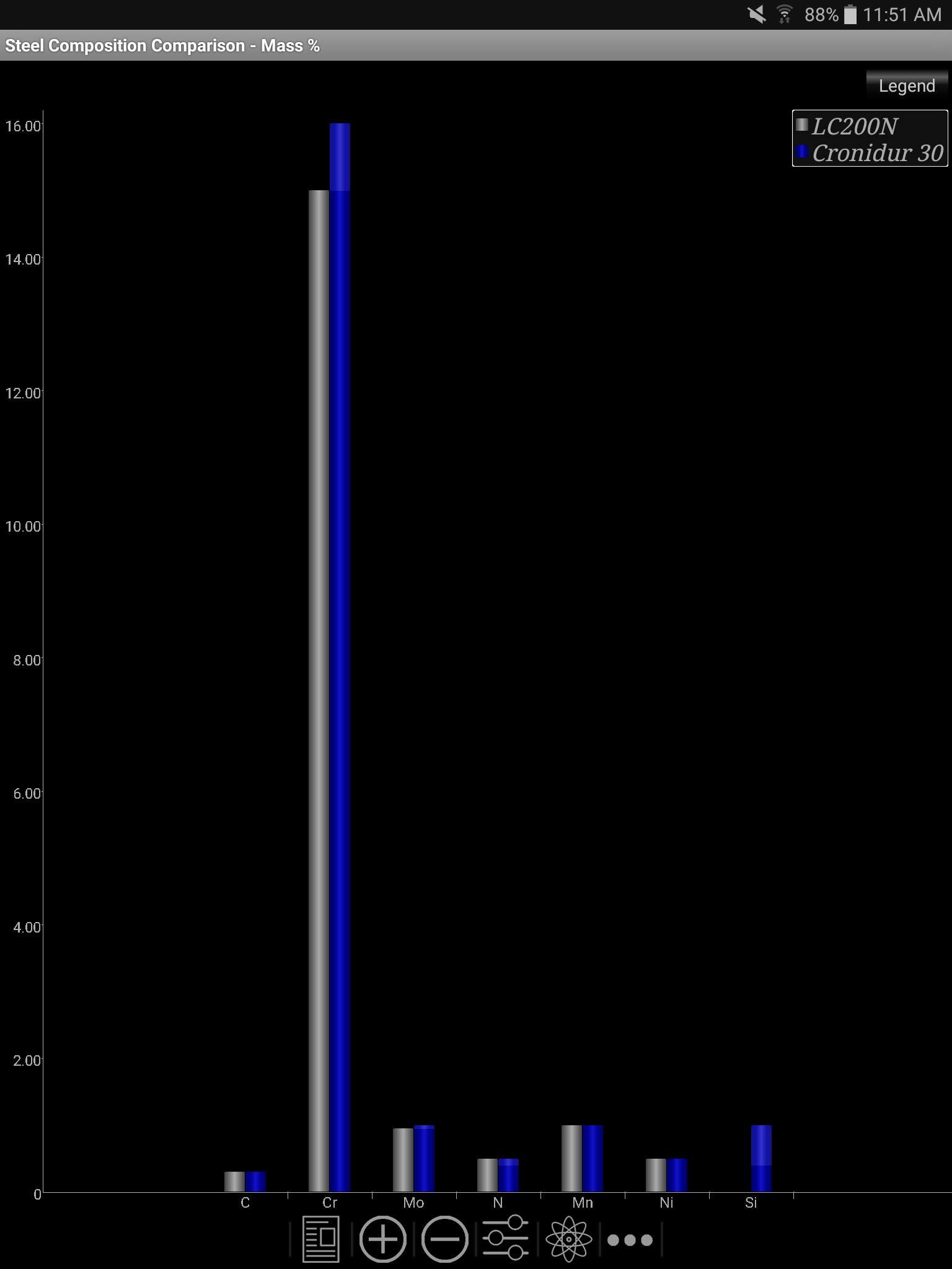

Basically the same thing as Cronidur 30, made by Zapp.
