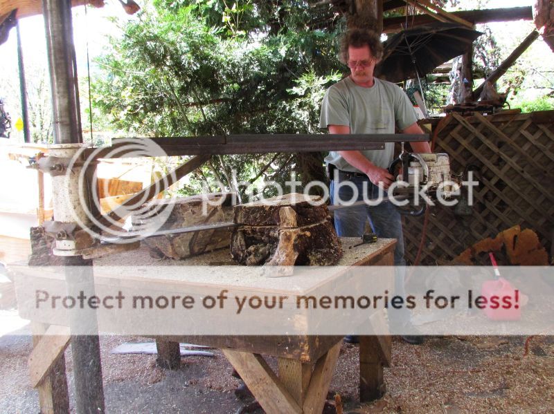

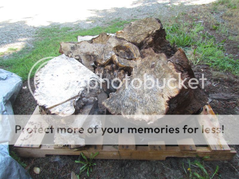

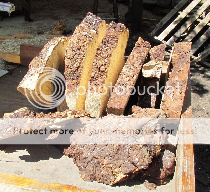

This piece is about double the size of the chunk I used for the cornmeal batch.
So I had one of the guys cut it into slabs on the pole mill.

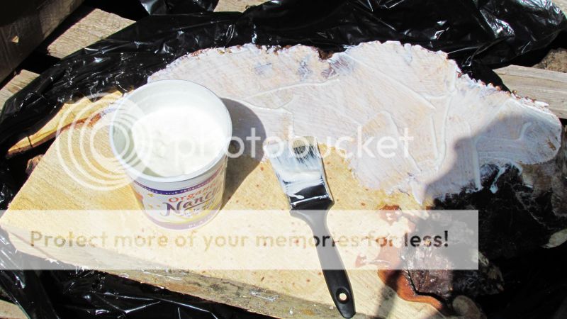

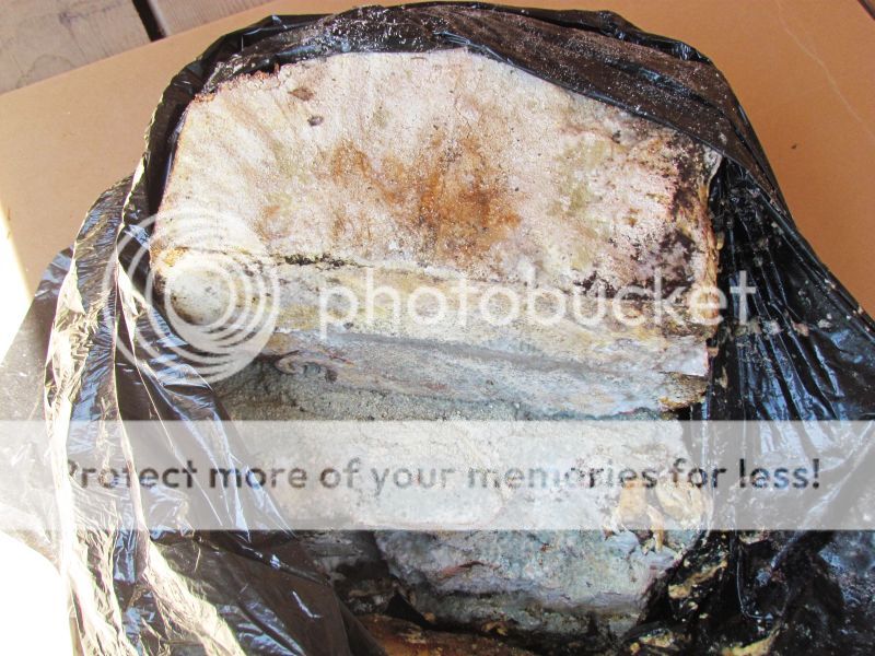

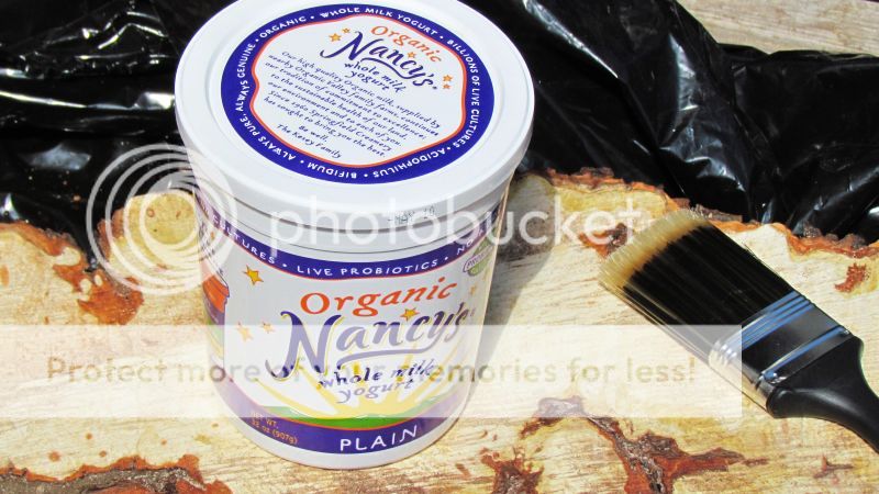

Now for the yogurt.
I used a paint brush and painted on a thick coat of yogurt on both sides of the slabs.

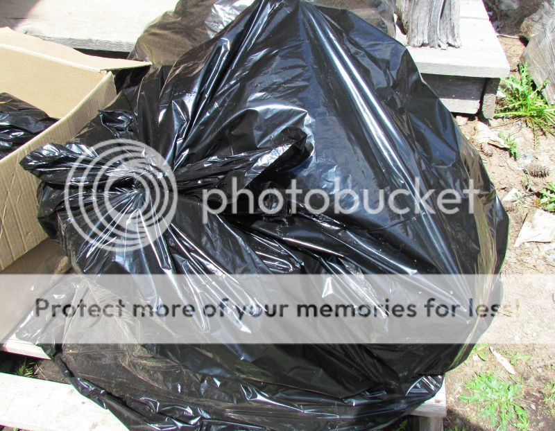

I stacked the slabs face to face inside a couple black plastic bags.
Now I placed the bags in a spot where they will have exposure to sunlight for most of the day.

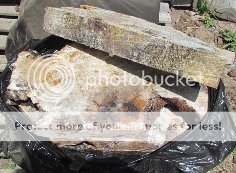

And it smells disgusting!

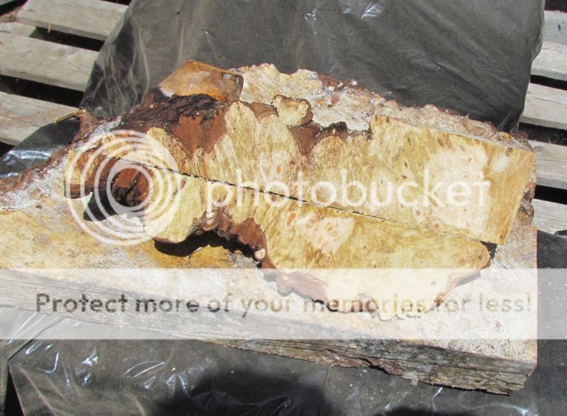

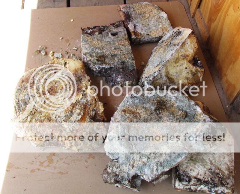

This is the corn meal batch.
Next I will scrape off the gunk and cut a piece to see what is inside.
When I cut a piece of the corn meal batch, not encouraging.
No new color inside.

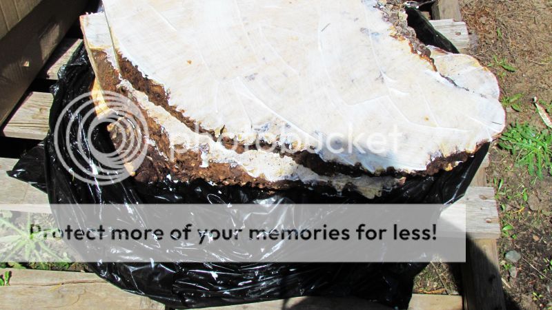

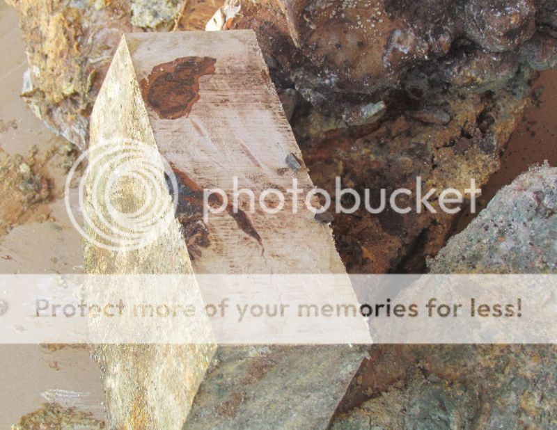

Next I opened the yoghurt batch.
It was growing as well but did not have the bad smell like the corn meal.
When I cut it I saw some color starting to spread inside.
Looks kind of olive green right now. Who knows what it will evolve into.

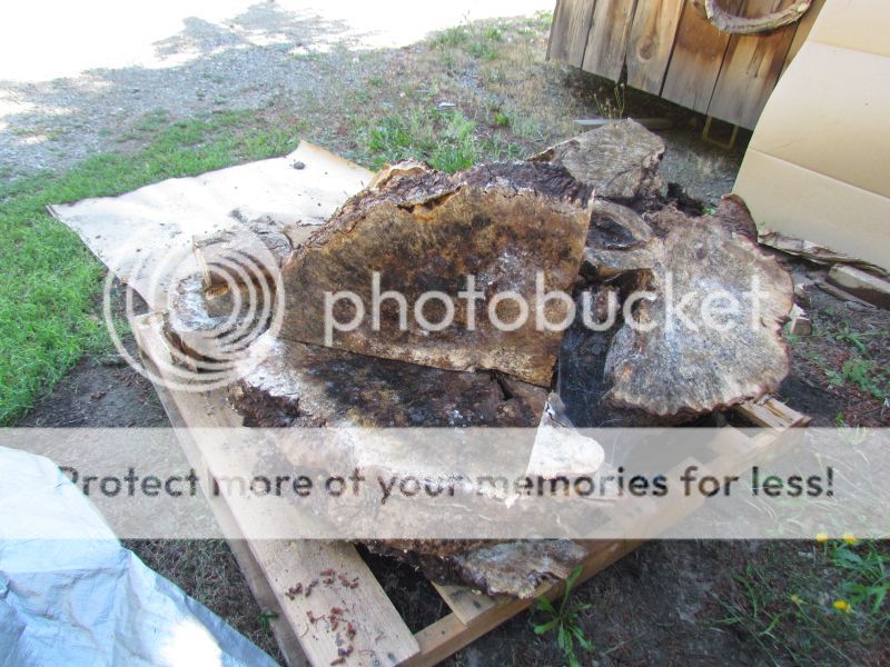

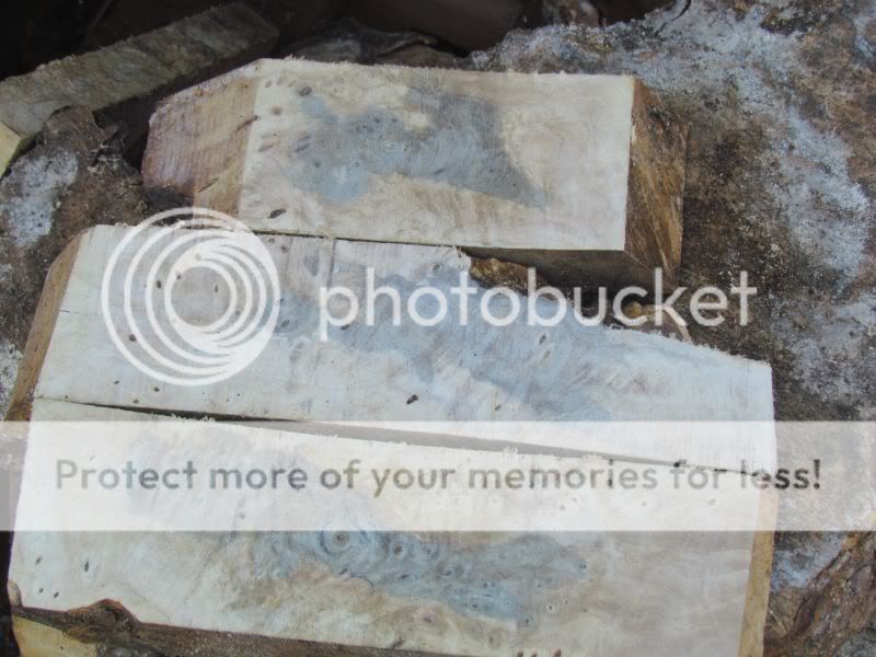

Here I pulled the tarp off the Buckeye to see how it is doing.
Pretty good looking on the outside.
Cut up one of the smaller pieces to see what is inside. Finally some blue!
Now I am covering it back up for another month or so. That way the blue can spread and get darker.

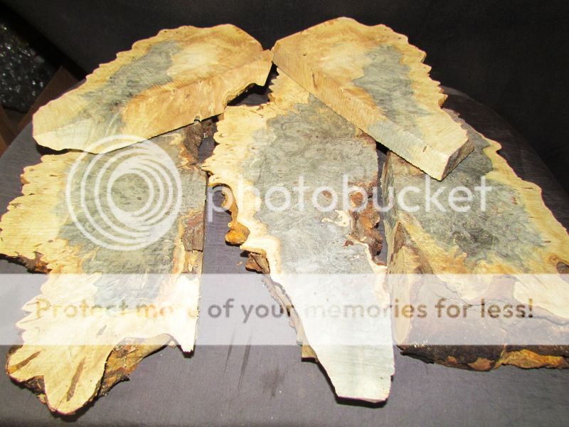

Looking pretty blue now.
Time to start cutting blocks so I can dry them and get them stabilized.
