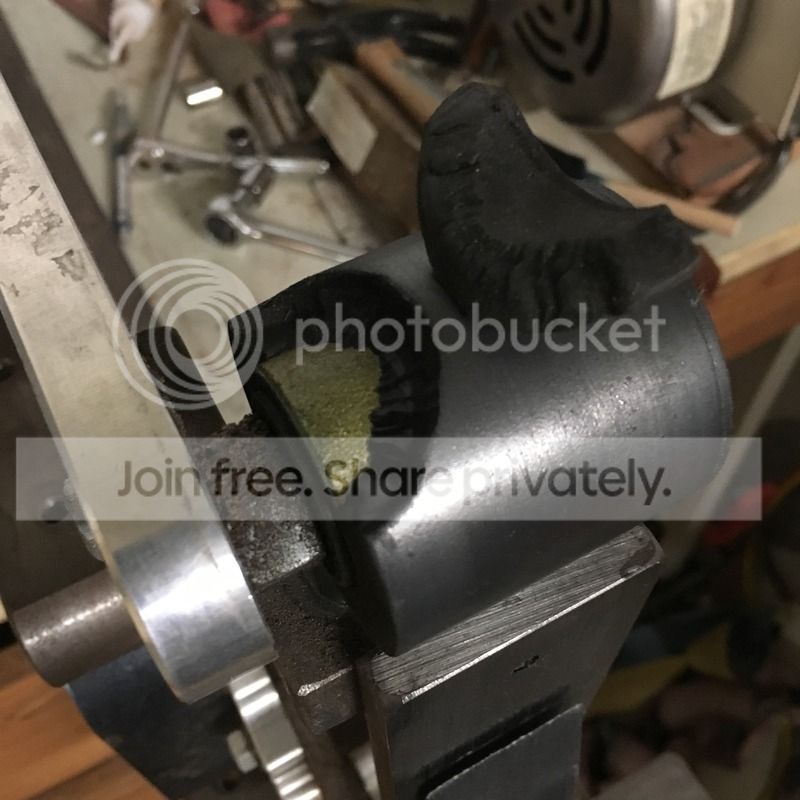

After a several year break, I've recently gotten back to messing around with knife making again. I've been using belts that have spent several summers in my garage, so have been expecting some of them to come apart during use.
That happened once yesterday, and again today. A few seconds before the one today, I heard a strange noise coming from the grinder. I stepped back, and another belt blew up...this time a contact wheel blew up with it.
Do wheels go bad over time, due to heat, use, and/or lack of use? Do exploding belts sometimes take out wheels with them? Can this be repaired, used as is, or have to be replaced?

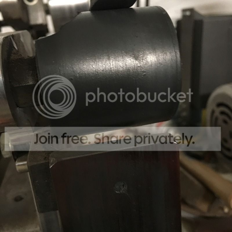

How much clearance between the top of the platen and wheel?
Looks like the belt probably got between the platen and wheel just enough to blow the wheel.
Seems like plenty...will post a pic.

The belts have been in my garage in AZ for at least 4 summers, which is brutal on most things. Surprised I haven't had more problems than I've had. No facials yet thankfully, but was rather loud and exciting when it happened.
Beaumont or contact rubber the company should be able to re cover it for you
Just replace the wheel. It is probably cheaper than replacing the rubber.
Thanks, will look into the two options.
