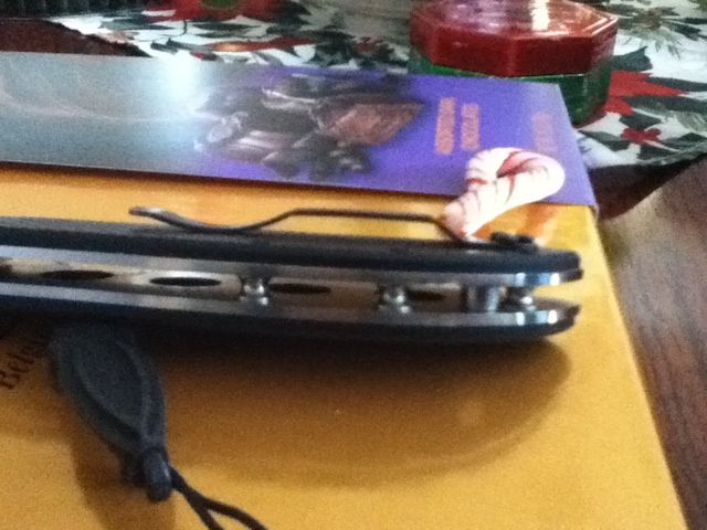

I am posting this in the Spyderco forum partly because I am all about Spyderco today due to my latest treasure trove discovery, The Gayle Bradley first generation in M4.
(I have M4 now . . . M4 I tell you ! ! ! I am still swooning when I think of it)
And mostly posted here because Spyderco developed the pocket clip from the very beginning.
Without further a due and using the latest in Elf Graphics. Candy cane pointers. Fresh candy canes no less.

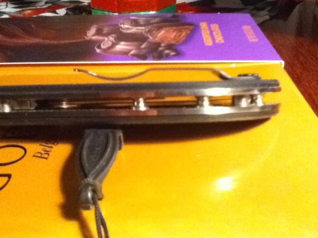

Why . . . is the opening gap of the clip, first photo, smaller than the "capture" area of the clip (see second candy cane pointer equipped photo) ?
Or maybe a better way to say it is WHY is the capture area larger than the opening's gap ?
I ask partly because to get the clip on my thicker pants I need to pry this clip up with my finger tip . . . so the opening of the clip is . . . in use . . . too small to be used with ANY pants pocket that would """"need"""" the large capture area.
One possibility that came to mind and you all can tell me if ANYONE uses this carry option : The capture area is as large as it is so it will accept a belt threaded through it.

Hi Wowbanger,
I can't explain as to why the opening gap is less than the gap for the capture area. If it bothers you, try replacing it with another clip. I just checked and the clips on the PM2 have the same gaps for the capture area and the opening area. This should solve your issue if you are having issues with pocketing your knife. Spyderco sells replacement clips. Hope this helps.
JonesE
That does look lower than normal. Just take it off and carefully bend it up. You'll probably have to bend right at the part where the screws are after that to lower the whole thing back down too, so it's not loose.
JonesE,
Nah . . . I love this clip. And from the reviews the finish is very robust.
Just curious.
I might tweak the tip up a little so it angles away from the knife but I understand why it is parallel to the side as it is.
The reason the Benchmade clip which is simmilar but easier to get off has to do with the tension of the pocket clip. The first part of the clip where the seam of your pocket first goes through before being caught in the In the main part; it is smaller so that way it is less likely to get caught on things and pull the knife out your pocket.
BTW, just bend that first lip up that way you won't warp the part of the clip by the screws. If the clip was clipped to your pants this first lip would be the bottom part of the clip closest to the ground.

I carried the GB1 today for the first time at work. Clipped to normal weight, indoor pants (not those thick sweat pants). Turns out the clip was too tight for those. I had to two hand it all day to keep the top of my pocket from rolling / folding over during a one hand effort.
I just came up from my home work shop; I took the clip off and I unbent the clip some and tipped the tip out a little. Goes on the thick pants fine now.

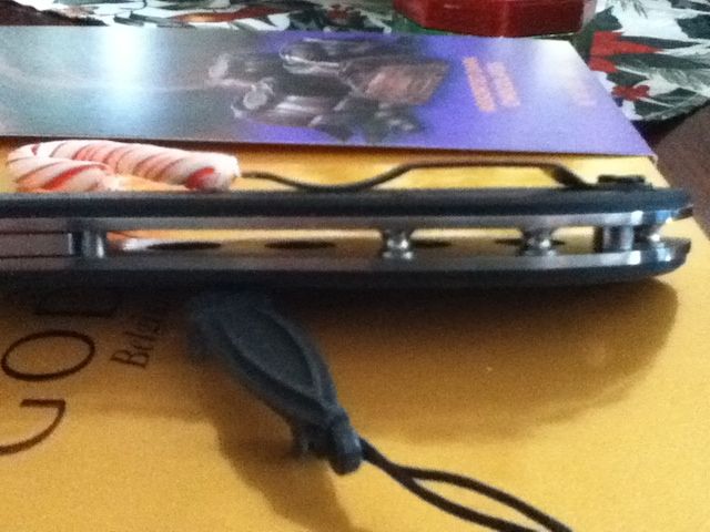

Two things I learned I thought I should pass on :
1. The clip is easy to bend and it is easy to over do it. Compared to what ? you ask. Compared to my Spyderco Tasman Salt which has a clip on it that could substitute for dually truck springs though not super ridged that spring is nearly unchangeable. Here is a photo . . . if I had done that with the GB it would have stayed about that far from the knife when I took that "wedge" out. Not the Tasman; it went right back where it had been / unchanged.
2. The screws on the GB seem to be a tweak short for their task / be careful . . . it might be possible to strip the threads easier than you are used to because there doesn't seem to be a full liner thickness of engagement. I didn't damage one, knock on wood, but I was paying attention.
This gap looks like a bunch. Perhaps it is too much. Works super well for the thick pants / will see how it is on the thinner pants tomorrow at work.
That gap is the same as seven sheets of printer paper or 0.65 mm (measured with a dial caliper tight down on the stack of paper I used to measure the gap).
I over did it twice and wound up back to zero twice plus some in-between not-quites. I tuned it until it felt just right on the pocket.
